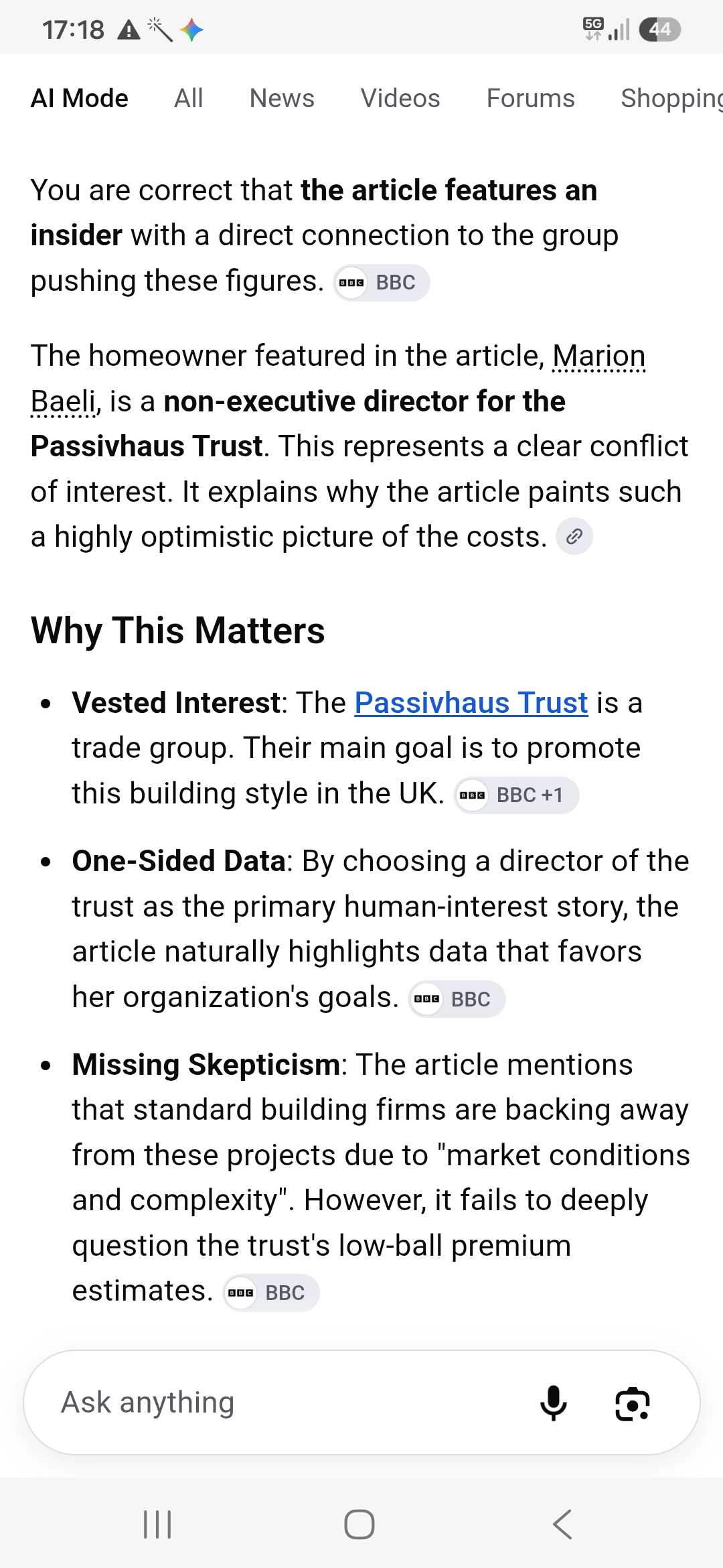

Seems that institution is a trade body. Its basically propaganda that article.

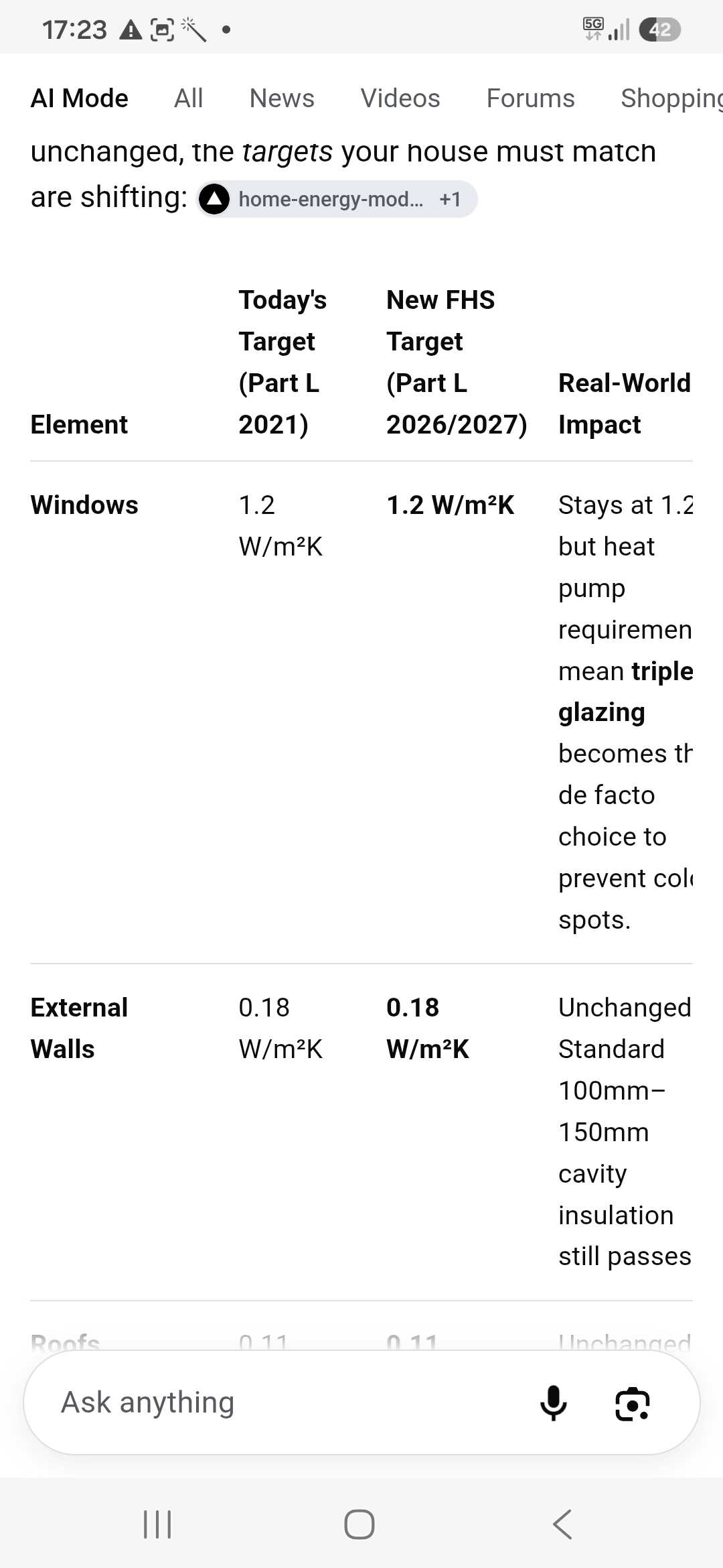

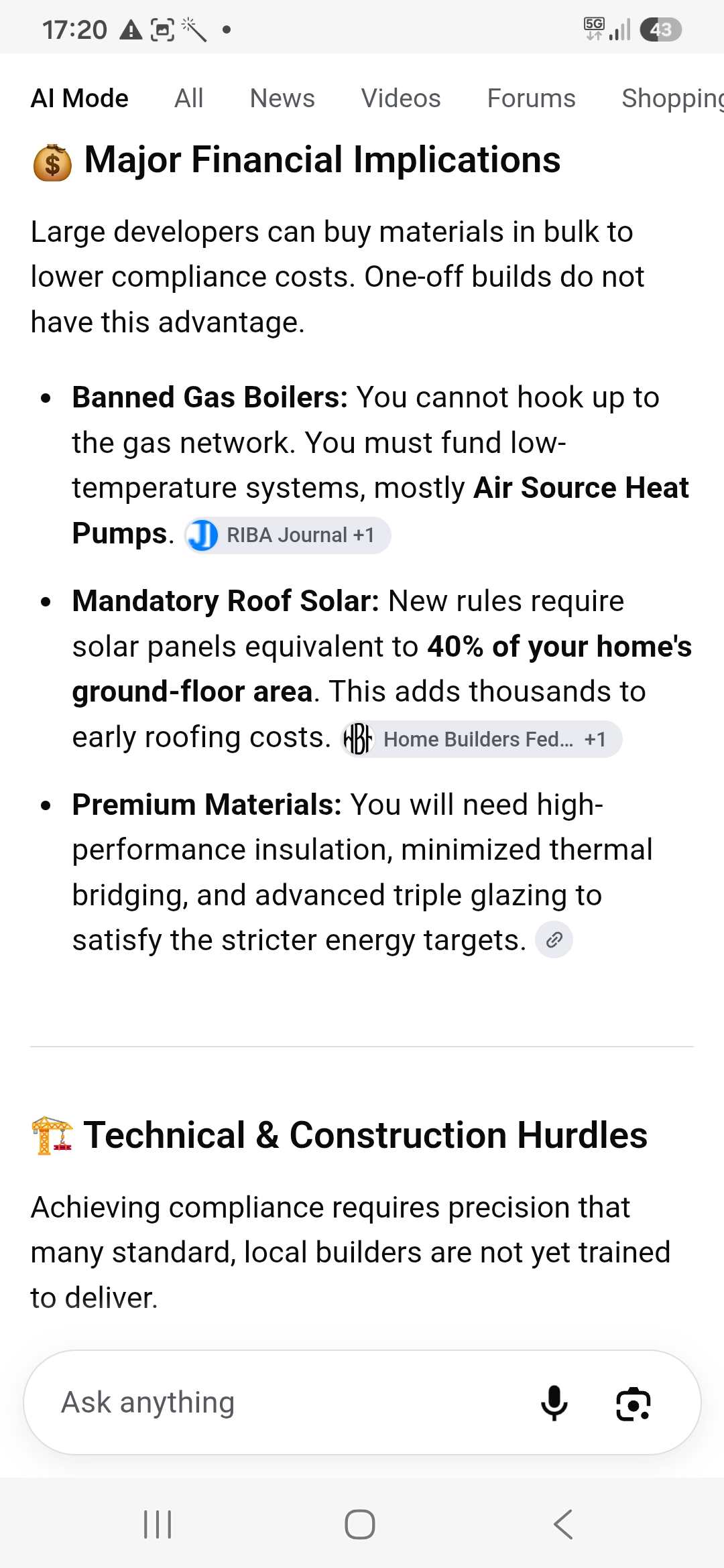

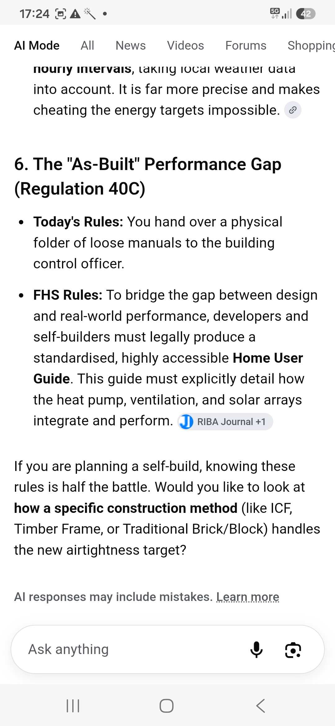

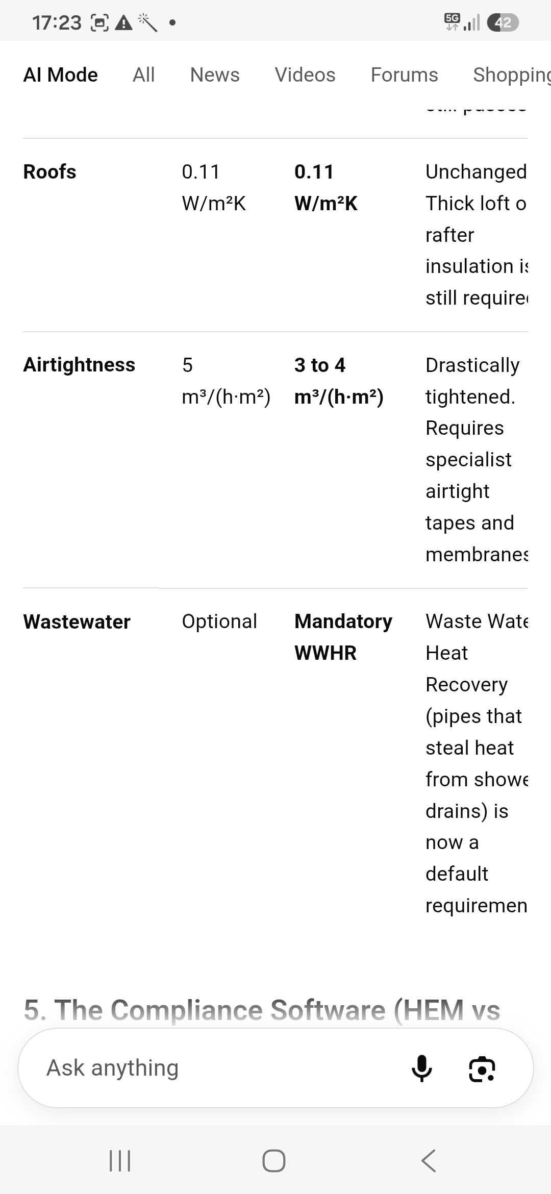

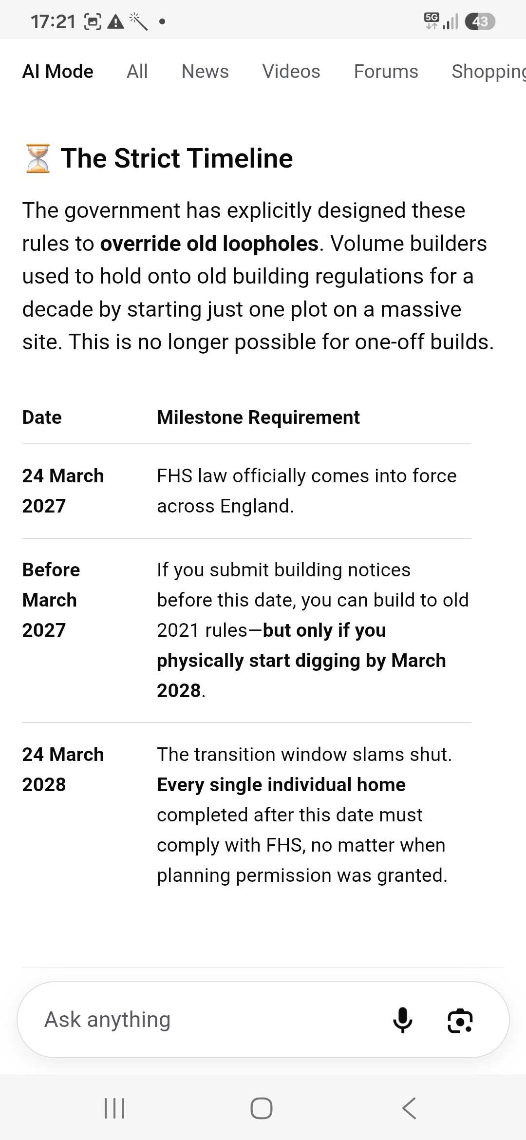

Interestingly the changes don't seem too extreme to me. U value targets are similar. Airtightness is ok don't think I've ever been over 3. It does appear to be more aggro so hopefully I can get planning and b regs sorted before March.
Wonder how these changes will effect the housebuilding targets.
