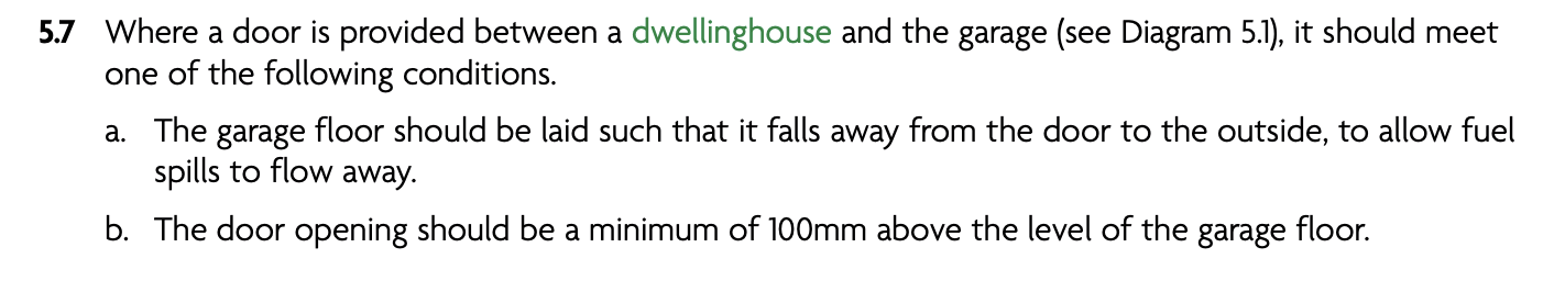

The garage door is a great example earlier in this thread. It looks like the architect/designer didn't consider this at the outset, and possibly made the fire *and* airtightness barrier/boundary the same, causing the requirement for an airtight and thermally efficient fire door, which was very costly. Separating those elements (fire/airtight) at the design stage may have resulted in signficantly less cost. It may not have been possible given site or design constraints, but just one example.
