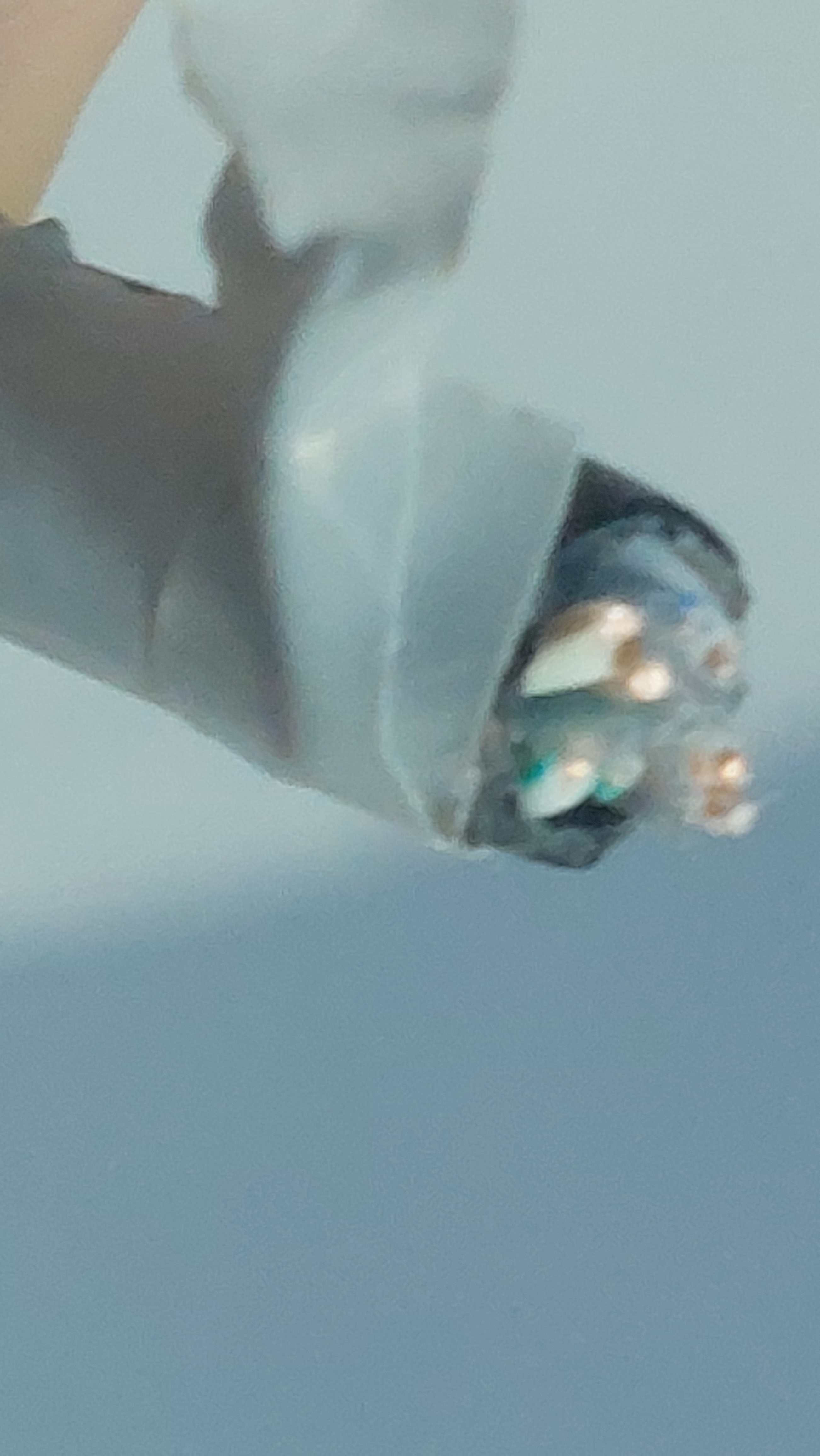

Starlink loose end on wire.
For whatever reason, the terminal has been cut off the starlink mast, or extended with a wire.
So we just have this bare cable.
Any advice on how to fix a usb plug on it?
I can try harder on focus if necessary.

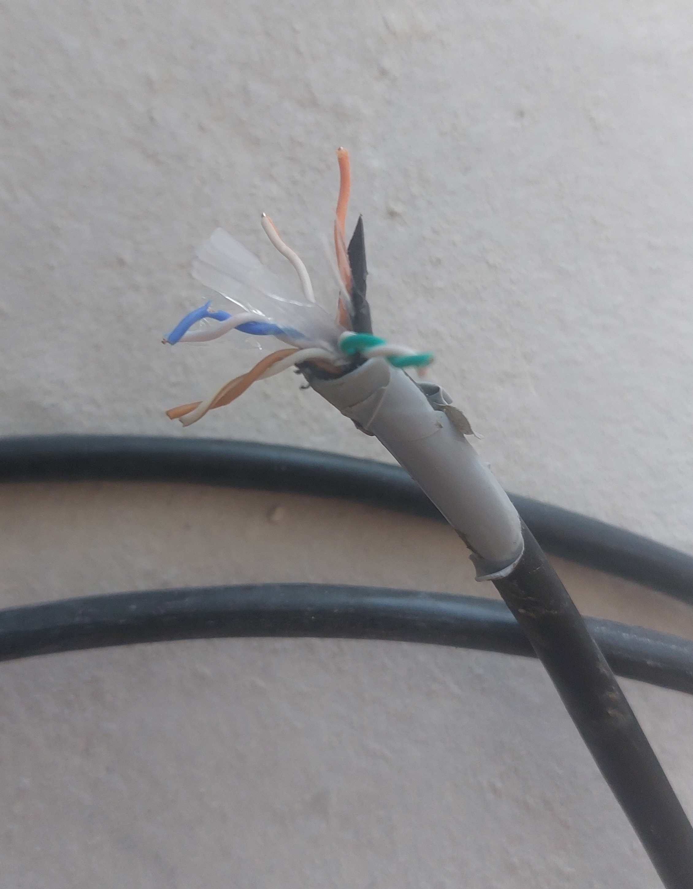

Can you strip that cable back a bit so we can see the cores properly?
From the little I can see that does not look to be the standard colours for a cat 5/6 cable.  If it is a non standard termination I hope you still have the plug that was cut off to see how it was terminated.
Internal structure of Cat6 Starlink cable
So not a standard cable.  So you need to work out what colour goes where.
Do you have access to the good end of the cable, you could work it out from there with a bit of testing, or keep searching and see if someone has already worked it out and published it.

If you are only repairing a break you only need to match the colours on both sides. The only real condition is to keep the each twisted pair near each other to maintain signal integrity.

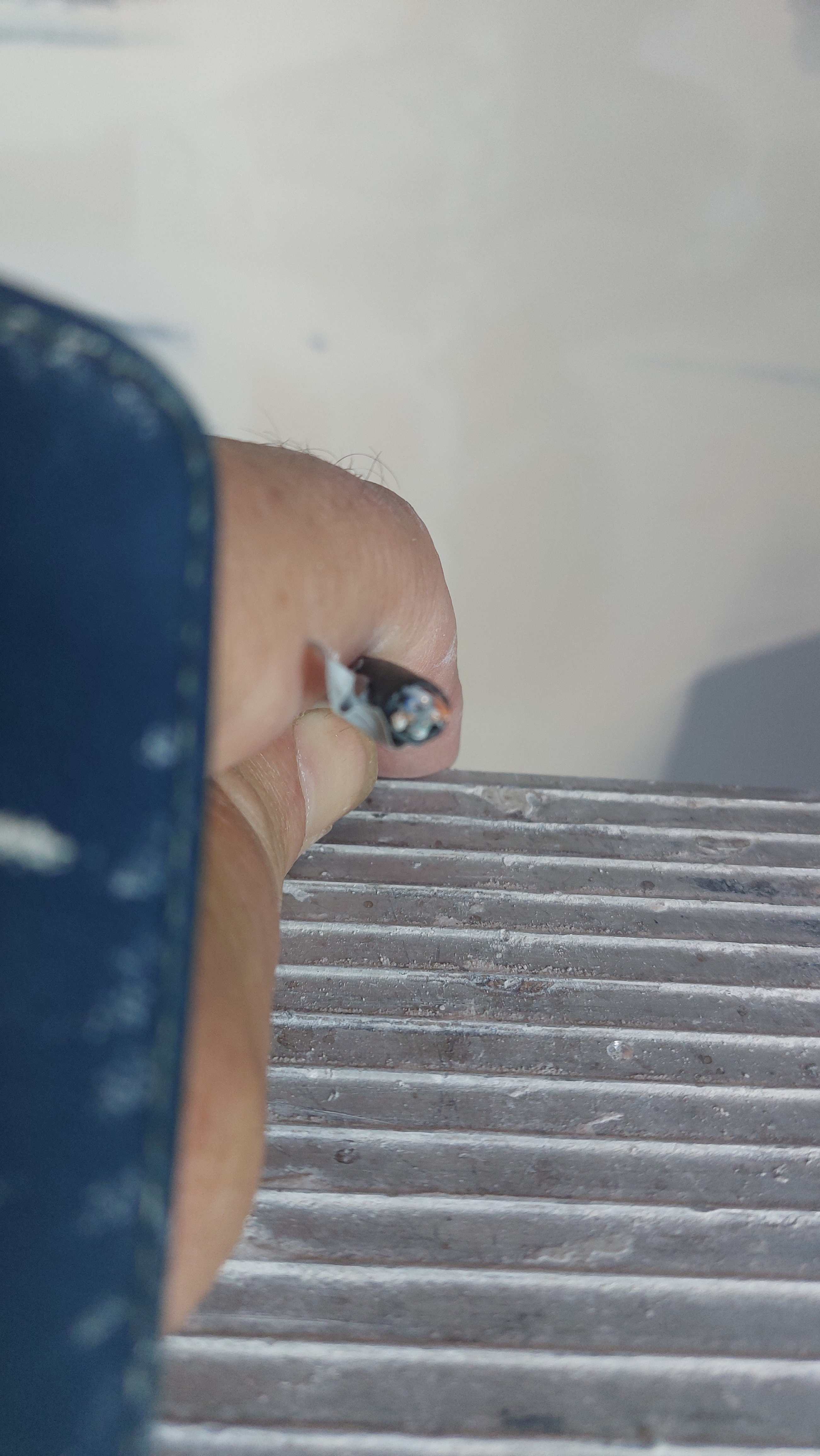

I've exposed the wires, and damaged one, thus demonstrating that a stanley knife is to be avoided.
Amazon do a kit of a multitool (strip and crimp) plus some pass through terminals, For £22 so that may be the way forward. There's plenty of cable so if I fail then a proper person can still do it. We've lots of similar cables fof doing fancy things i'm not much involved in so someone will do it.20260801_140148.thumb.jpg.8a5583101e39bbabf6a8e23b0285c177.jpg20260801_141520.thumb.jpg.fb27e97d953301df0dce689eea897145.jpg

Gen 2 Starlink is their own proprietary plug. Gen 3 is basically an RJ45.

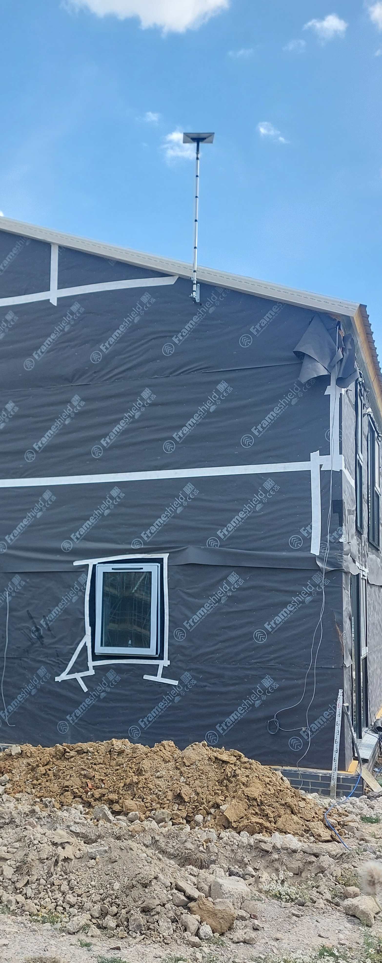

Just come off of my flat roof with my lad final fitting the new Gen 3 dish.
cat6 with the separator in the middle I think. Not that it matters.

P.S. What is the house being clad with?  the aerial bracket seems to have been fitted before the cladding?  Are you really going to clad around that?
No we will have the cladder remove and refix it.
Fyi the cladding is composite pir  double skin on timber battens. Then behind there is the timber structure you see there.

The issue is the height. That's 6m so needs a cherry picker. What's that £350? We will have one there but not fir a few weeks and I'd like good wifi on site and the camera working.
As long as an attempt at a plug doesn't do any harm I'd like to go for it.
If that's no good then we need a new cable and to fit it when the mast goes back on.
What I haven't said so far is that we will also move the mast 3m to the left, as there is an office there. Where it is was to suit the scaffolding at the time.

In general ethernet is 'safe' even if miswired. I hesitate a little as in the case of Starlink they transmit power over the cable as well. If this is done in a standard way then no issue, if non-standard then potential issue. (I think Starlink is fairly standard but have not checked and wouldn't want to take the chance without being confident)
So to be safe the best thing to do is to find a guide on how to terminate the cable specifically tailored to the exact model Starlink antenna you have.

There are two incompatible standards for wiring the connectors. As long as both ends match it works, but if you mismatch and there is a non-standard power setup on the cable you might be in trouble. (it's safe if there's no power feed or if its POE standard)
