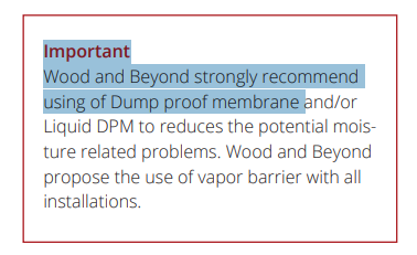

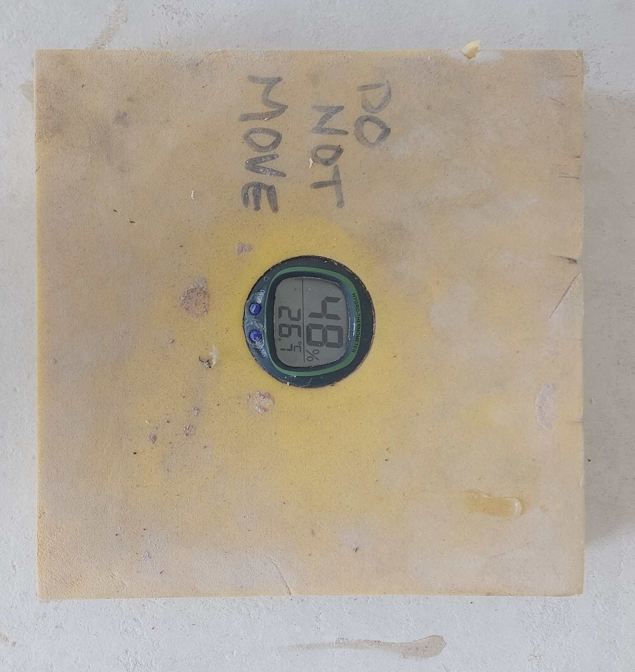

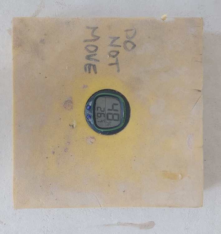

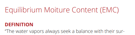

August 4Aug 4 Author So we found a moisture meter and set it up. currently saying 53%. I just know it can't be any drier than it is now, but it will be interesting to observe any changes with time or temperature. AI says 50% max for flooring on anhydrite. Other sites give very different numbers. But I came across this erudite site. Perhaps in the toilets. I'd take their site even more seriously if the page headline didn't use the word Moiture. Rhymes with voiture?
August 4Aug 4 Author 2 hours ago, Mr Punter said: What is the contractor's maximum allowable moisture? I'm going to look for the screed manufacturer's info on this. I noticed that they had about 8 products and they will all have different absorption properties. We are currently measuring the air humidity in the enclosed space of the testing box. That must be an approximation. A probe will be another approximation as the free moisture content must be linked to the amount of impermeable aggregate in it. The only real test is to take a core and heat it and measure the water evaporated off it. That isn't going to happen. The floor will be engineered timber, and the manufacturer has nothing to say on the matter. The contractor changes his requirements when challenged, as in the initial post. Wants to seal the screed or charge an abort cost, so I have no trust in them. I will be there on the day and the poor chap may have a hard time if he plays at being technical. What I don't want is them walking off because the scam hasn't worked.

August 10Aug 10 4 hours ago, saveasteading said: Today 26.7°C seems quite a high temperature, is the concrete still curing? I have some very similar T/RH units, not one pair of them read the same.
August 10Aug 10 Author 56 minutes ago, SteamyTea said: 26.7°C seems quite a high temperature, That's about the temperature today as it was over the weekend in daytime. If it was still curing I'd have to take back everything I've said about how dry it is. It is 40 to 50mm thick and has been there for months, on top of PIR. It is not a high end machine, but it is showing a number and trend. I haven't even read the instructions, so maybe it should be removed and replaced for every reading.... that was the case for the poshest one i've seen which was like a mahogany and glass carriage clock with a brass gauge inside it.
September 2Sep 2 Author On 10/08/2026 at 19:03, SteamyTea said: calibrate the RH with Explain please? Btw our gauge has now risen to 55%. It increased when the rains came, demonstrating that it is registering the atmosphere and presumably the immediate effect on the screed surface. Still below the magic 65%.
