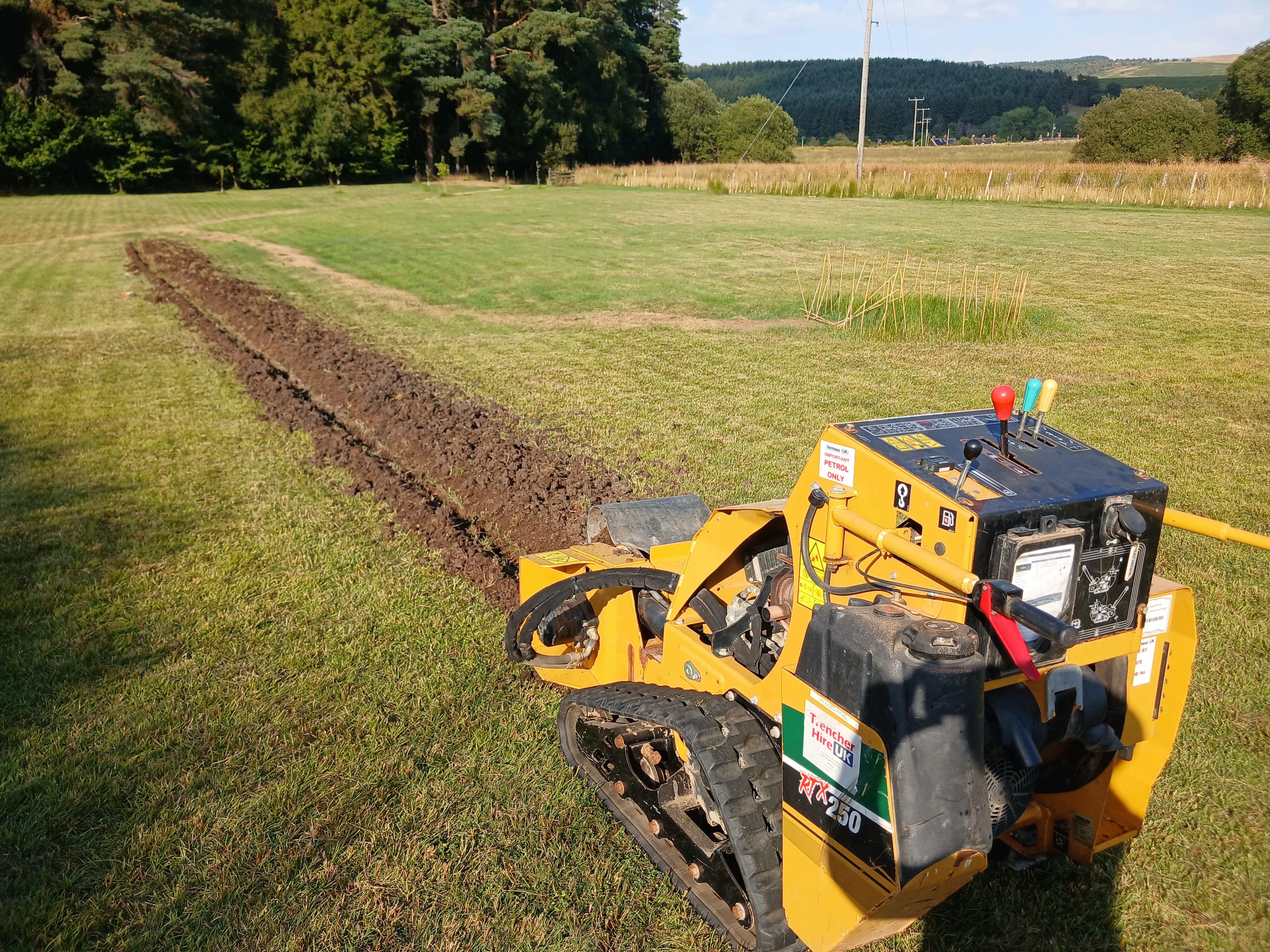

After much deliberation, going to run DC. Will add a year to payback time though :(
Cracking on
Cracking on
The proper way to dig a trench! Glad to see you moving forward. Have you got someone lined up to get the electrics hooked up and signed off?
An expensive way to dig a trench though!
I do have someone if i need them.  Ill be doing all the work though. Slowly.
Mounting the panels in a cost effective manner, than can resist serious wind, and be close to a vertical angle is my current challenge, especially after the increased costs of 100m of DC cable.
Depends on the cost of labour. Compared to 'free' labour sure. But it's a big job to dig by hand solo, especially if not a spring chicken.
Good, worth making sure you have talked through what you are doing with them. Better to find out now that they need something specific rather than after you've filled the trench in.
Well i have a digger. But not a narrow trenching bucket. Could buy one, but thats half the hire cost, plus wont be neat like this.
Discussion have been had, hence going back to a DC cable. That way i have no real limitations plus allowing for future expansion.
