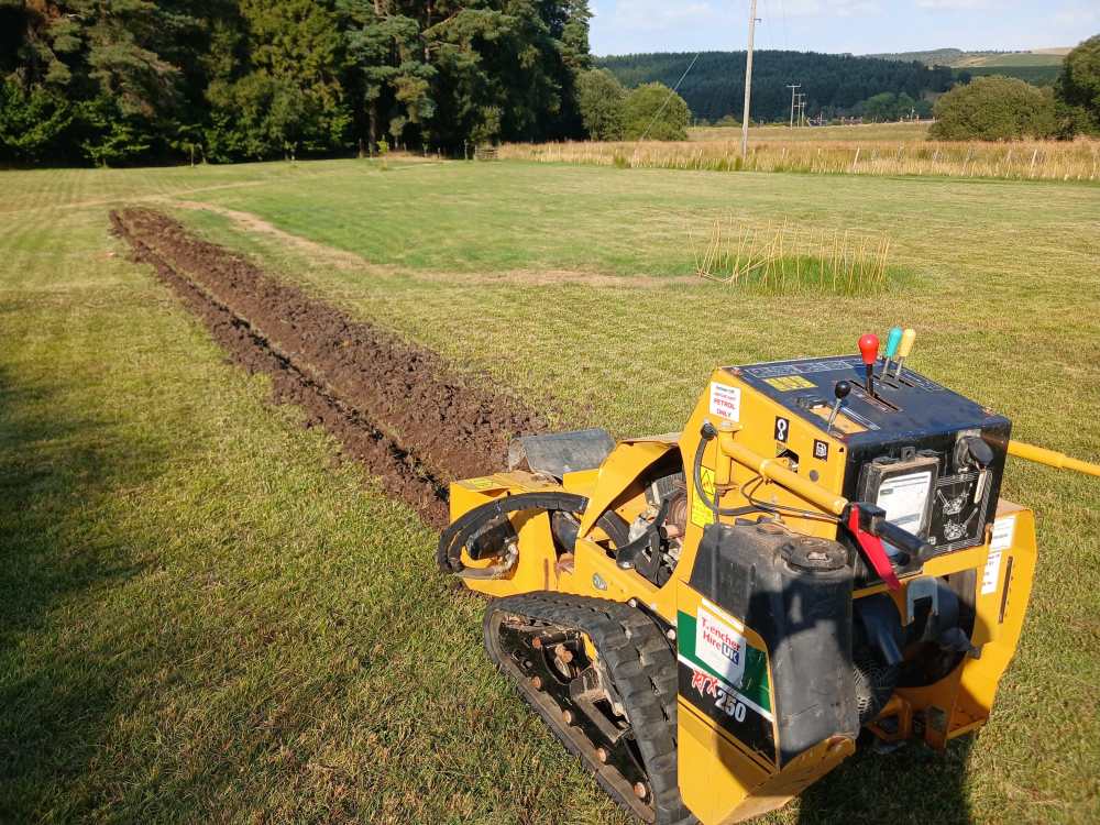

Im doing exactly what nick suggested. Mines 130m away. Trencher is booked!

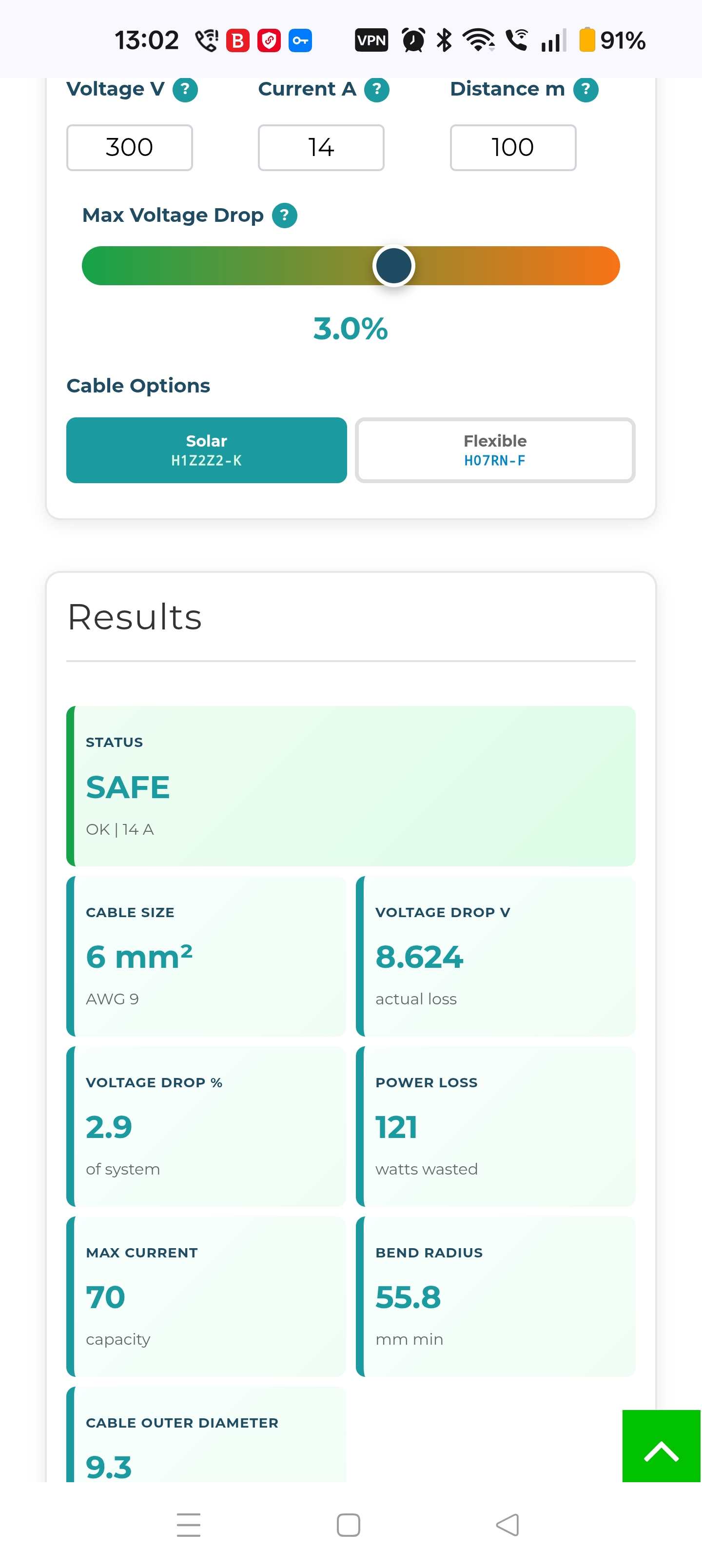

DC circuits use resistance calculations only. This makes voltage drop simple and linear: V = I × R.
Definitely do minimum of 6mm² any smaller you are wasting power. Then you are at or below 3% voltage drop and for a minor uplift in cost. Most panels these days come with 6mm² tails not sure why you would down grade them with 4mm².
Screenshot_2026-08-02-13-02-11-55_40deb401b9ffe8e1df2f1cc5ba480b12.thumb.jpg.b3351c83fa2ccaedca578b26db013c10.jpg
This is news to me, I thought 4mm was standard. Either way I agree with you, for the long run 6mm makes much more sense for the small cost uplift and it makes sense whether the tails on the panels is 6mm or 4mm as the upsize is purely for voltage drop/efficiency not load carrying capacity.
