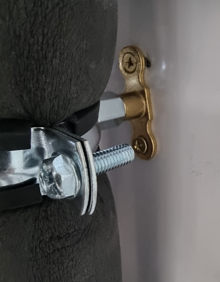

Screwing into the cyclinder
I was surprised, and rather disappointed to find our plumber had screwed into my lovely Panasonic cylinder to fix pipes.
Googling around it seems this is common practice to fix into the cylinder so I'm much calmer now.  However, the clips are all loose, suggesting the screws have not threaded onto the external skin of the tank.  I have a box or short wide self tappers on site that would probably have been far more effective but its too late now.
Any thoughts on this?
I had an idea that Panasonic used Oso cylinders, in which case it's possibly not a good idea to use any screws as Oso use vacuum insulation, and state "no penetrations".
If its foam insulation no issues, if as said a vacuum insulated one, bang goes the insulation

I can lift the screws on the top clamp with my fingernail, so its not doing much

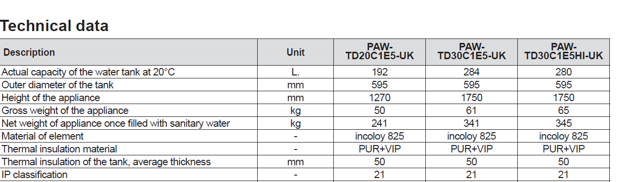

On 14/07/2026 at 10:27, JohnMo said:
If it's an A rated cylinder the vacuum insulation, any other ratings it's most likely not vacuum insulation
It is A Rated, and it looks like it does have Vacuum insulated panels and PUR.  So where inside the cylinder are the vacuum panels and who thinks they are punctured?  The tank is not yet filled or heated so I can't do a temperature test to identify heat loss around the penetrations to determine if the VIP are punctured.

Call OSO and ask?
I'd guess you are probably be ok as it makes more sense to me to put the VIP on the inside and PUR outer. But it's just a guess.
Edit: But if the manual says no penetrations then making the plumber replace makes most sense. If you want to show flexibility then check with OSO and see what they say. If they are willing to warrant based on the screw being no longer than x then ok. No good to move forward with a void warranty.
