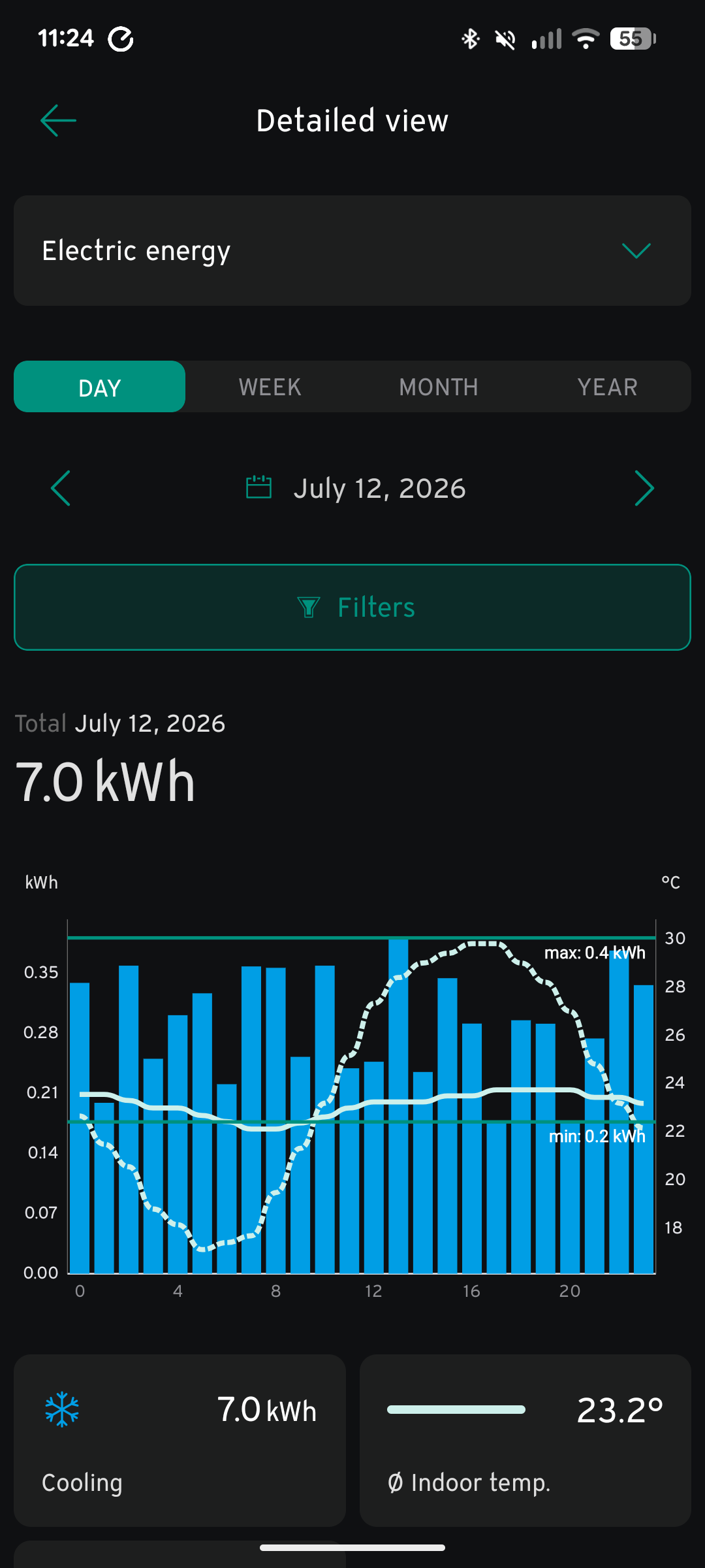

16c - no condensation since we started running (although that might be tested in high humidity)
And 7KWH of solar / battery for 24 hours of cooling which we would otherwise export at 10p / KWH (in other words it cost us 70p for 24 hours).
The solid line is the temperature of the hall thermostat - not the bedroom thermostat alas.
