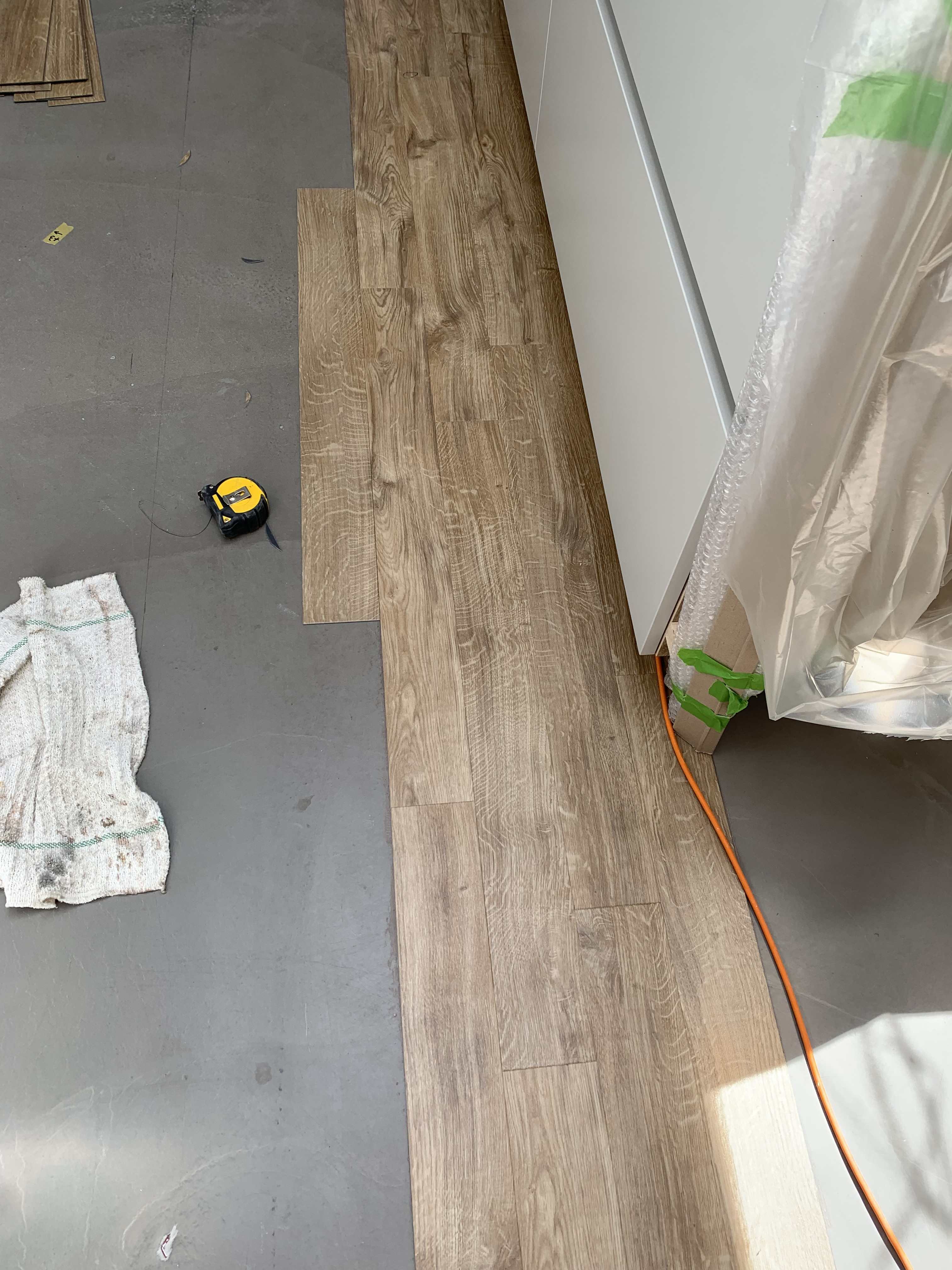

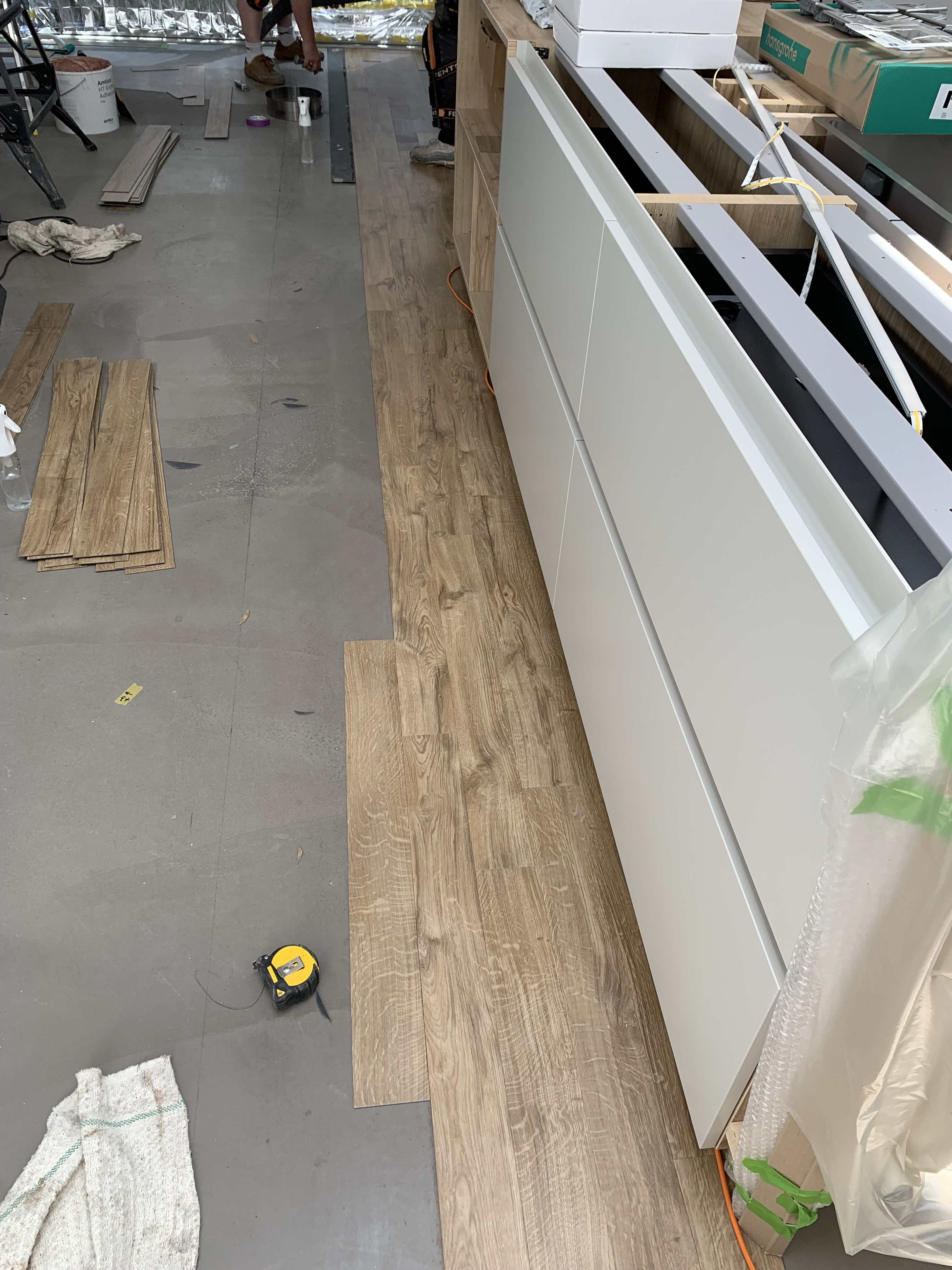

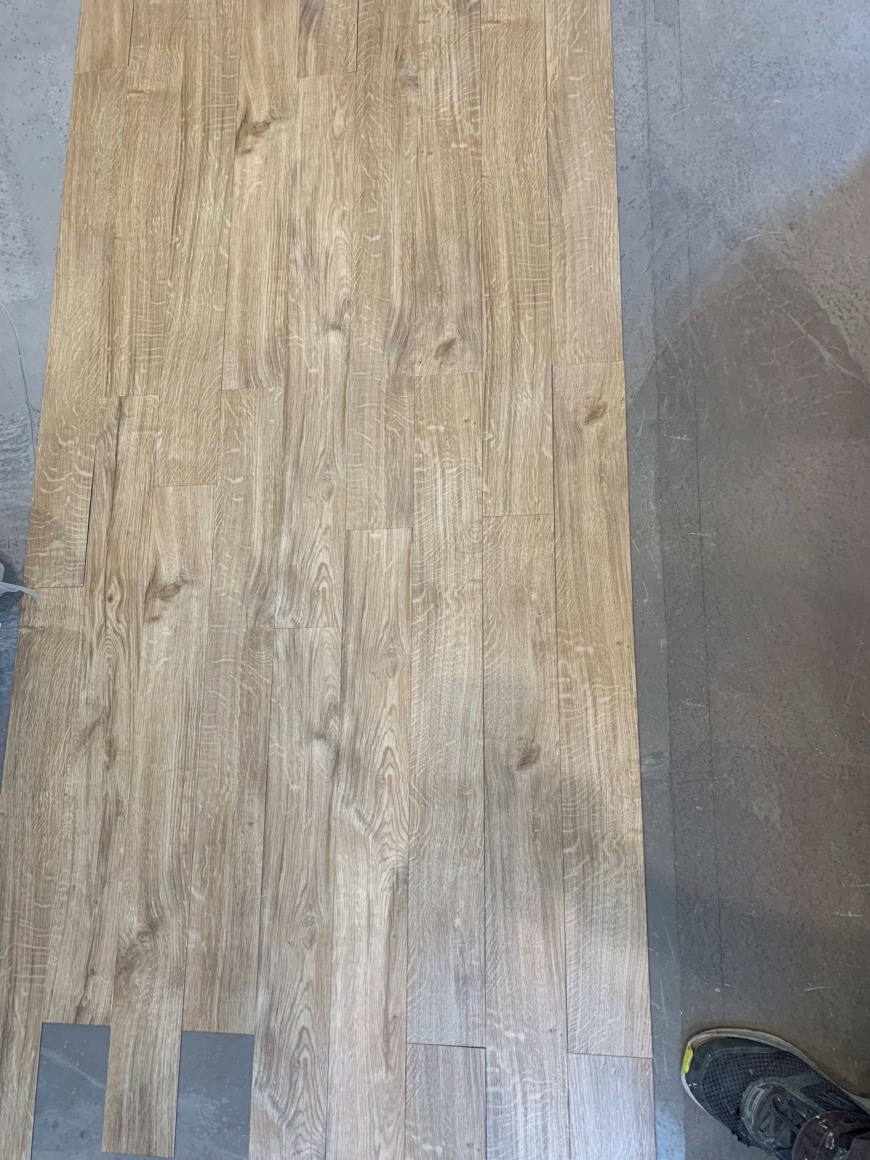

So my LVT contractor got replacement Amtico Spacia from a different batch without the manufacturing fault which had affected 25% of the first batch. So I have borrowed 2 boxes - each box contains 27 planks. Just found the time and space to lay them out on the floor.
I can clearly see that laying these is not at all straight forward. The planks seem to be cut out in a strange way, in that the same 'feature' in the wood can appear on multiple planks within a single box. The plank cut is just in a different place, so the feature might be near the end of one plank, and then in the centre of a 'different' plank. Just laying out this box as I suppose you might lay them working across by 9 planks and then on down the room, and bingo I have the same feature knot repeated 4 times within about 1 sqm. In my eyes NOT a good look.
AI now suggesting to me at least 5 boxes (that is 12.5sqm or 135m planks) should be opened and mixed and dry laid to avoid this type of concentrated pattern repeat. It is still not clear to me how large an image is actually used to make the planks. But AI suggests there are roughly 24 unique plank designs - this must be roughly 2 sqm though ?!. Given the room is 35 sqm this is really rather crap. I thought I was buying luxury vinyl tile. I'd have thought it would be just as easy to manufacture from say a 10 or 20 sqm image (or set of different images) as a 2 sqm one.
In a small room with less pattern variation then I guess things are easy, but we are having 50 sqm plus laid.
Feeling frustrated now - why did nobody tell us about the pattern repeat problem, and why did our fitter not automatically recognise it would need to be mixed across many boxes and dry laid ?
The temperatures have been too high to lay any for a week, now they may be coming down and there is this big disappointment and all the complications of arguing and dry laying.
Would never have gone for this had I known the truth. See Photo.

With a featured pattern it is definitely problematic.
Amtico clearly cut in different places but don’t really seem to have a big enough master image. We are going down hall & open plan room, about 15m with no thresholds. Laying in linear style which seems to be worse.

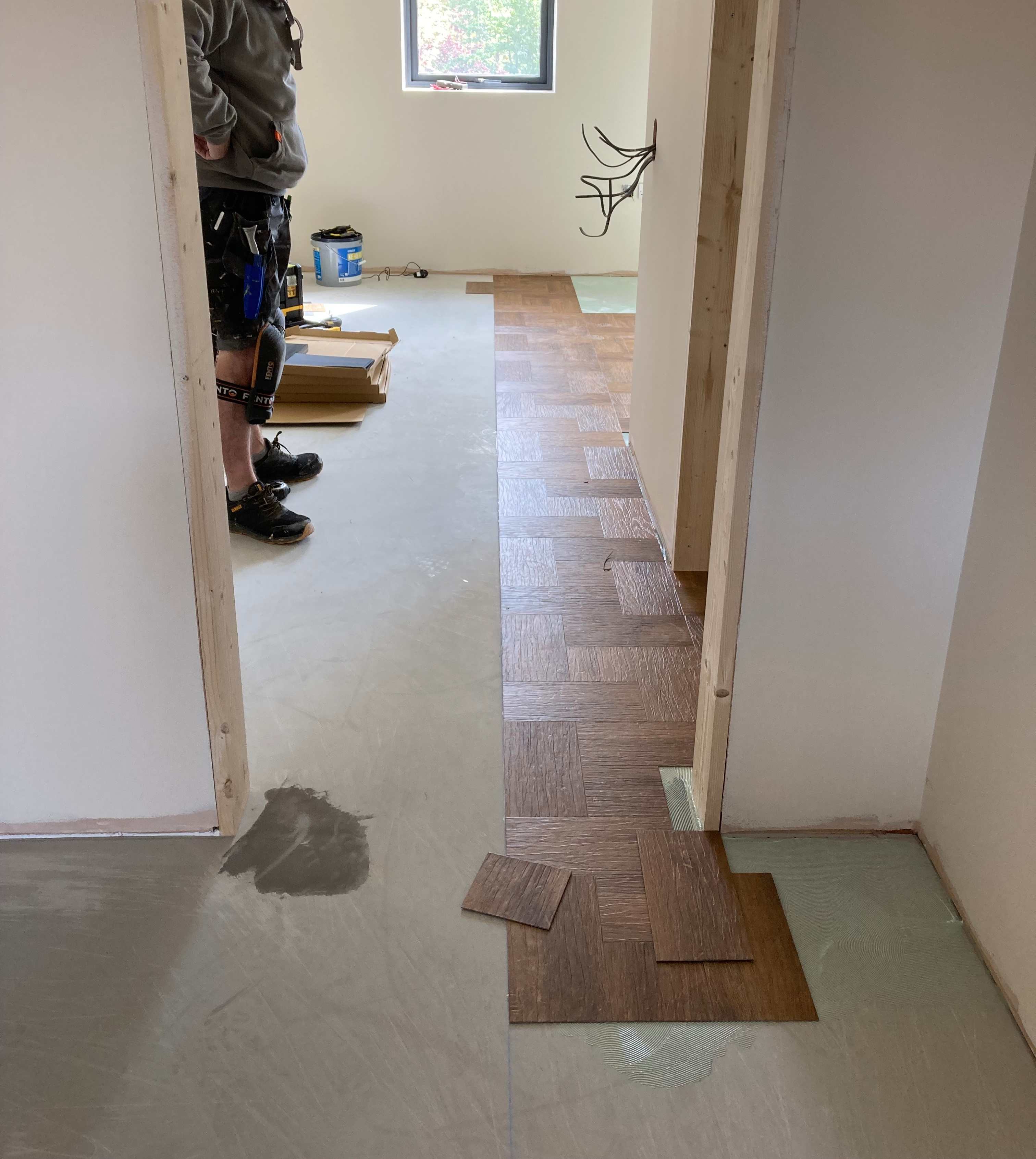

Our choice is both heavily patterned and embossed with a wood grain pattern.
The format is 5 tiles (individual)in a 450mm square, so although there are repeats they are way less visible than they could be. Even then a couple of tiles were removed and repositioned during the process. At the end if the day they are not wood, and were bought with long term practicality considerations as well as aesthetics.
Photo shows the initial laying out process (after the floor had ply and leveller)
If you are really unhappy is it too late to change design now? Better that than live regretting it for the next ? years
@G and J
OK, so you dry laid before glueing down by the look of it ?
