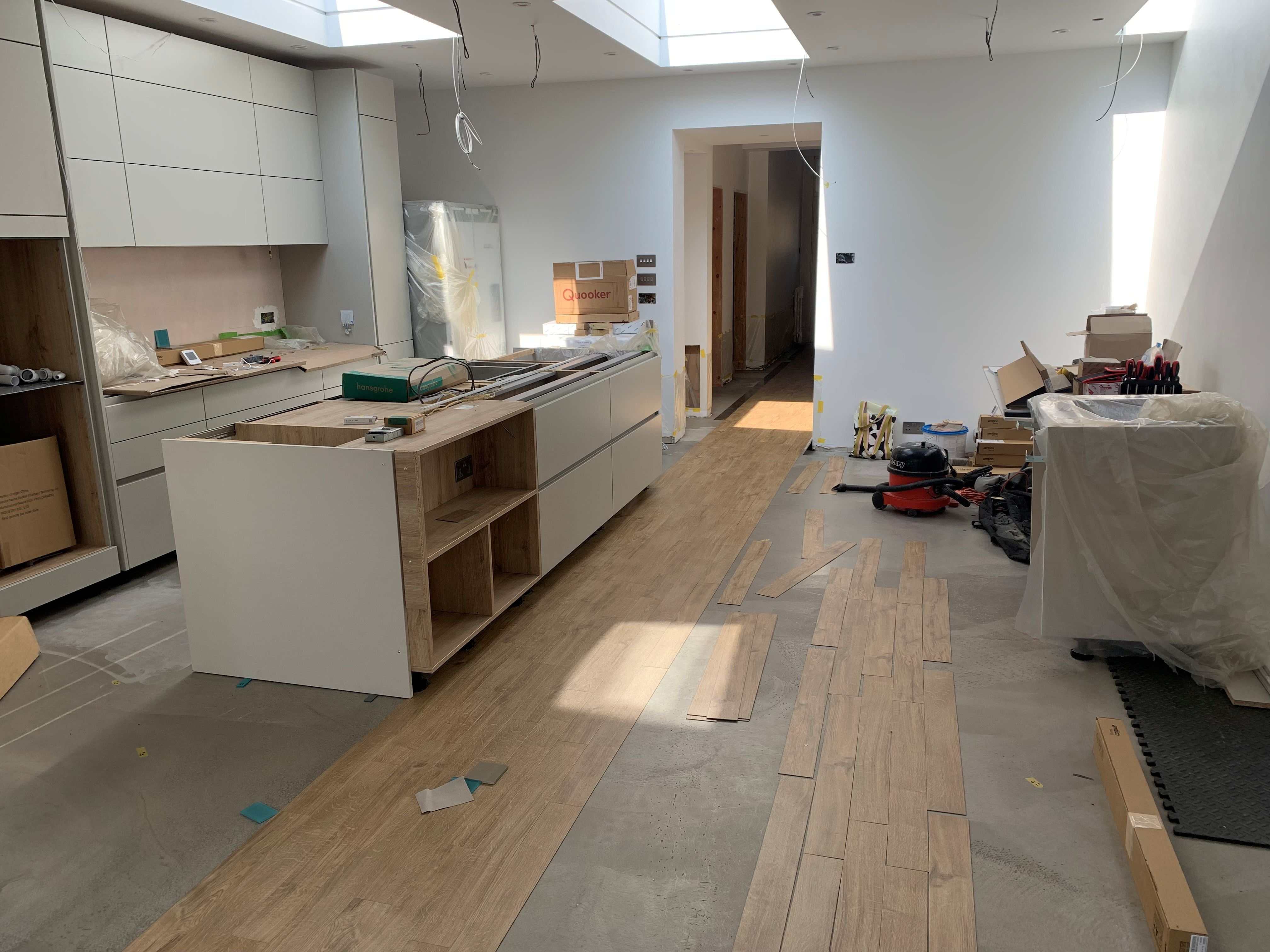

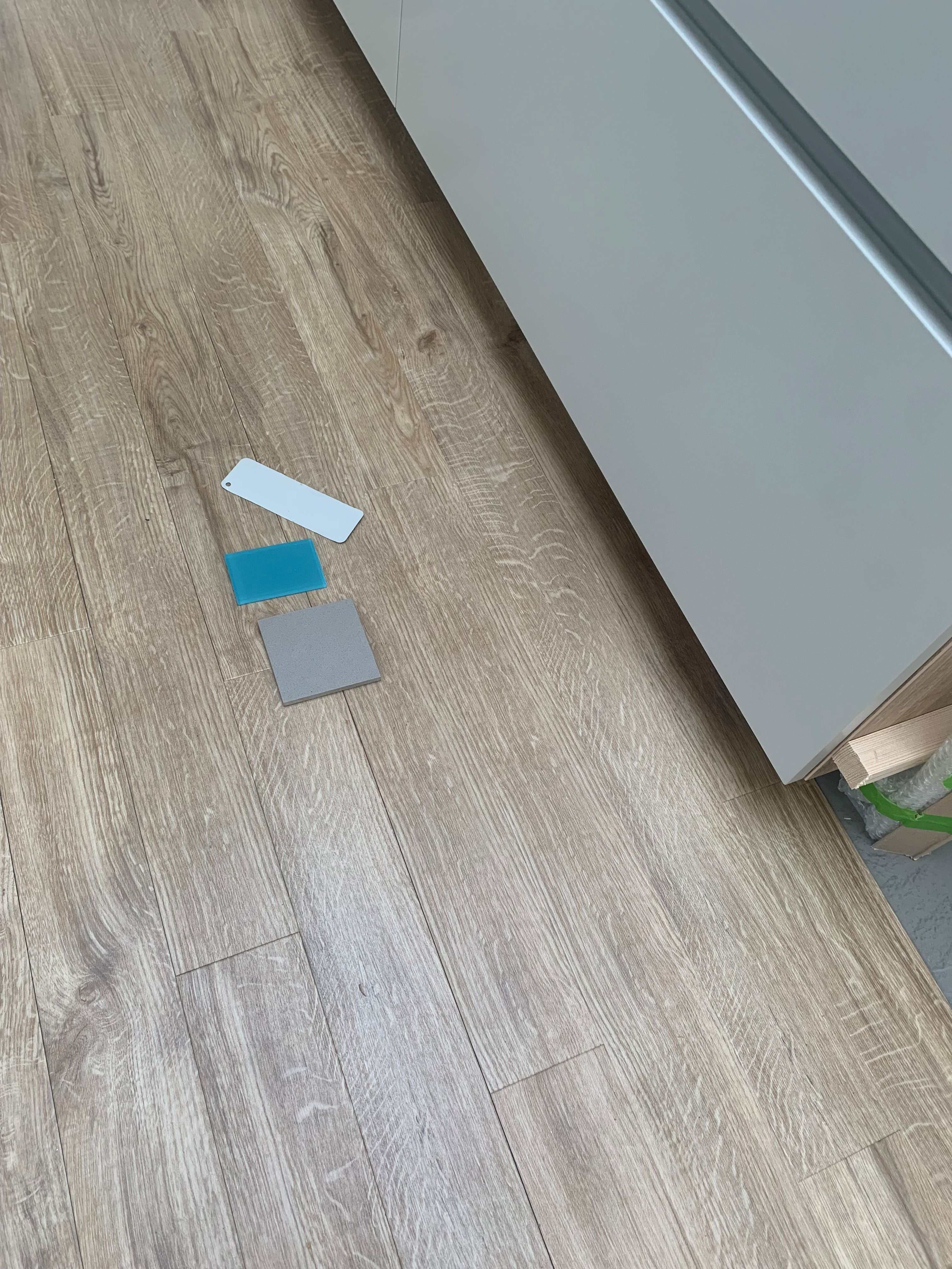

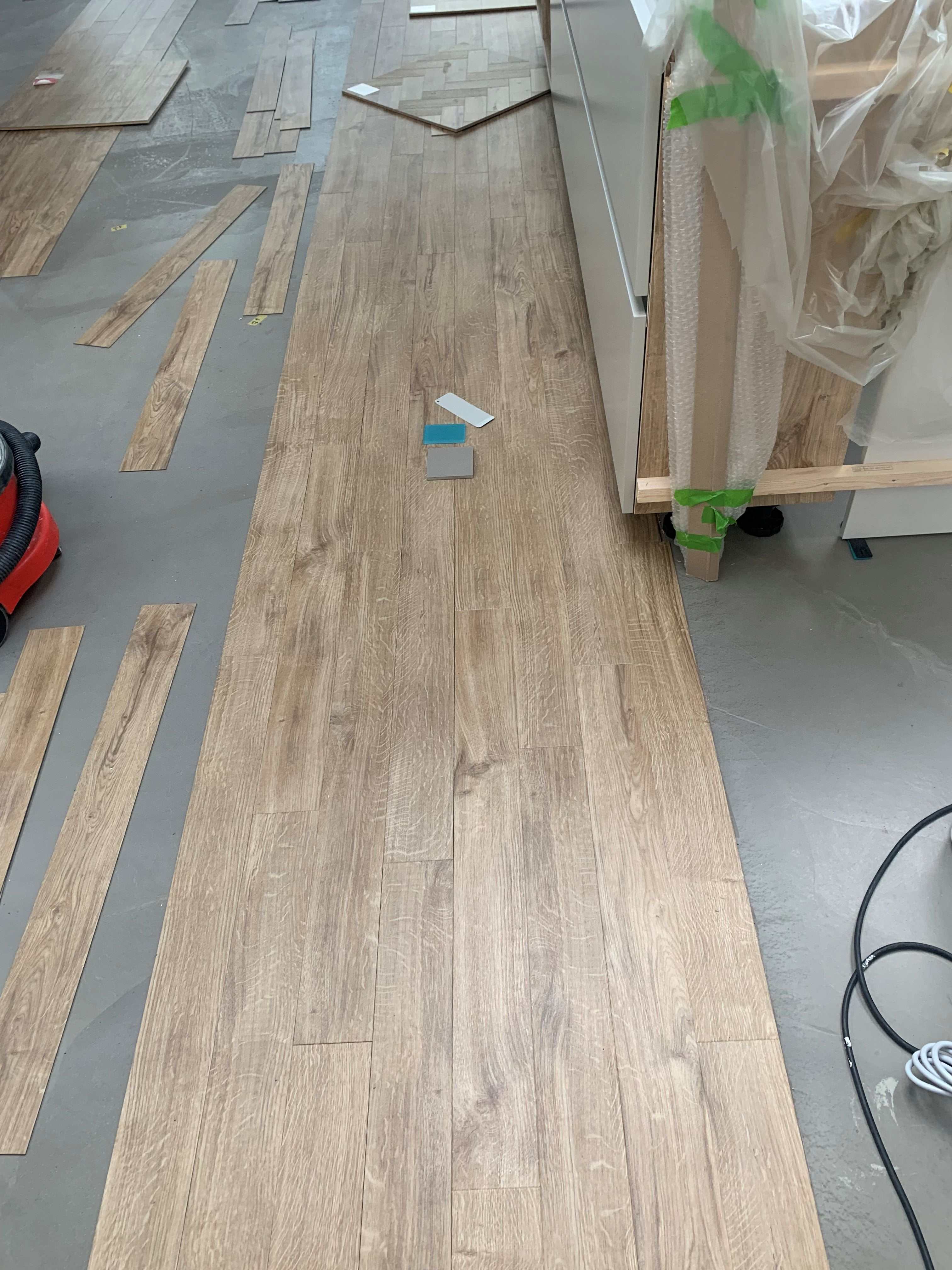

So now we have more boxes on site and I have looked over 4 boxes or 108 planks it becomes apparent that this is not throwing up any further 'image space'. It seems as though there is really quite limited unique wood grain image area equivalent to maybe 12-14 ish 102 by 914 planks - or maybe 1 to 1.5 sqm. These have then been cut at different start/finish points on the image so they are offset length wise, and/or reversed in direction.
When you try and lay these out by eye you really have not got a great deal of choice to work with. It is all but impossible to avoid repeated features within a meter or so of any point.
Dry laying can only achieve so much given the limitations of what there is to work with.

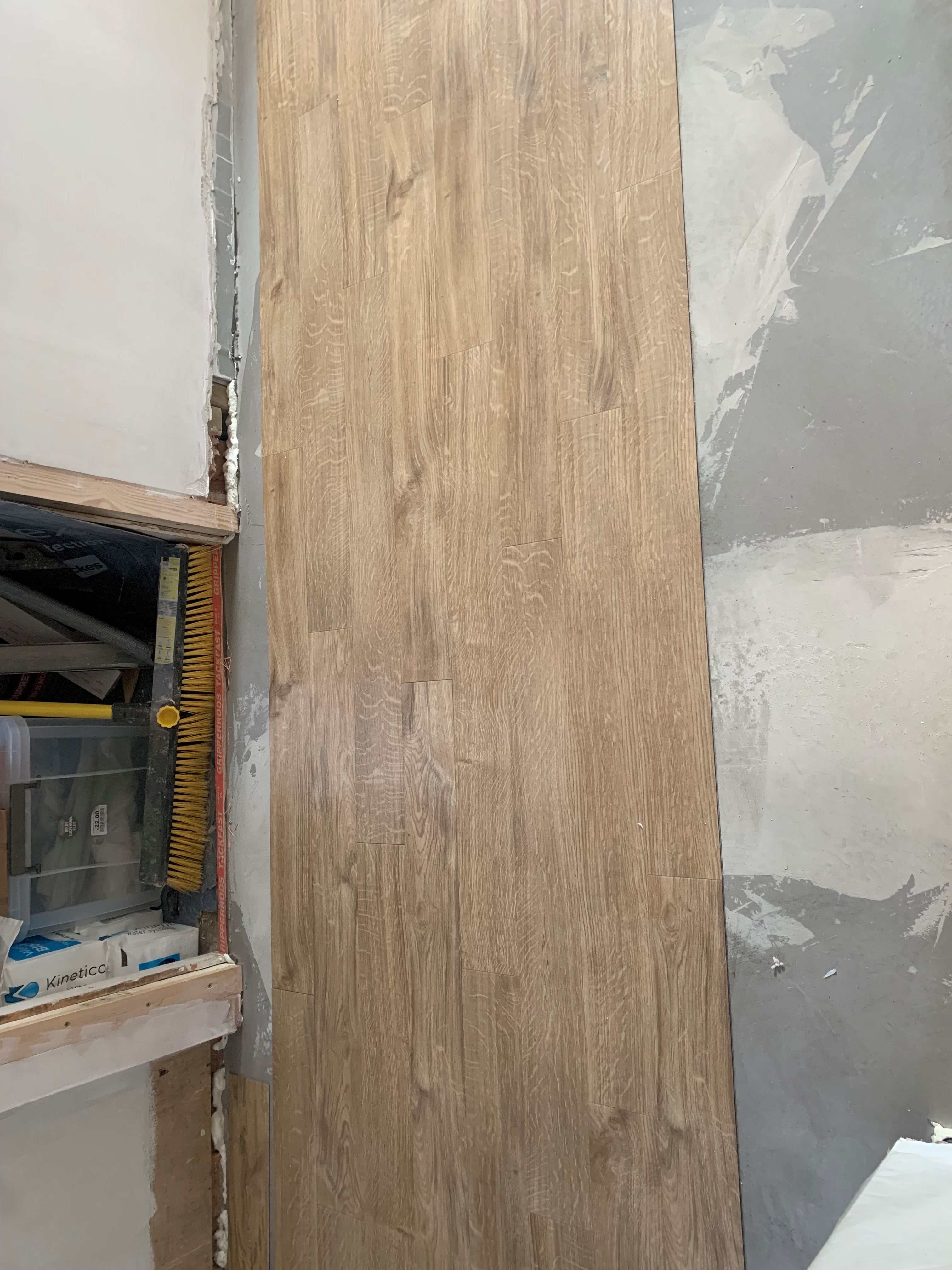

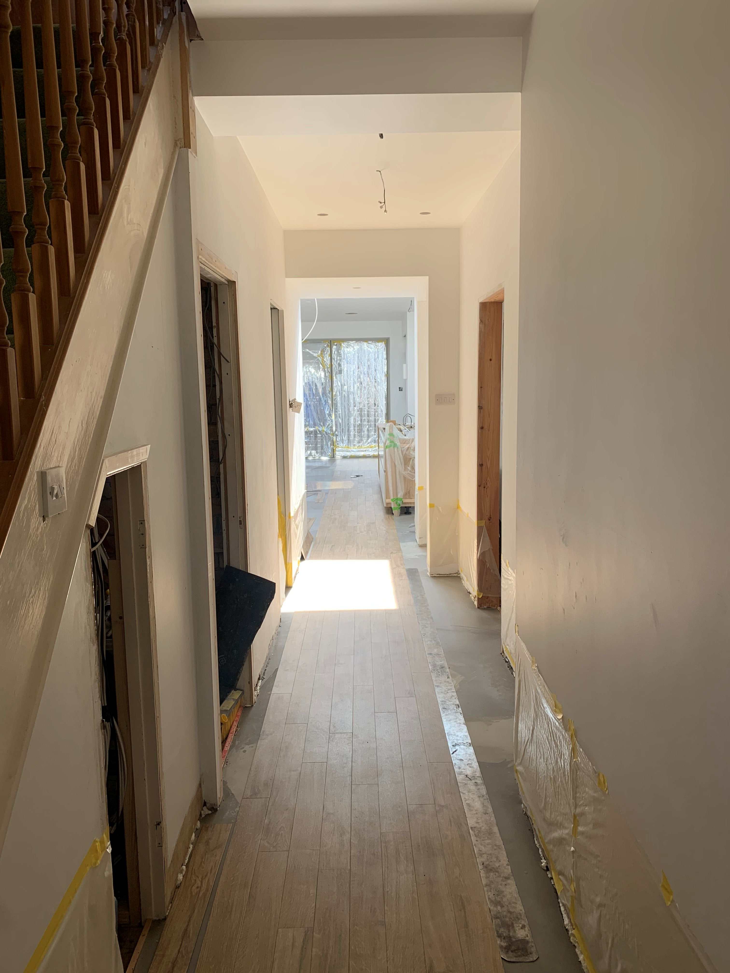

Young fitter laid the central strip 4 tiles wide on Tuesday and was happy to transpose tiles I had loose laid first. Has done a good job I think. Just one place where you can see a curved line reflecting the light and running fingers over it shows there is a small ridge running across the planks - he has agreed those tiles will need to be taken up and relaid. Seems unclear why the ridge (about 50mm wide) is there - whether it is the floor finish or some excess adhesive. Seems to follow a curve like a trowel would.
He has loose laid another central strip 4 tiles wide alongside for me to rearrange as I see fit.
Overall the current layout looks better than the first go, but still has a tendency to look marbled as much as planked when viewed over a distance. Not that keen on that, and so we took a rain check on laying more to go around the Amtico range again to see if there might be something better. Only found 2 alternatives, both Spacia, somewhat lighter in tone, and a 1 week wait to get even 2 boxes to lay out - Amtico completely control distribution and pricing, nobody except them holds stock.

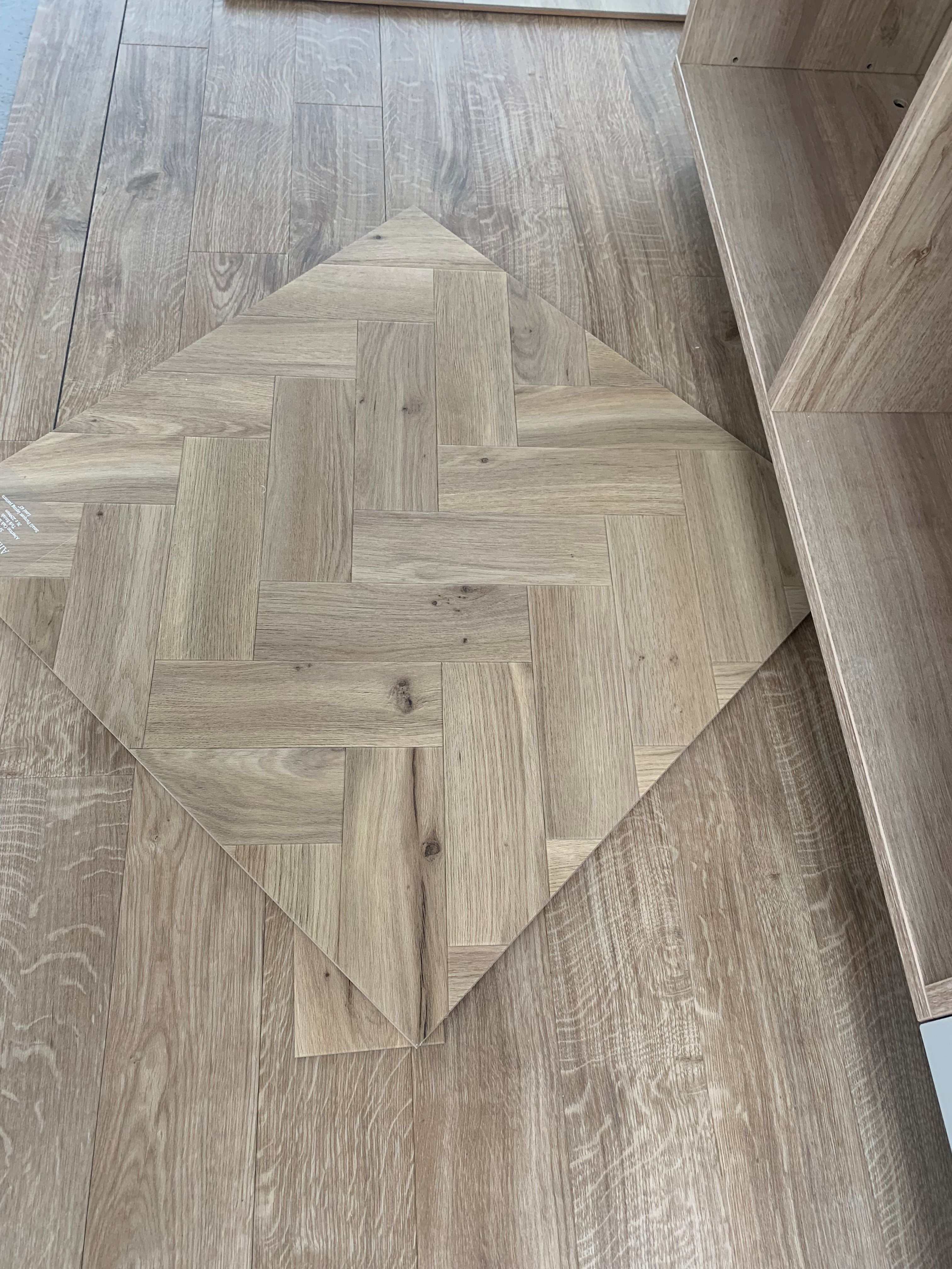

Only signature has a larger image area. Twice the price and we cannot find one we like. No featured oak in Signature, and generally speaking the designs/colours are a little more artificial and processed looking for our taste. Going with the fashionable parquet or herringbone layouts would hide the limited image size more, but we always wanted to emphasis the straight through line and feel these layouts may perhaps go out of fashion again.
As time has ticked by I have grown more accustomed to the Spacia featured oak, and as it is more mid tone than our alternative of Alverton Oak or Westmere Oak, will probably hide dirt/marks better. So likely to continue with that this week now. I attach some photos and welcome any more comments though.
