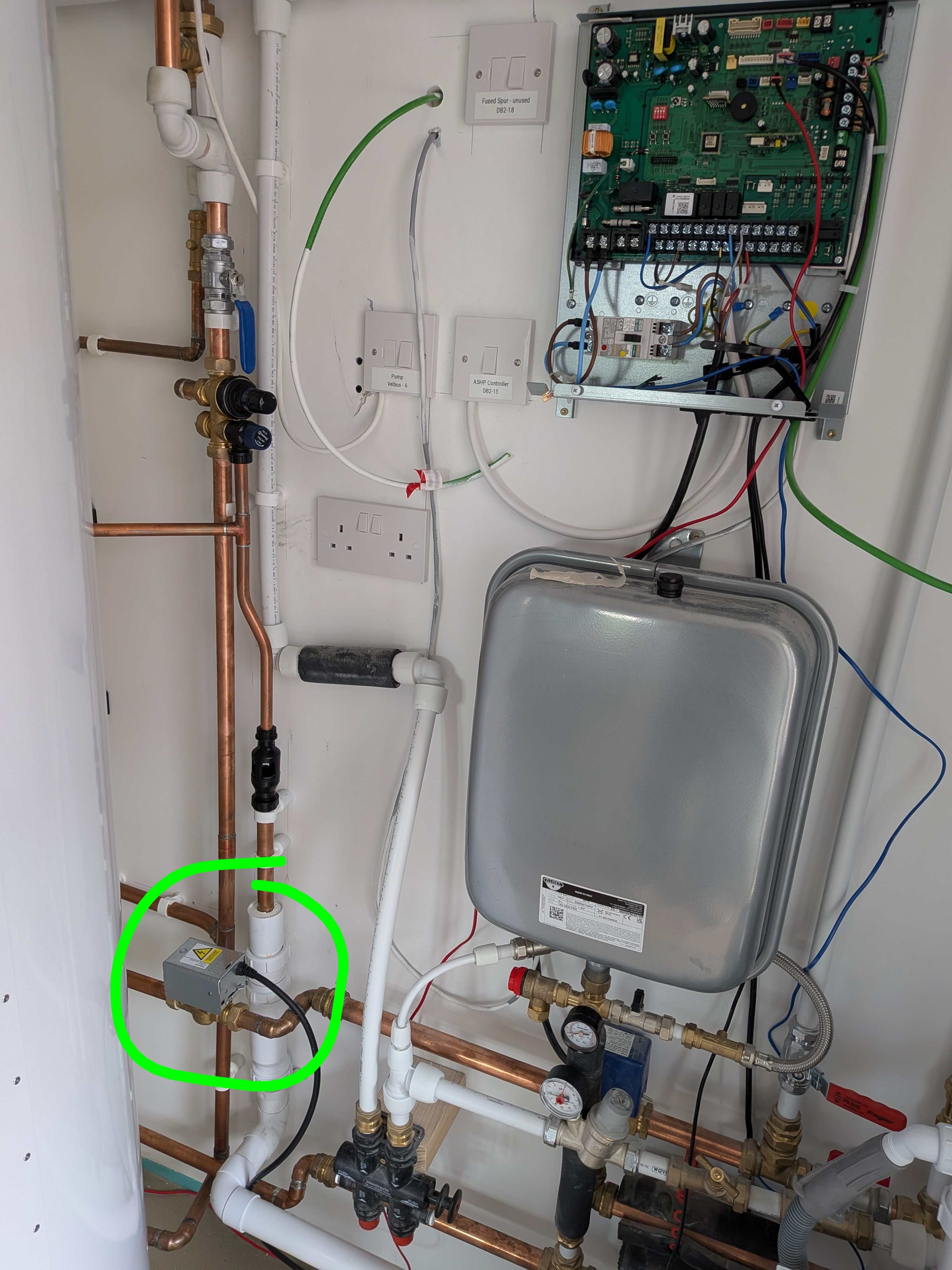

Booster heater and thermistor installed.
It's just the cut off valve for the over temp that needs attention.
I think I need to connect the valve to the tank thermal cut out  - with the BROWN wire connected in position 2 and GREY/BLUE/GREEN wired up to live.
Unsure on the ORANGE wire.
Live is fed to the immersion heater via the thermal cut out.
This is where the valve can pick up it's power (?) is my guess.

This is exactly my set up.
The extra valve is only on the DHW return to act as a safety cutout.

What is missing from this conversation is WHY it is there.
It is one of the many safety features of an unvented cylinder, to ensure it cannot boil.  So each heat source feeding the cylinder must have a fail safe cut off.  There is a theoretical fault possibility in that many heat pumps have a built in electric resistance heater for backup or boost reasons and if the controls operating that stuck on, then the cylinder could continue heating until it boiled.  So the valve we are talking about will shut down that flow from the heat pump if the heat cylinder is getting too hot.
It is okay to use your diverter valve, or a separate valve for that, as long as the valve is normally closed, i.e. no power to the valve and it is shut.
If using your diverter valve for this function then it is wired as normal, but with the addition that  the L feed to the valve also passes through the normally closed contact on the cylinder thermostat that will have been supplied with the cylinder.  This will open if the cylinder is getting too hot regardless of what any other controls might be telling the valve to do.
I hope that makes sense, as up to this point I have not seen mention of the cylinder thermostat.
If doing as above the normal thermostat doesn't comply as it has to be non self resetting, a dual function cylinder thermostat would comply or a stand alone non- self resetting one complies

Diverter valves - To comply with G3 Building Regulations. When installing with an unvented cylinder, Port A must be used for the hot water connection to the cylinder heat exchanger and Port B for the central heating connection.  This means the valve when de-powered shuts the flow to the cylinder.
