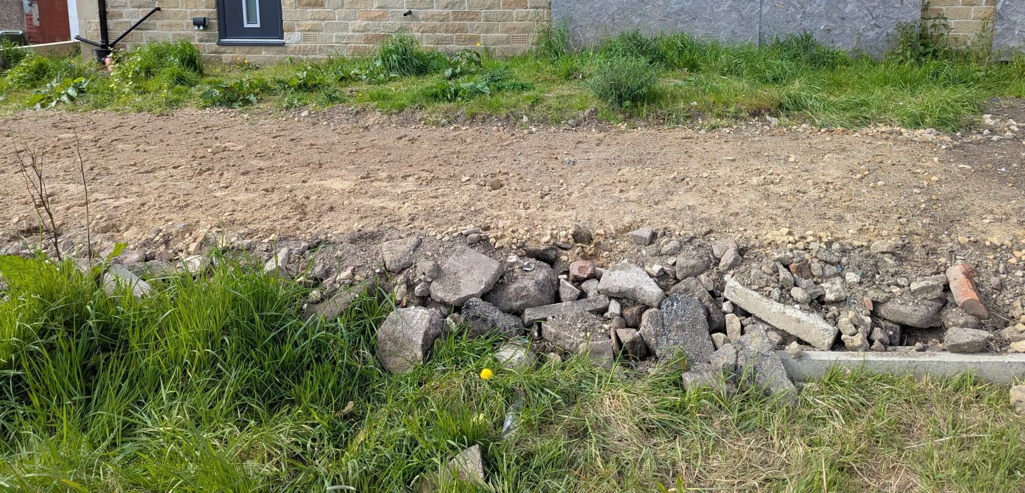

Due to financial constraints, I will be undertaking the upcoming external works on a self-build/DIY basis.
To achieve building regulations sign-off, the immediate priority is to satisfy the compliance requirements for Part M (Access to and use of buildings). Specifically, this entails constructing a compliant wheelchair-accessible (no wheelchair user in the family) entrance at the front elevation and a raised patio at the rear elevation.
Given the extensive nature of the external works, my strategy is to execute the absolute minimum scope required to secure regulatory approval. This will allow the remaining landscaping works to be phased and completed at a later date.
Front Entrance (Accessible Route): Installation of an ACO threshold drain, lay weed membrane, MOT Type 1 subbase, and lay paving slabs flush with the front door sill to provide a level threshold.
Rear Patio: Construction of a structural retaining wall, installation of an ACO drain against the house, lay weed membrane, lay and compact MOT Type 1 sub-base one step below the bi-fold door threshold. (Leave paving for later)

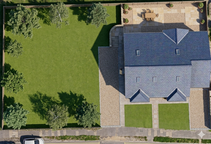

You also will need to a ramp down to your parking area from that. I just made a very shallow incline direct from parking area to the level threshold in paving slabs.

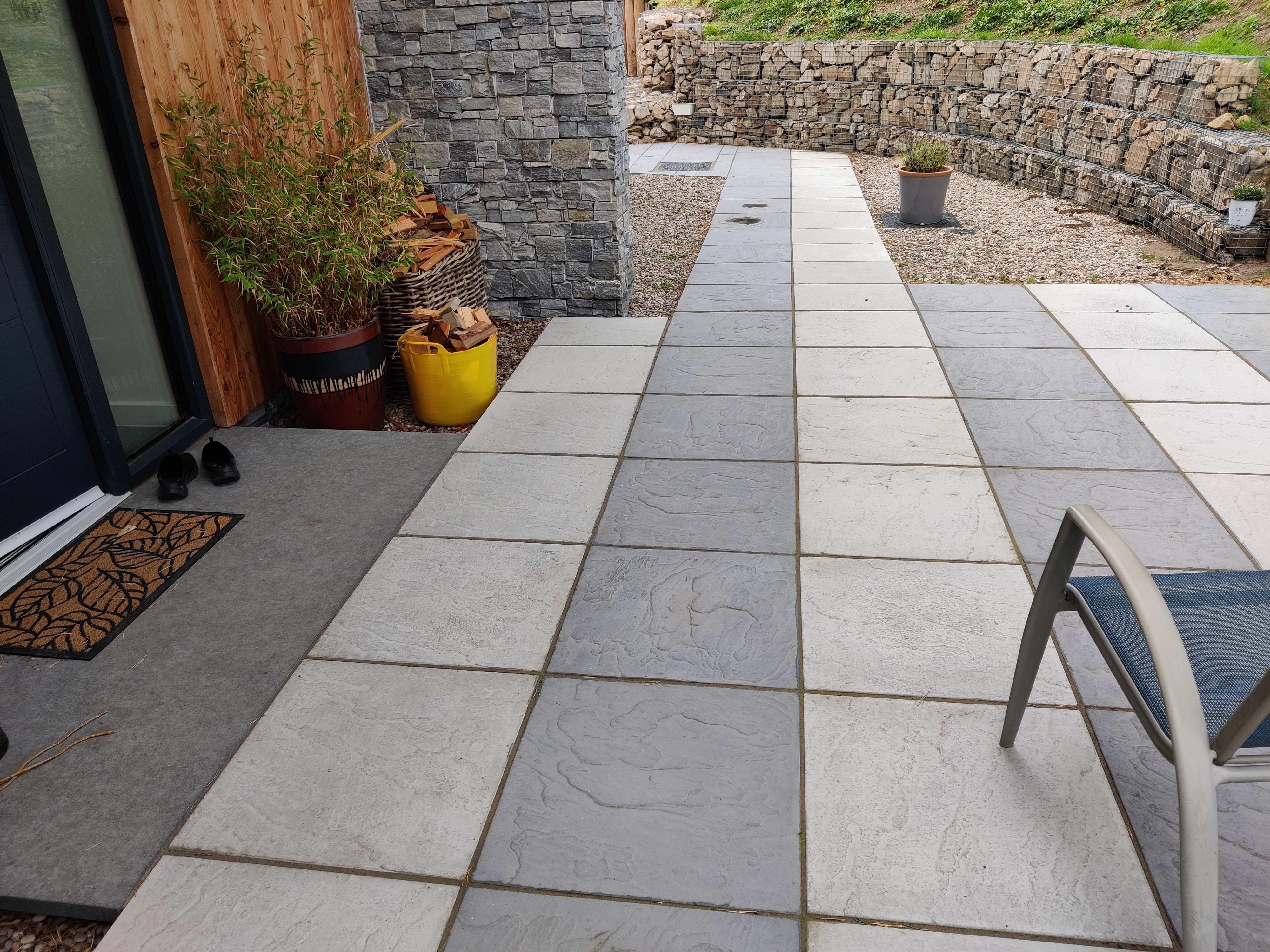

@JohnMo perfect. Thanks for the photo. I think I can just copy this design. A platform outside the front door and footpaths leading to the driveways.
The front door is the principle entrance.

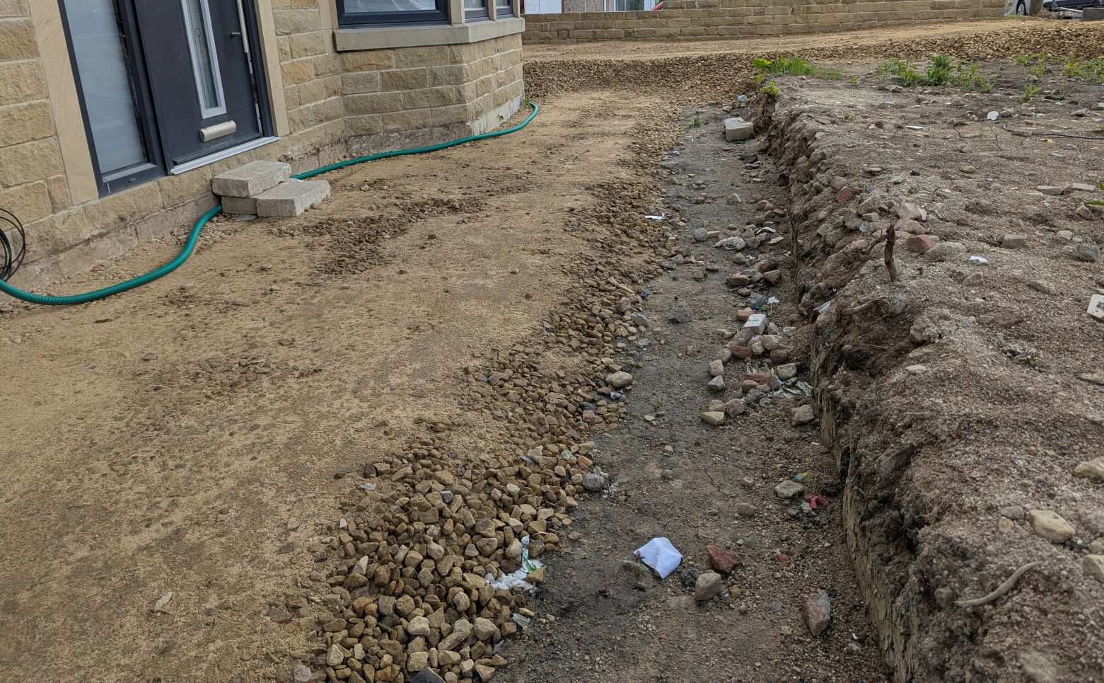

The building regs officer said either to raise the patio or to put steps in front of the bi-folding doors. I will hardcore the patio and compact it so it's just a step below the bi-folding doors. This will give us enough depth to play with in case if we want to have the patio level with inside floor.
No level access was need at the rear of ours, just the front door. Love it now.

@Temp We planned to have a raised patio, ~2feet, before the build started. There are some concrete blocks showing at the moment. To be fair, the building inspector never said he wants a level access at rear. He saw the ground level, which is about 2 feet below bi-folding doors and he said he either wants patio raised or steps to be put in.
Due to financial constraints, I plan to have the patio raised but a step below the bi-folding doors. Hopefully, once the VAT money is realised I'll level the patio with internal floor so that the floor looks seamless from inside.
