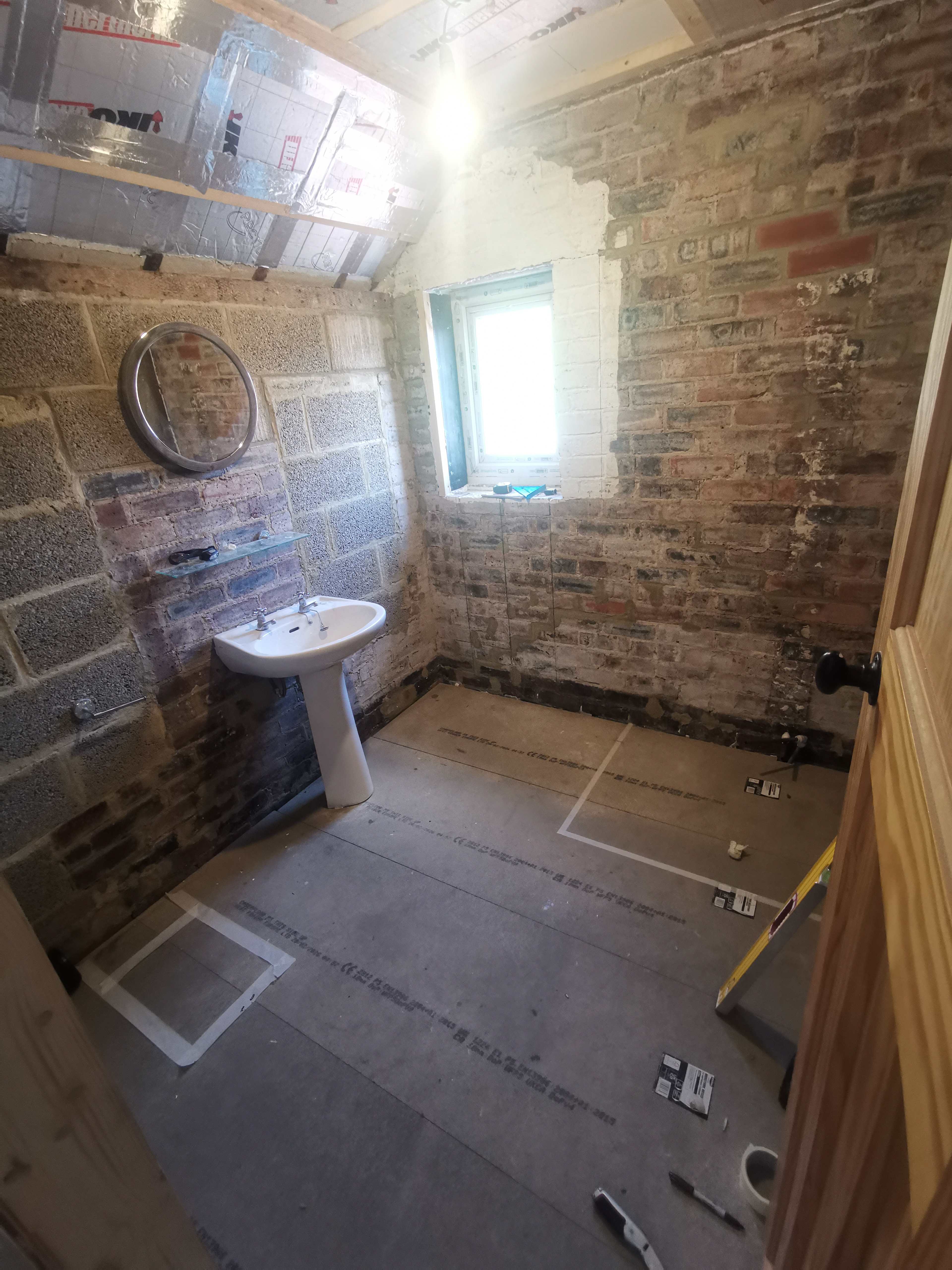

Good evening my friends.
As the football is over and my working year comes to a close (university) it means I can get down to business so I'm ordering my supplies.
My shower will be pressed against the only external wall in the room, it's currently back to brick so I was going to backer board that wall, the type with the foam core. I'll just MR board the rest of the room. The room is very small, any centimetre gained is a bonus. What are my options at the shower area, tile adhesive, foam directly to the wall followed by screws and washers?
Cut my space loses, batten the wall out with 20mm deep battens and go against that? If so, insulation between said battens?
Sack off all of the above, MR pasteboard and tank?
Opinions welcome.

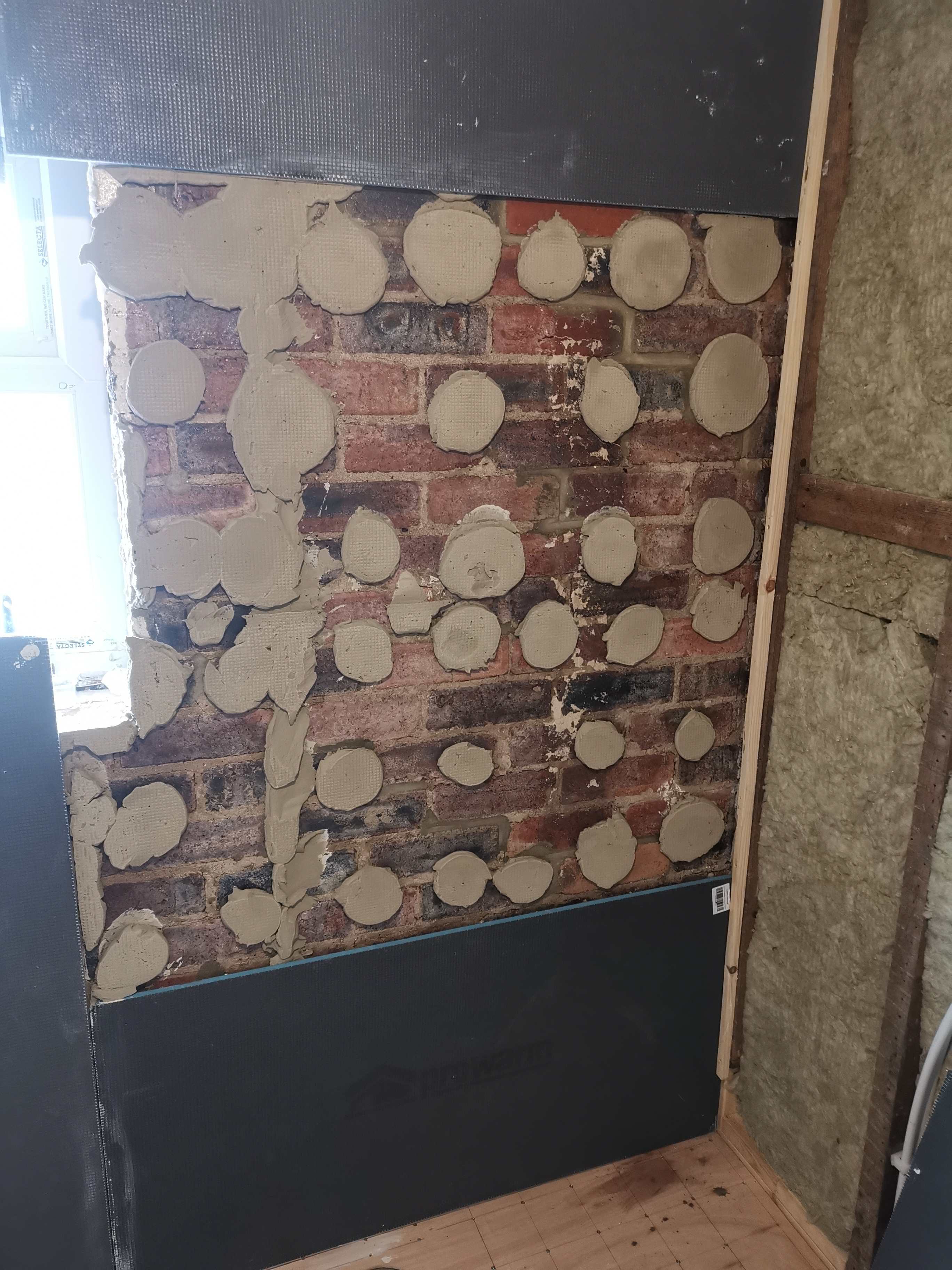

Dab the boards on and apply the dab to the boards. Poke a hole through the centre of each dab before applying to the wall, as markers, and when the dab is dry you drill back through and mechanically fix with corrosion-resistant fixings and washers. Foam at the footer, header, and sides. Leave a 3-5mm gap between the boards to inject foam in the gaps as dab must NOT be allowed to come through these gaps. That would bridge both cold and moisture, in the worst case.

So i have this straight, XPS board, dabs on the board as opposed to the wall, dab about the back but away from the edges. Push that plumb, when its gone off drill through the dabs in various places. Sound about right?
42 minutes ago, Super_Paulie said:
apologies 🤣
Ya 👍

Tile adhesive or traditional plasterboard adhesive? The wall is brick with cavity.

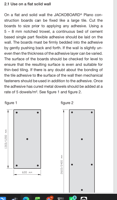

How many you reckon is needed on a 1200x600 WEDI panel into the brick? Searched the entire internet and can't find the answer...
5, if the same as jackoboards, their instructions suggest one in each of the corners and 1 to the middle.
Edited by crispy_wafer
Great find, cheers Crispy. I was planning on dabbing rather than full fix but I guess it won't be far off once it's compressed anyways.

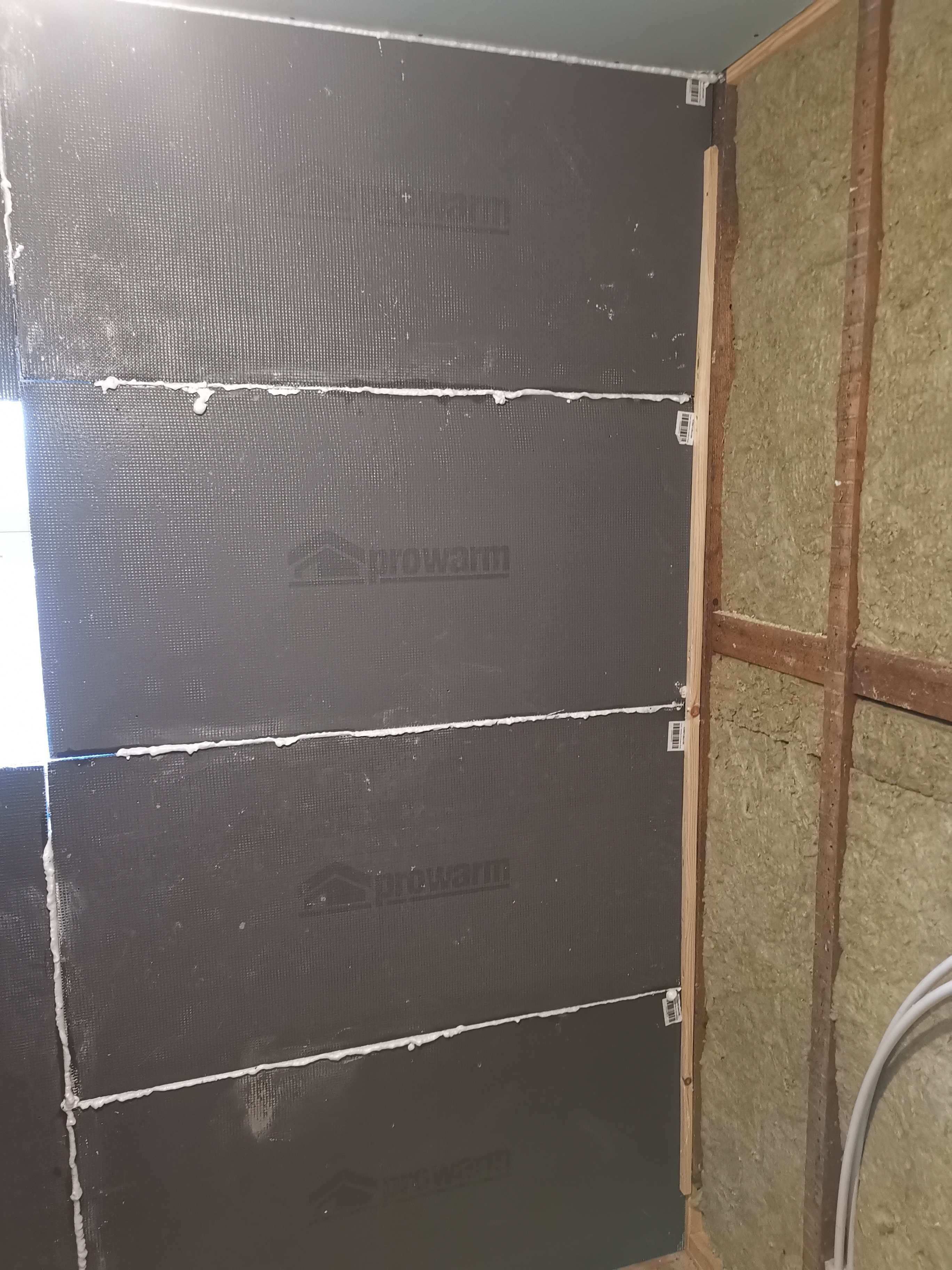

Ok, boards are on. Just need to do the mechanical fix and foam the gaps as above.
Two questions have arisen though.
1. Does it matter if the screws are stainless, they'll be getting tanked over anyways?
2. I've got FM330 in the gun, but I'm thinking I should be maybe using something more sticky between the gaps like Insta Stick?
On 18/06/2026 at 18:32, Nickfromwales said:
Traditional dab is fine
And adding number 3 to this!
When I went to remove the spacers between the boards they just came straight off...
The boards just didn't take to the knauff plasterboard adhesive. I guess I'll go tile adhesive and try again.
Just about to get some tile adhesive instead, sure it'll be stickier! I'll SBR the boards as well when I'm back in. No biggy, learning curve innit, appreciate all the help.
Much better this time. Used some rapid set and did 2 boards at a time, seems solid now fingers crossed.
