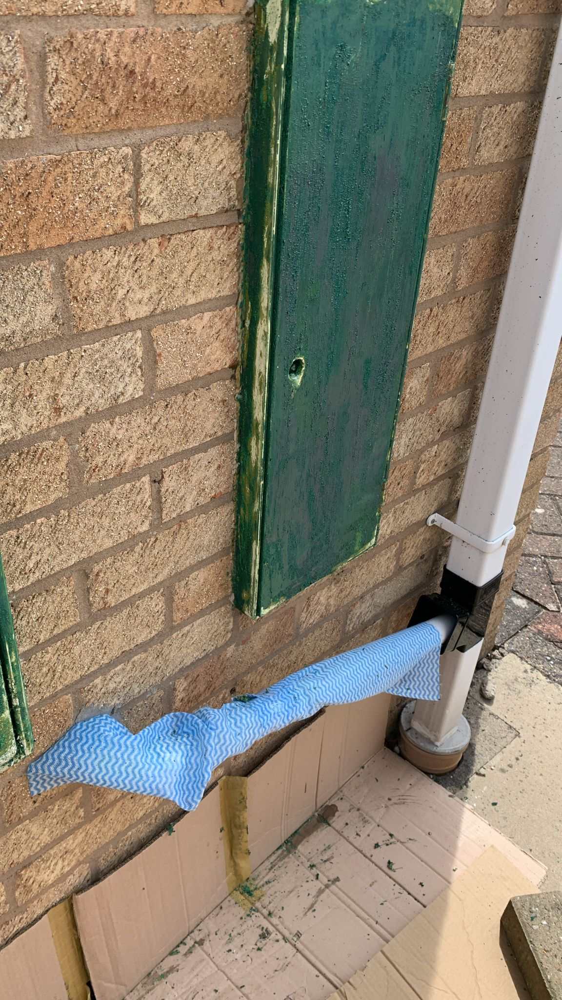

Hi, I am after some advice.
Just been to visit my 92 year old mother. Didn't realise that British Gas were replacing her boiler. All the internal stuff looks OK but a bit concerned about the condensate drain that has just been placed in a downpipe branch. Not fixed just resting in there. Ignore blue cloth, protection from stripping paint.
Thanks. Karen.
Yeah, that's not great. It should be fully insulated and the insulation should go all the way through the wall. Just resting like that isn't good either. I would personally probably have 2 clips - one just after the bend as it exits the wall and the second before it enters the down pipe. Also, wtf were they thinking with the black? Just looks crap. Not very good standard at all and enough to question the rest of the installation, frankly. Get them back to sort it out as it doesn't comply with the regs or with the manufacturer's instructions on condensate drainage for a start. They should know better.

Now they might say well ok we are following the gas regs we have the right tun dish inside so the over pressure is discharged.
Putting my SE hat on I'll say if that pipe freezes you can't have water pouring into the structure. Now the building regs support my statement.
It's a disgrace. Between you and I @Nickfromwaleswe could make hay with this compliant! And to do this to a person of this age is appalling. My own view is that there needs to be a bit of punishment element to discourage others.

The condensate drain doesn't really work like this. The condensate pipework is technically part of the boiler flue, so it has a 75mm condensate seal trap built into the boiler. In the event of freezing the condensate backs up into the the trap, and then into the boiler heat exchanger and triggers an ignition lock out in the boiler. Depending on the manufacturer's instructions, the condensate drain may not require an air gap where it connects into the drain pipe.
Unless the system has a UVC, it's unlikely to use a tundish as there will be a blow off pipe for the pressure relief valve. This should be directed to the outside, or a suitable drain. There's a chance the installer here might have installed the prv into this condensate drain pipe in which case it would need a tundish, but I'd wouldn't expect BG to do something like this - usually they drill a whole and stick a 15mm copper pipe through. Only a couple of manufacturers, like Viessmann have a combined prv and condensate drain, which is again unlikely with BG installations.
Best thing to do is for @Babybirddog to call Gas Safe to start a complaint, sending over a picture and then ask for an inspector to come and have a look at the whole installation - basically start the call with a nice question about whether it's correct or not. Then contact BG armed with Gas Safe info. With Gas Safe they will only allow the home owner to submit the complaint. The last one I had was when a customer of mine, an elderly lady who was mostly chair and bed bound, asked me to come and service her boiler. When I tested gas operating pressure with the gas fire running it was below the safe minimum for the fire. I asked her when the fire had been installed, and got the full story on a crap installation that included badly laid out coals which meant the gas fire wasn't combusting correctly either. The installer hadn't registered the installation with Gas Safe. I called them but they wouldn't accept my complaint as a Gas Safe registered engineer even though I told them the installation was unsafe.
I was generalising. I makes no difference as you should know. The condensate seal trap works the same way. It does not matter if it is internal or external to the boiler. The fact is that if water backs up in the rain water pipe it's going to piss out inside the house big time and wet all the electrics for example. . Of course it triggers a cut out of the boiler but where does the over pressure from the rain water pipe go then. If the rain water pipe backs up then the pressure head is at gutter level say that is 2.5 to 3.0m head.
Are you serious? A Pressure relief valve into a condensate pipe? Can you explain in lay terms?

You’re better off with it going into the downpipe, but it needs to be done better. Refuse to settle until the fitting is a white one, theres a rubber bung reducer to accept the round pipe into the square fitting, and its set back to the wall and clipped; minimum of 2 clips here.
A soakaway needs lime chippings in it to neutralise the condensate, and these will need changing periodically. If not, that can eat into the foundations, worst case.

Gus, look at the picture, the condensate pipe is not sealed into the rain water pipe so if there's a buildup in the rain pipe it'll piss out where the condensate pipe is resting in the tee. Whilst it is 'okay' to have a sealed pipe connection into the down pipe, best practise is to install it with an air gap as a just in case measure.

The boiler is in the garage and all the pipe work was previously insulated and it doesn't look like this has been touched.
You have a heat only, or what some people call a conventional boiler. The biggest problem is the condensate pipe. It's not clear where it goes from 19mm pipe to the larger diameter, but as it's inside a garage and therefore subject to low temperatures, I would have fed the 19mm into a min 32mm pipe just below the boiler and then out to the drain pipe, insulated all the way.
The other thing I notice is that the gas pipe is actually too close to the Consumer Unit - it should be a minimum of 150mm, but it seems like it's been that way for a very long time.
The only thing remaining is to check the flue has been sealed correctly and is supported through the wall. I'm guessing they didn't touch anything else inside the house during the installation?

The condensate collection pipe should be insulated inside and outside the unheated space and should terminate to a suitable foul drain - not a rainwater downpipe. Failing this it can be connected to a limestone filled sump > 1.0m from the foundations.
If the boiler is inside an attached garage/space a CO detector/alarm should be fitted.
Also you may need to have a Building Control Application made for the works.

I would like to thank you all for the advice and just a quick follow up.
Eventually, after 3 appointments, one a no-show and many months the pipe work is insulated, supported and all the same colour.
I won't bore you with all the details of the many, many emails but the phrase "I have been reliably informed" was used on more than a few occasions.
And managed to get an extra 100 quid knocked off the bill for all the hassle.
