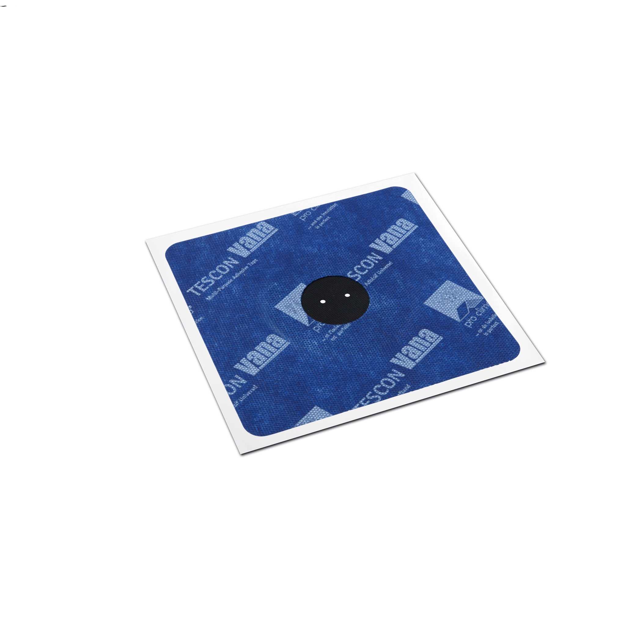

Then all will be well - except! You need to think about how the cables come through the airtight layer as you will need to make that interface airtight as well. I used some squares  of EPDM with hole punched through smaller than the cable then pushed the cable through and sealed the EPDM to the airtight membrane once it was installed - it does mean pushing the cable through the airtight membrane so you need the end free to do it.

...how the cables come through the airtight layer as you will need to make that interface airtight as well. I used some squares  of EPDM...

Trying to airtight single cables is a PITA, plus the conduit acts as an insulator giving the cable some separation from the insulation.

No, not the way I discussed above - for single cables, much tougher for multiple. Just cut a square of EPDM (0.7mm) punch a hole just smaller than the diameter of the cable (or its smallest dimension for the flat stuff - invention of the devil) then just pull the cable through the hole and tape the square of EPDM to the airtight layer
