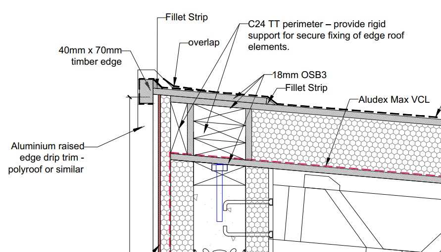

This is an example of the details produced...
There is far more timber in here than the alternative detailing and much of that is not practical in my view. Besides, the Aluminium edge drip trim arrangement doesn't conform to Sika's detailing and for their own trim that is the only one they allow.

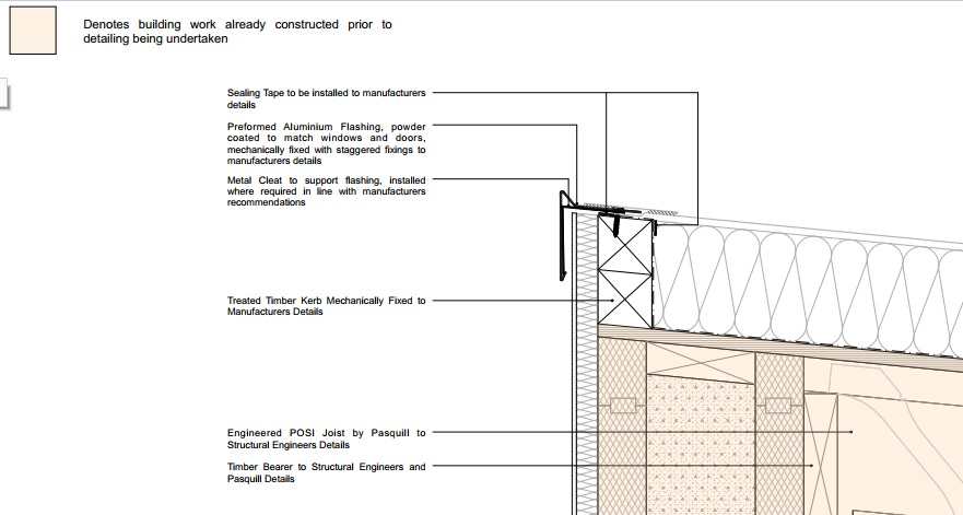

This is the alternative that I now have in hand (not quite finished but you get the idea). Far simpler and compliant with the manufacturers requirements....

Ok. A few points. You'll see lots of stuff on BH that looks easy until you try and meet all your requirements. Below is a bespoke detail of mine, your detail is more simple on the face of it and I can see you are asking why there is so much timber. I have posted this to let folk see how hard and how much thought and experience you need to have to navigate your way round this and then produce something that is buildable. The screen shot is just that, the drawings are more defined and the colour easier to understand.  The key points for you are that I'm using the top sheet and bottom of OSB to cantilever out to support the roof edge. I can prove this works as an SE. But you have to cut your Architect a bit of slack as they can't really be expected to know that you can cantilever OSB for example.
