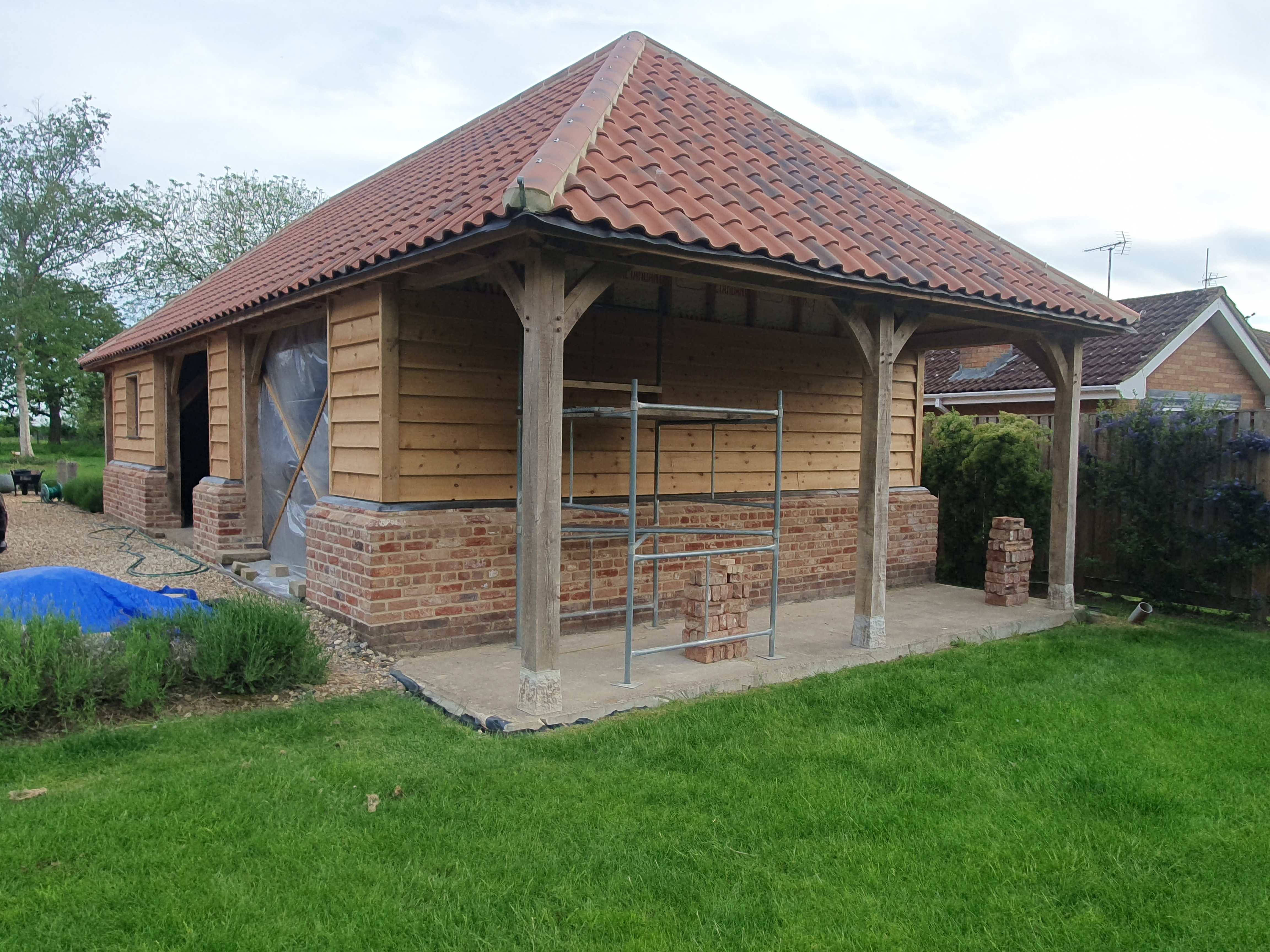

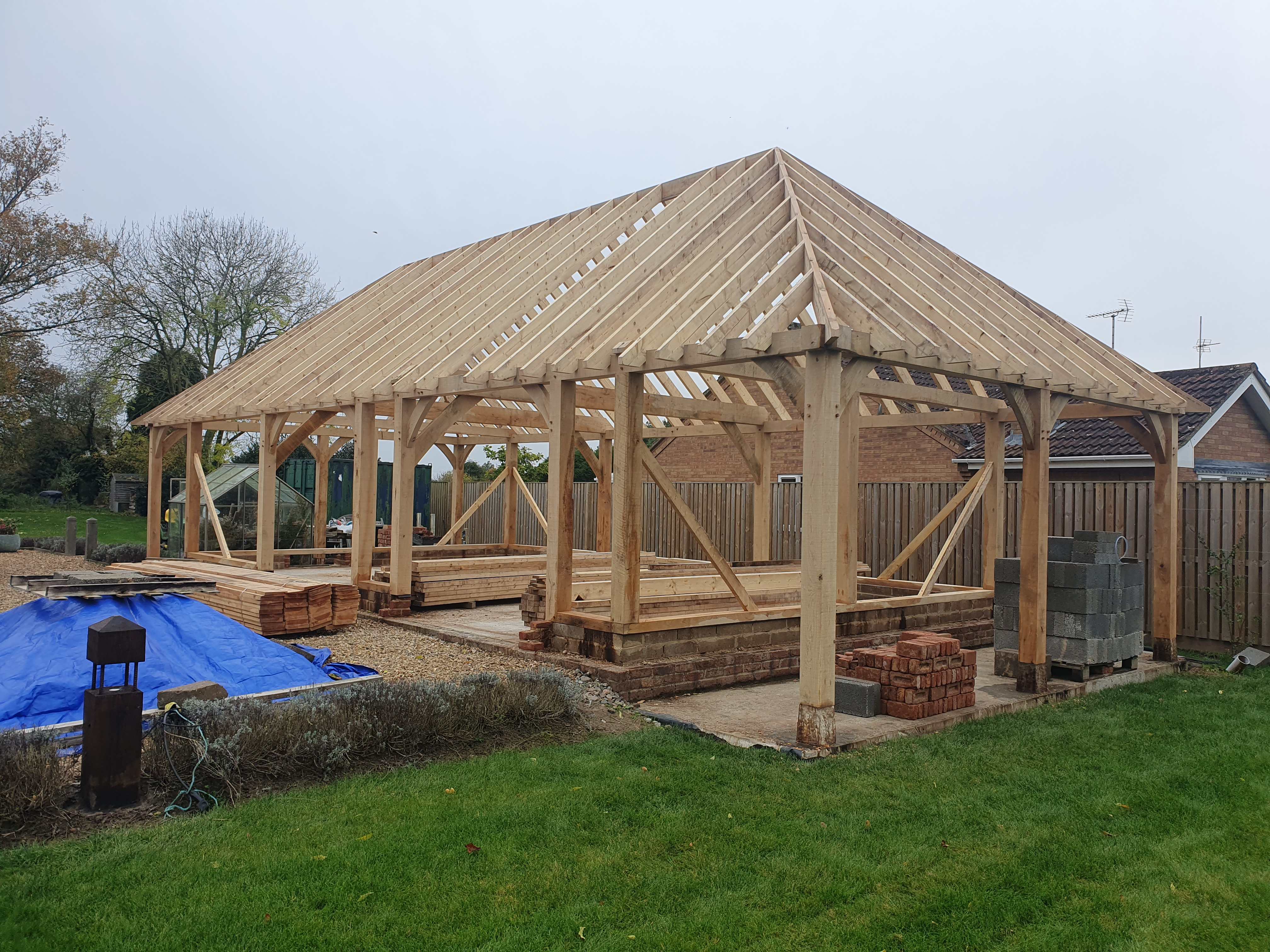

Oak frame kit, delivered and erected in 2 days.  Finish at your leisure via trades or DIY!
1 hour ago, BotusBuild said:
Love that? How much? Do they do a single pitch roof?
Bespoke, so they can build what you want.  About 18 months ago, the frame was just under £19k erected, and included timber for studs, joists and cladding, but it is quite big: effectively 3 bays plus wood store each end, and storage space up top.  Still progressing at a snail's pace as a 'spare time job', but looks more like this now...

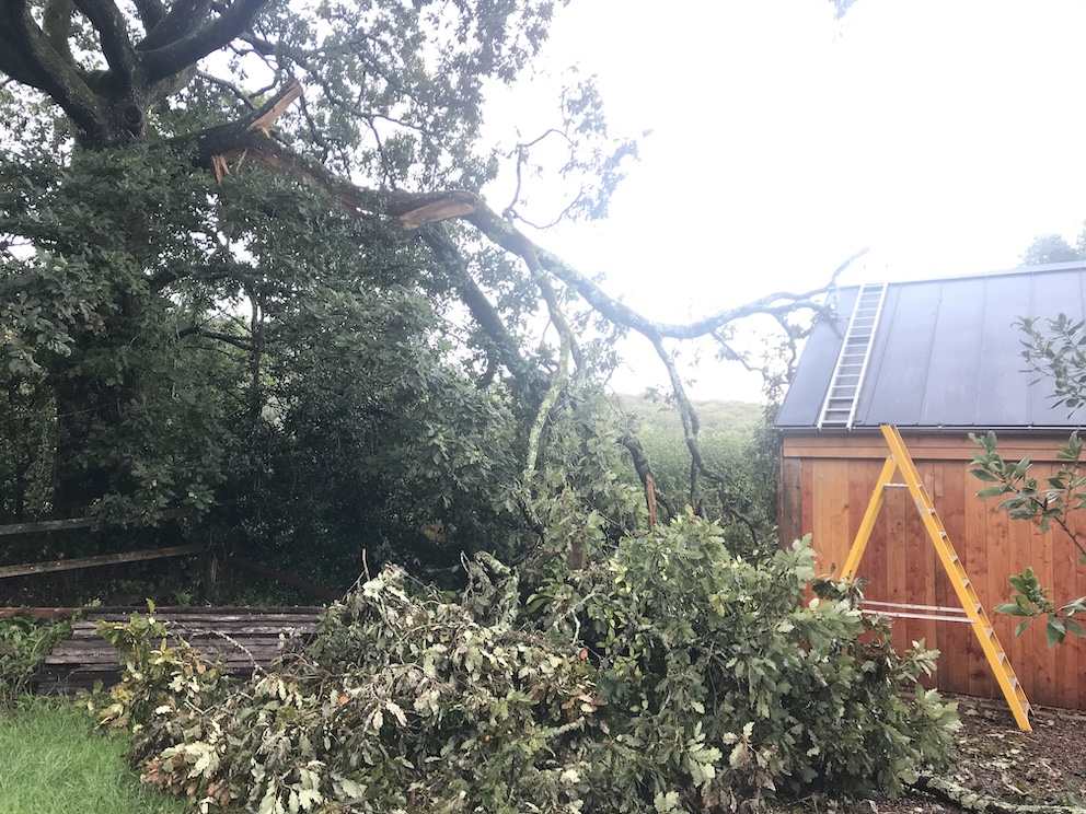

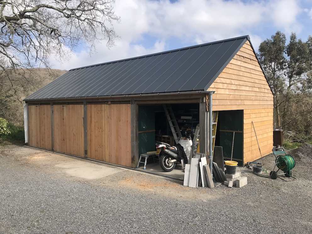

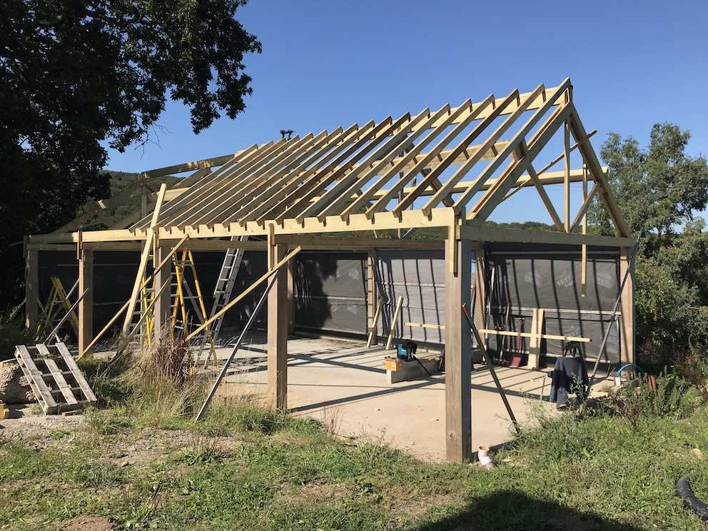

I stick built mine, 12m X 6m. Clad in Douglas Fir.
Had a close shave with the large Oak in September.
Nearly finished.
Nice, I like this a lot
