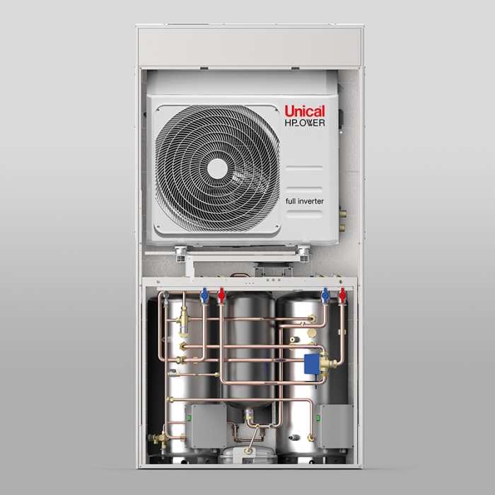

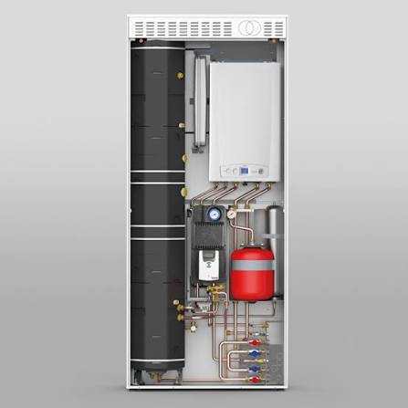

Here something someone invented about 11-12 years ago - Unical
Gas boiler version
ASHP version
