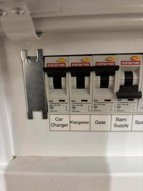

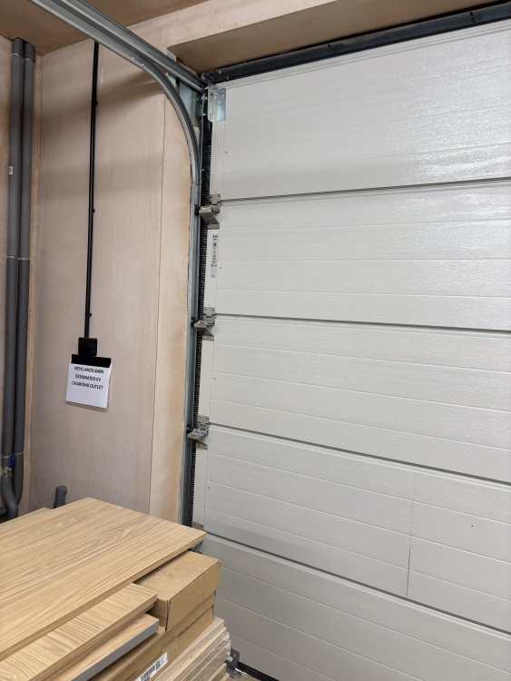

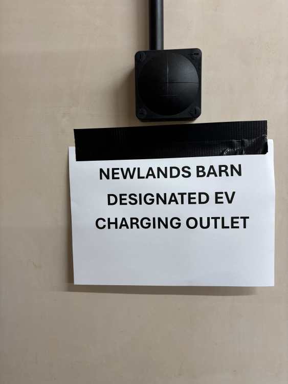

April 28Apr 28 car charger (not a piece of paper) is a planning requirement for us. It has to be a proper charger not a socket.

April 28Apr 28 2 hours ago, -rick- said: It may be that you've got caught out here and didn't initially plan on installing the charger and now getting people back to do so is expensive No that's an inaccurate assumption. I knew from the outset that an EV charger was required. My sparky did indeed run a suitable cable from the consumer unit out to an outside wall. This was part of his overall fee of course. This also happens to be the part of the EV installation requirement that i believe is reasonable to be mandated for the potential benefit of whoever may come after me. It still leaves almost £600 for the unit itself which i maintain is not reasonable as a gift to someone else.
