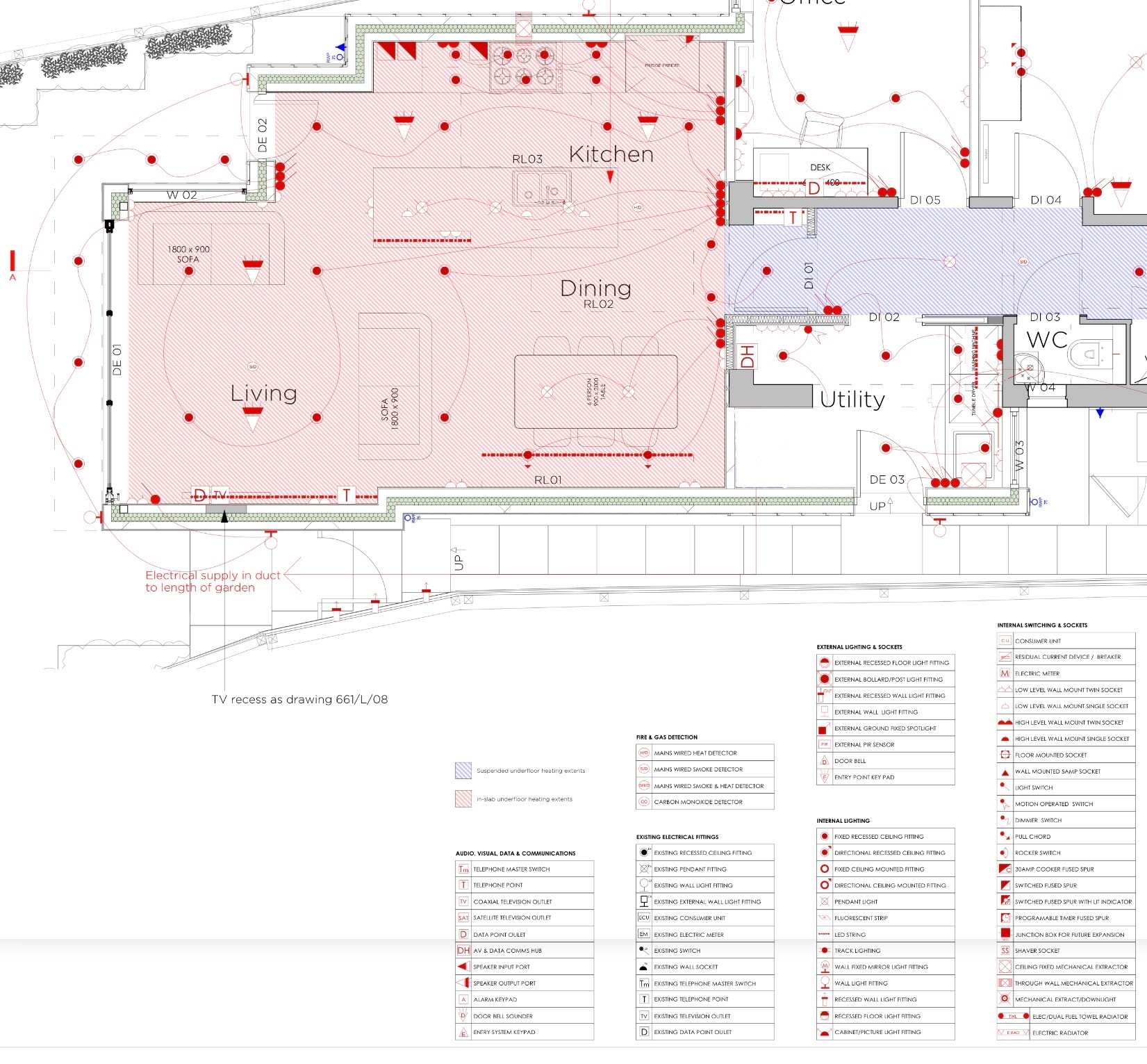

Spinny Posted April 8 Posted April 8 (edited) Extract from a tender drawing attached. Not sure where the list of symbols comes from. We marked up a drawing ourselves with what we thought we wanted having been told there would need to be an electrical plan to quote against. Our architect, and I guess many, did not offer any kind of lighting design service. Architect did put us in touch with an M&E specialist that I had a chat with but ultimately decided to do without. He seemed to cover the full monty of building M&E from a full life cycle perspective, i.e. considering maintenance as well as design and install. e.g. How are you going to clean your rooflights if you have a roof you cannot stand on, and no window to climb out onto the roof from ? As said above the plan tends to change with first contact with the enemy, but as with the military only a fool has no plan and it is the planning process that counts and helps as you see the shell and make changes. We ended up with our own directly contracted sparky and his quote had a cost per switch/socket type breakdown, but in the end it got messy and we just paid him as we went on a time and materials basis. BIG TIP - Make sure you marry up your lighting plan with the structural engineers beam and joist plan. I think almost no-one does this, we didn't. But you can't put a downlight into a steel beam, or a ceiling speaker into a joist etc. Can get bloody complicated staring up at the actual beam and joist layout and trying to work out how the hell you can distribute your lights sensibly. Got the chippy to modify some joist work to make room for lights over the worktop. Had a LOT of seperate lighting circuits and switches and roughly twice as many downlights as attached. Made my own numbered list of lighting circuits and stuck a square or oblong of alu tape on the wall where we wanted them with circuit number for each switch. I think lighting is difficult - lumens/sqm, beam angle, colour temperature, CRI, circuits, layout, dimming, CCT, baffles, plaster-in, led tape. PS don't forget garden lighting. Edited April 8 by Spinny 1
mjc55 Posted April 8 Posted April 8 electrical symbols are a fairly standard set of symbols. My Architects Pocketbook lists them and they were what I used when I did my drawings as an Architectural Technologist. 1

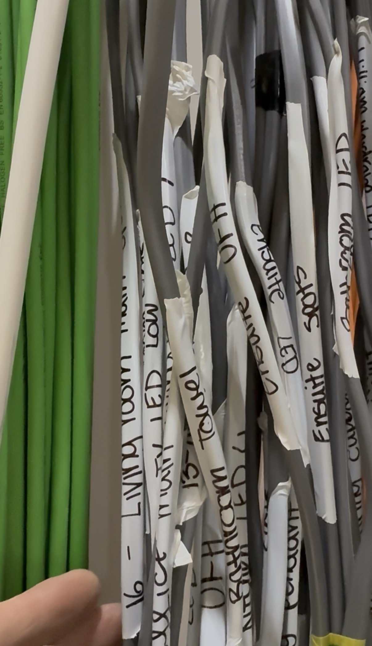

Alan Ambrose Posted Sunday at 10:32 Posted Sunday at 10:32 Not sure that Mike's example leaps off the page, but it's a lot better than zilch. I'm planning on labelling the end of the cables with a shrink wrap labeller, which should help a lot - ever found a misc T&E and wondered where it ends up?.
Nickfromwales Posted Sunday at 10:38 Posted Sunday at 10:38 4 minutes ago, Alan Ambrose said: Not sure that Mike's example leaps off the page, but it's a lot better than zilch. I'm planning on labelling the end of the cables with a shrink wrap labeller, which should help a lot - ever found a misc T&E and wondered where it ends up?. Which is where a tone generator comes into it's own. Check for zero volts, check for zero continuity between conductors, then attach the tone set and you'll find the other end in minutes; even gives a feint tone when the cables behind plasterboard. When you find the cable, short out the conductors you put the set onto, and the tone goes silent to confirm 100% that you have the right cable (tone can be induced into adjacent cables when these are grouped). 1

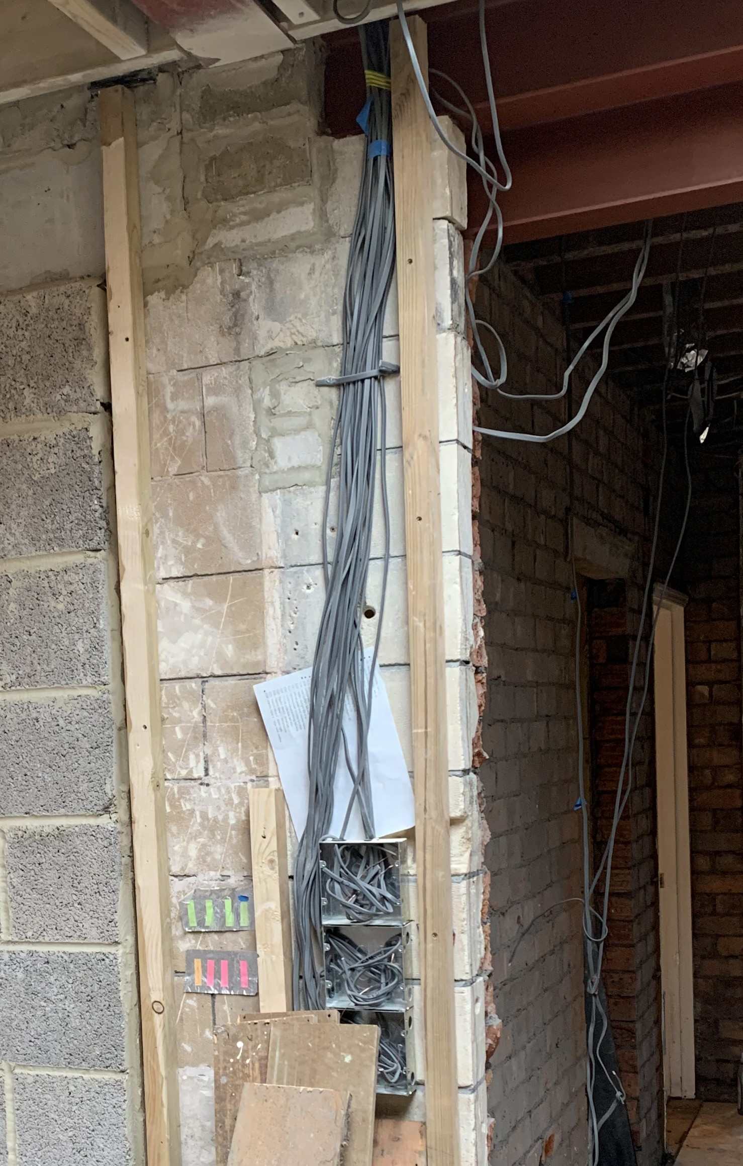

Great_scot_selfbuild Posted Sunday at 15:19 Author Posted Sunday at 15:19 5 hours ago, Alan Ambrose said: Not sure that Mike's example leaps off the page, but it's a lot better than zilch. I'm planning on labelling the end of the cables with a shrink wrap labeller, which should help a lot - ever found a misc T&E and wondered where it ends up?. My wife & daughter have done a cracking job with white elec tape and permanent pen labelling ready for the electrician. They all match up with our floor plans that I’ve annotated on Procreate (iPad app). I plan to label them at the end with dymo tape printed labels, as I have found ‘permanent’ pens are often not what they claim to be 😂. 1

Spinny Posted 15 hours ago Posted 15 hours ago On 23/08/2026 at 12:32, Alan Ambrose said: I'm planning on labelling the end of the cables Yes, my electrician was working with another mate that did most of my first fix. They tend to write on the end of the cable with a sharpie, which can be tricky to read sometimes months later and gets cut off at second fix. I have been sticking coloured labels on speaker and network cables. (Maybe scope for someone inventing a clever labelling gizmo.)
