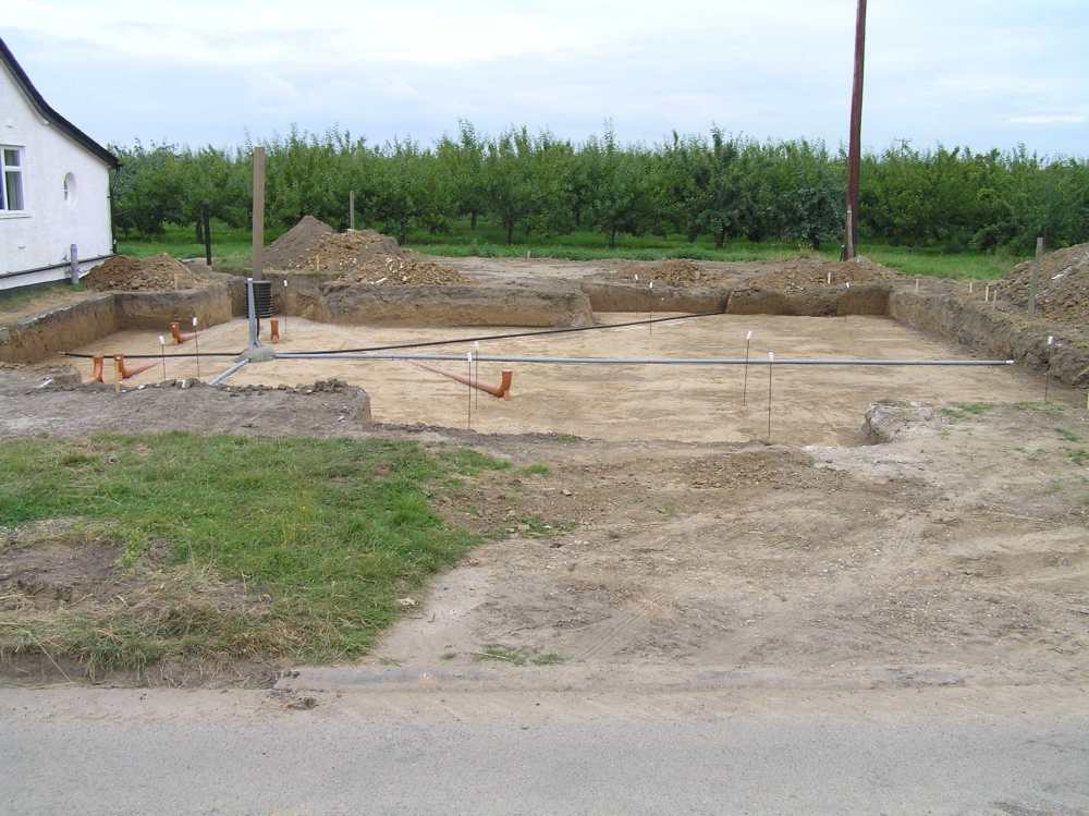

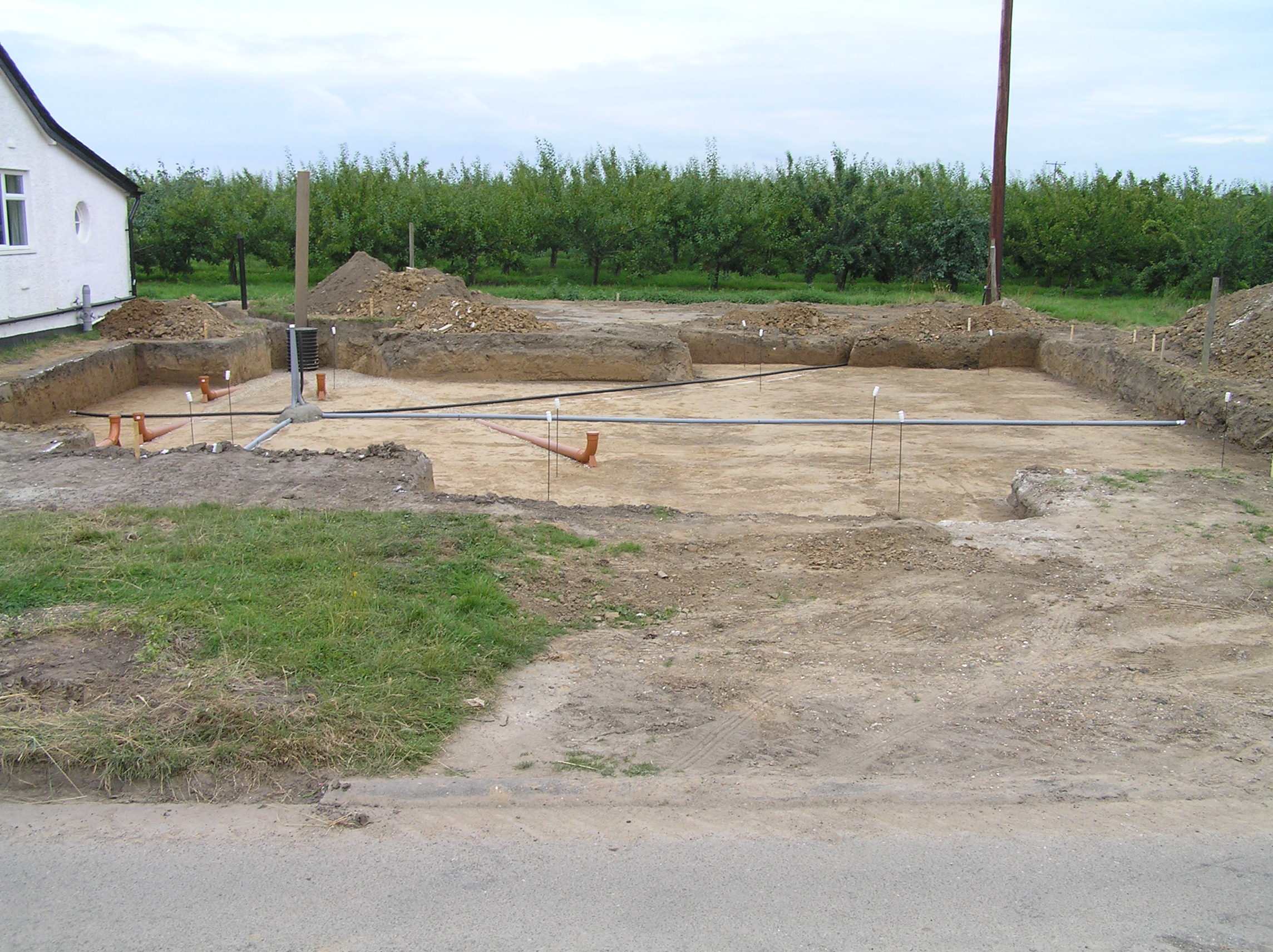

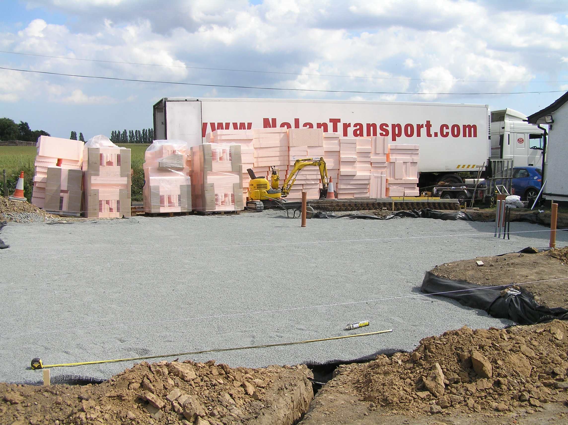

April 3Apr 3 @lizzieuk1 Our insulated raft sat on 250mm compacted type1 with 50mm granite fines on top. The insulation was 300mm thick. The inspection chamber was around 3m from the edge of the raft. The pictures show before and after sub-base was laid.
April 3Apr 3 Our soil pipes are in the compacted type 803 and sand blinding. A 1m length close to one of the stack foots comes up about 20-30mm into the 250mm insulation.
