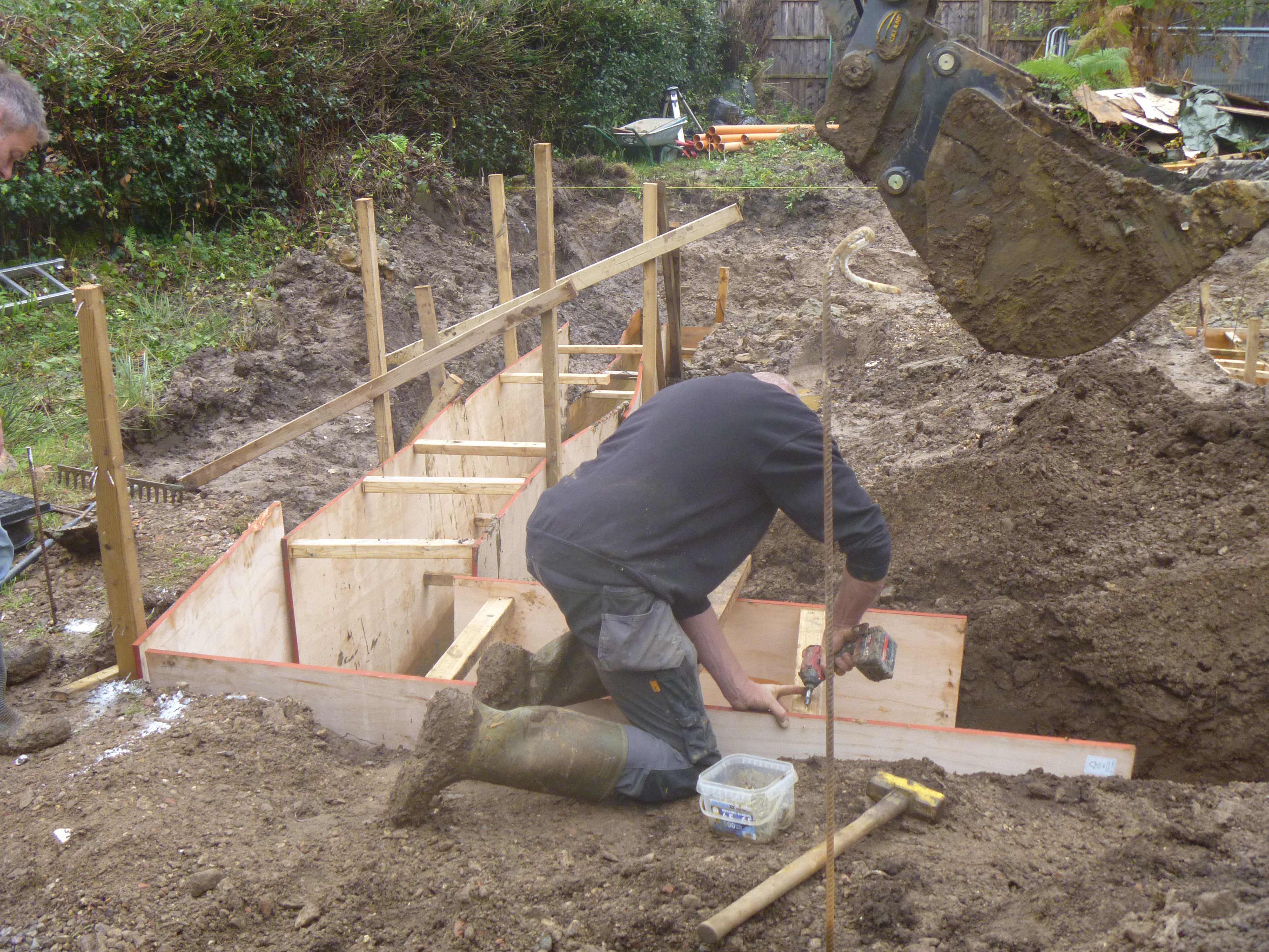

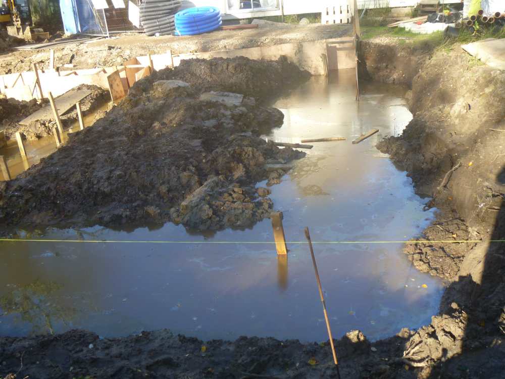

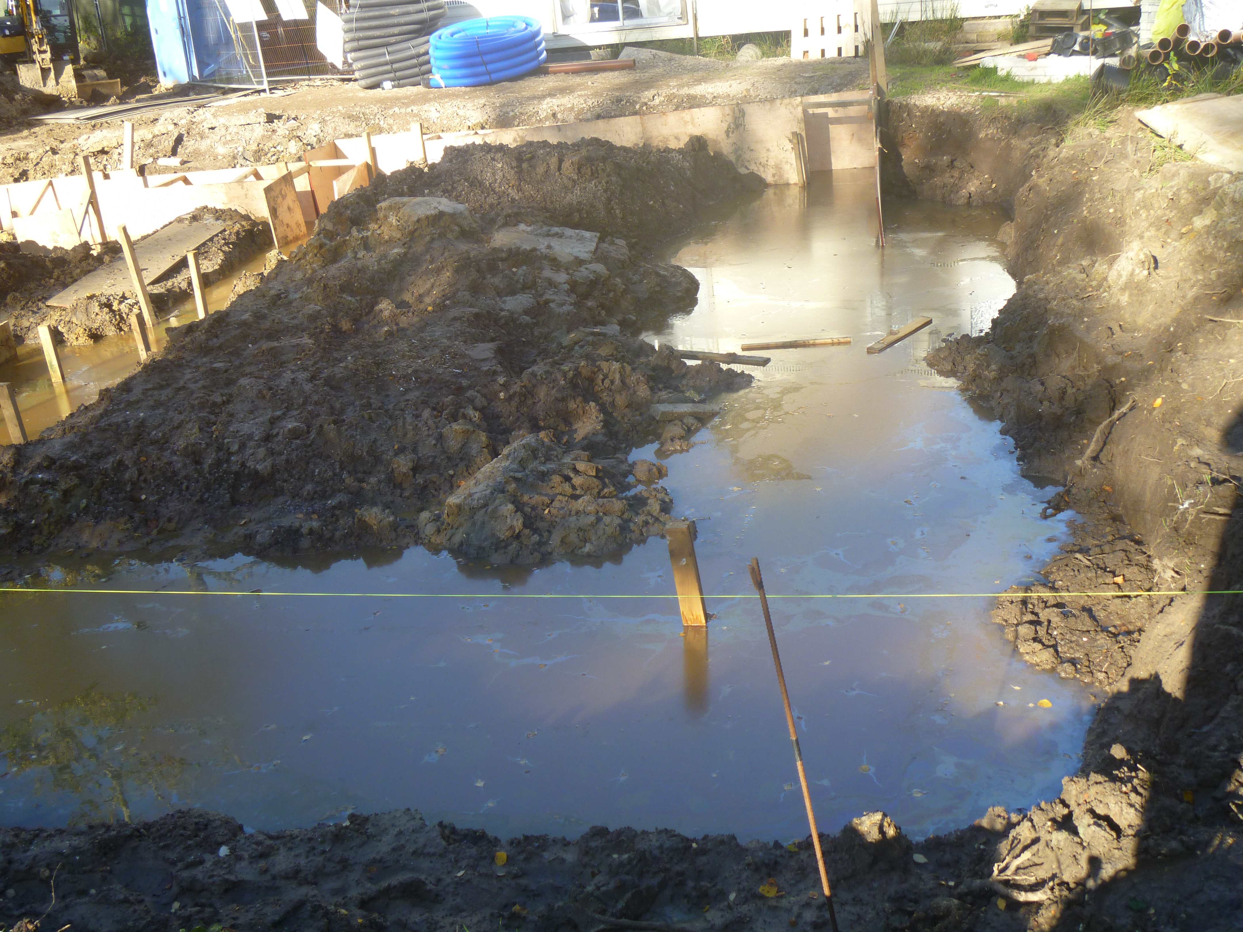

March 8Mar 8 Perhaps it may be OK if your ground type drains quickly, your water table is low & your foundations are not so deep as mine, but having had experience of problems digging foundations after wet weather, I definitely wouldn't be doing it in my locality this week or next. Here's a picture from just after we started pulling the foundations. Shuttering was required to prevent the trenches from collapsing. 2nd picture is the same trench, with the picture taken from the other end. it didn't rain in between - it took the water 2 days to come up to water table level. Perhaps you should dig a test hole, then wait two days to see what happens. Edited March 8Mar 8 by Tony L

March 8Mar 8 Author 16 minutes ago, Tony L said: Perhaps it may be OK if your ground type drains quickly, your water table is low & your foundations are not so deep as mine, but having had experience of problems digging foundations after wet weather, I definitely wouldn't be doing it in my locality this week or next. Here's a picture from just after we started pulling the foundations. Shuttering was required to prevent the trenches from collapsing. 2nd picture is the same trench, with the picture taken from the other end. it didn't rain in between - it took the water 2 days to come up to water table level. Perhaps you should dig a test hole, then wait two days to see what happens. Ouch. That looks like a world of pain.
