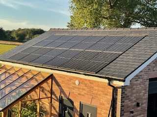

I have panels in GSE trays on both side of my garage.
Rather than have a row or rows of slates at the bottom of the panels , we used a verge tray and the rain runs off the  lower panels direct into the gutter.
Makes life simpler.
