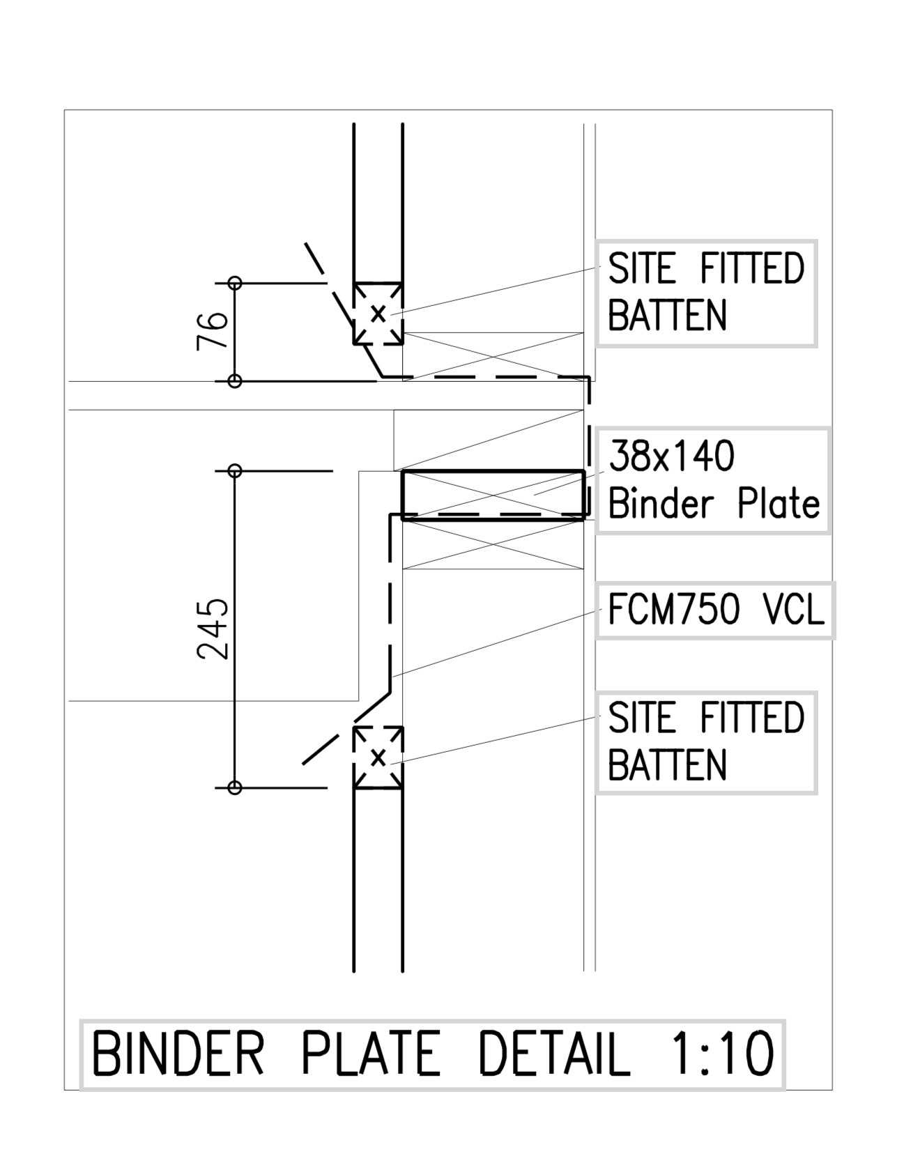

Question?
I’m looking at this detail in the drawings and noticed the ‘site fitted batten’ I can’t see this but also wonder if it’s necessary as looks horizontal which would surely block the service cavity created by the vertical battens. Given it’s in the eaves I may not need the service cavity. What’s not shown in the drawing is the ybs super quilt under the vertical battens.
I’m probably missing something obvious 🙄
 Sorry I haven’t got any actual photos as not on site at the moment.
Forgive me if I’m being more thick than usual, but is that a cross section detail of the joist/downstairs panels/ upstairs panel junction?

It is normal to have a top and bottom bar to a service void.  Drill or leave a notch where you know services will pass thtough
Yes cross section of ground floor to first floor junction

Shouldn't the VCL finish behind the battens? If they're service battens, or is there additional insulation going in between?
Yes good point… I was planning on lapping up under the ybs superquilt and taping together so would need to do that before adding horizontal batten presumably.

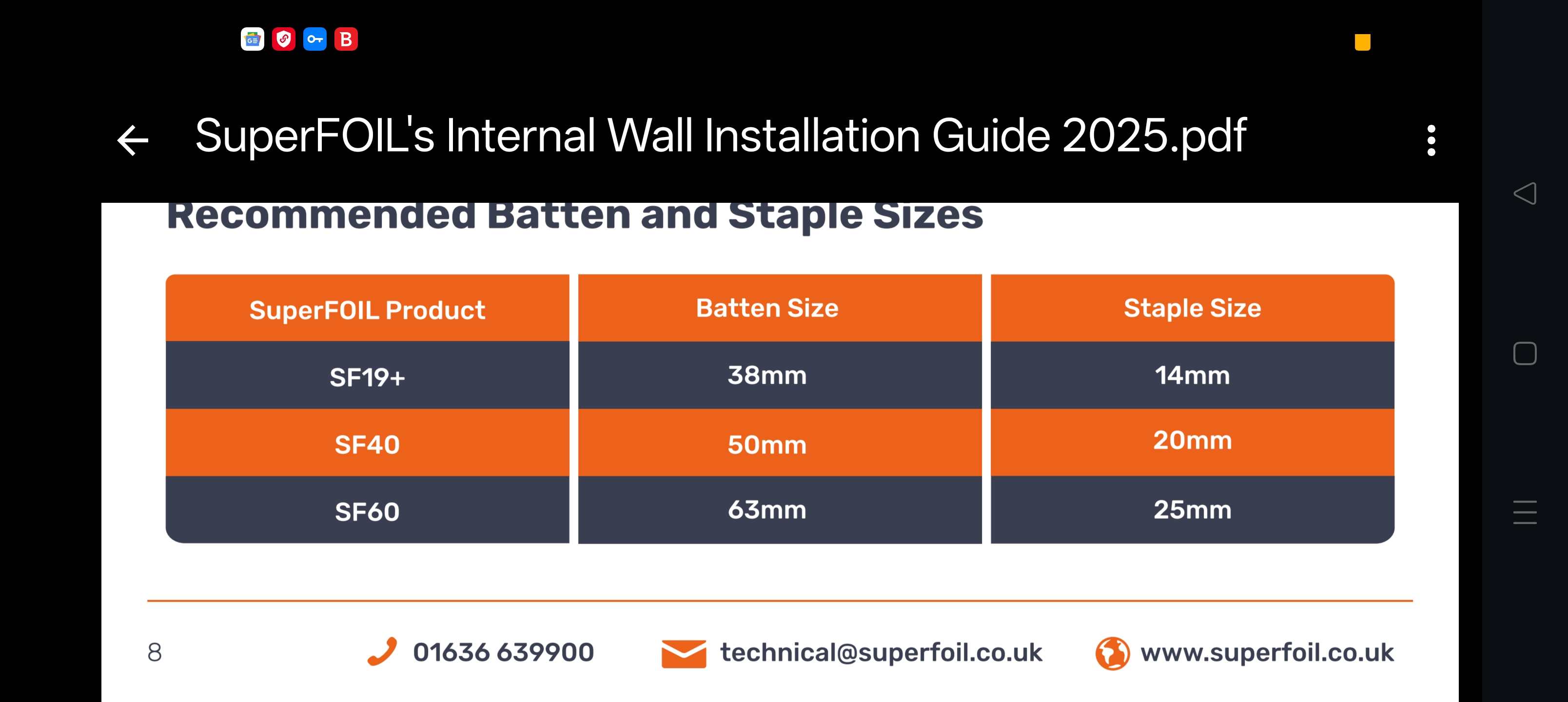

Nothing particularly wrong with multifoil, but it needs to be used correctly and have the correct airspace either side of it, which is often not built-in. I wouldn't use in isolation, but with other insulation. But when you take into account the correct air spaces either side, it doesn't save any space, compared to mineral wool

So do you have suitable air gaps either side of the super foil? You need these sizes of battens either side to get the performance advertised.
