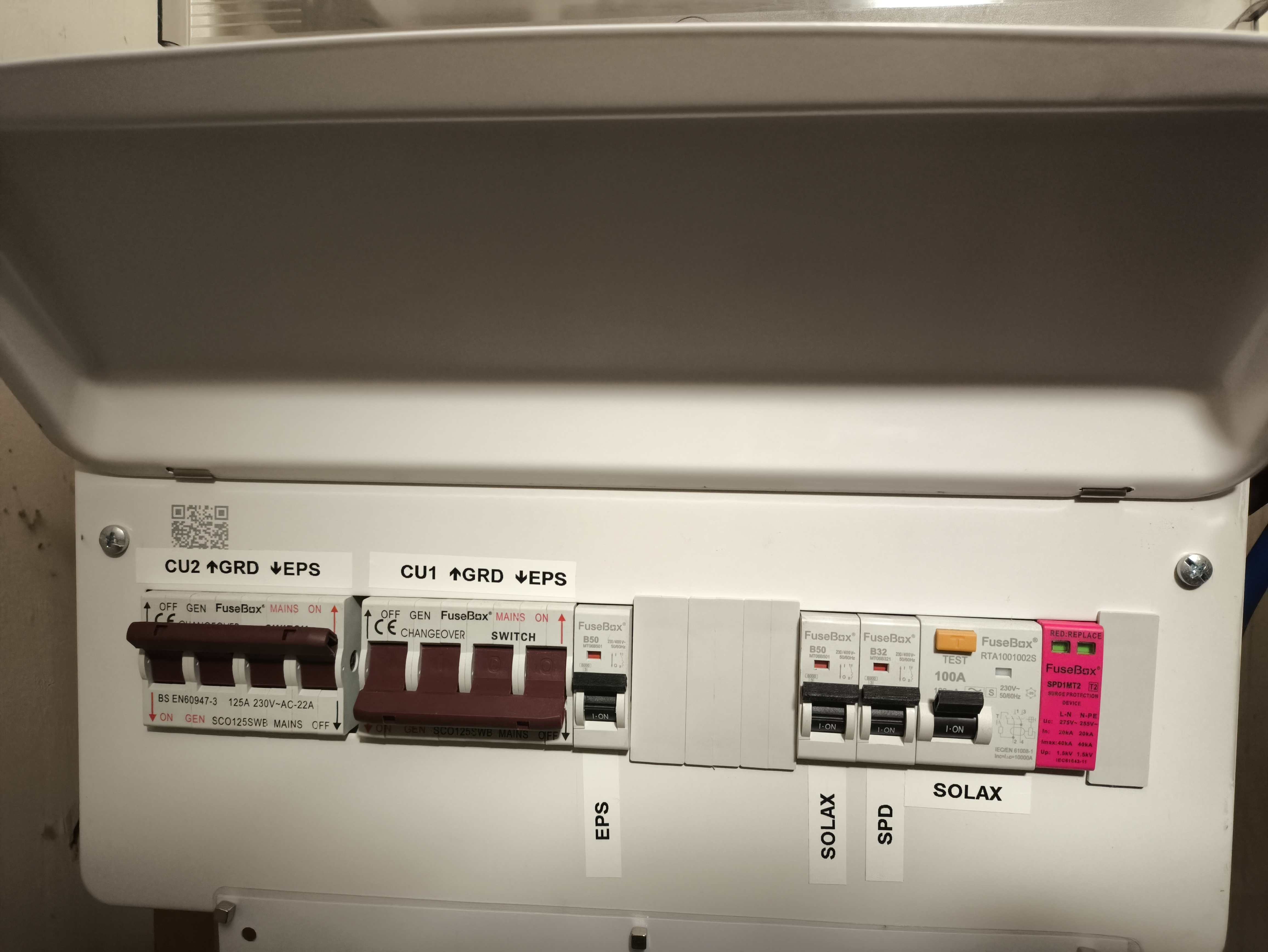

Dillsue Posted 2 hours ago Posted 2 hours ago I think the grid disconnect is done within the inverter as it is with G98/G99 so no external changeover/disconnect needed?? In the second schematic the "on grid home load" will be dead in a power cut and the "load" will be live, fed from the batteries or generator. If the inverter can't sense a stable grid connection it keeps itself disconnected with internal contactors?? In terms of installers knowing the requirements for backup power supplies/generators, are they actually covered in the wiring regs to the level that the regs spell it out in black and white and every spark would know exactly how to wire things?? I've always understood it to be a bit of a grey area??
Nickfromwales Posted 2 hours ago Posted 2 hours ago 24 minutes ago, Dillsue said: I think the grid disconnect is done within the inverter as it is with G98/G99 so no external changeover/disconnect needed?? In the second schematic the "on grid home load" will be dead in a power cut and the "load" will be live, fed from the batteries or generator. If the inverter can't sense a stable grid connection it keeps itself disconnected with internal contactors?? In terms of installers knowing the requirements for backup power supplies/generators, are they actually covered in the wiring regs to the level that the regs spell it out in black and white and every spark would know exactly how to wire things?? I've always understood it to be a bit of a grey area?? Half or more of resellers in the solar trade don’t know, so it’s defo a growing concern as PV / batts / EV / paid export as a working combo is defo on the rise.
jimseng Posted 1 hour ago Author Posted 1 hour ago 35 minutes ago, Dillsue said: I think the grid disconnect is done within the inverter as it is with G98/G99 so no external changeover/disconnect needed?? In the second schematic the "on grid home load" will be dead in a power cut and the "load" will be live, fed from the batteries or generator. If the inverter can't sense a stable grid connection it keeps itself disconnected with internal contactors?? That is correct, although I am going to have a manual changeover in the event of a long term power cut so I can include the heavier, grid side loads if I need to. 13 minutes ago, Nickfromwales said: Half or more of resellers in the solar trade don’t know, so it’s defo a growing concern as PV / batts / EV / paid export as a working combo is defo on the rise. I have found that so many installations are retro fitted and the backup load side is ignored and the information is therefore limited for people like me installing into a new build. I guess the costs of rewiring to new DBs is prohibitive. Often there seems to be a couple of sockets to charge mobile phones on the load side.
Nickfromwales Posted 1 hour ago Posted 1 hour ago 13 minutes ago, jimseng said: That is correct, although I am going to have a manual changeover in the event of a long term power cut so I can include the heavier, grid side loads if I need to. You can do this off the shelf, and as long as you’re not using the induction hob and a 10.5kW electric shower then the inverter will cope whilst you start running around shutting off these big loads. Wouldn’t need the manual changeover then (which is a bit Fred Flintstone nowadays ).

Dillsue Posted 59 minutes ago Posted 59 minutes ago 37 minutes ago, jimseng said: That is correct, although I am going to have a manual changeover in the event of a long term power cut so I can include the heavier, grid side loads if I need to. Just check the max power available on the back up output will power the "heavier" loads. The Solis unit I'm thinking of using is a max of 5kw on the back up output so would need a bit of manual load management if we wanted to cook in the winter with the HP running
