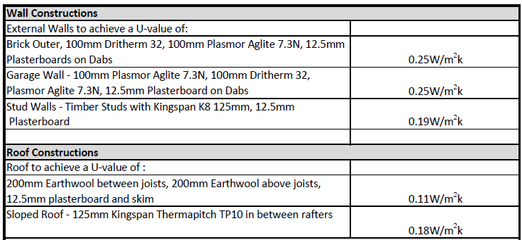

iMCaan Posted January 28 Posted January 28 I hope this thread is in the correct section. Hi The company that is doing our house as built SAPs as asked me to sign and return Part L1A 2013 Specification to sign off the dwelling, see attached. My concern is we didn't use as much insulation as stated on the form for walls (stated 100mm but used 50mm PIR) and floor (stated 150mm but used 100mm PIR for UFH). Therefore, the house won't achieve the stated u-values. Any suggestions as to what to do? We are ready to move in. Should I be concerned? Oh boy this feels bad but I must ask, should I sign it as stated should I amended it then sign it? What are the consequences? Thanks

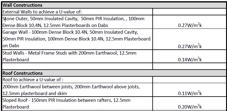

iMCaan Posted January 28 Author Posted January 28 Yeh we used 50mm pir insulation in walls. The cavity walls were 300mm with in total (100mm blocks, 50mm PIR insulation, 50mm cavity and 100mm stone). 100mm PIR insulation on ground floor for UFH. 25mm PIR insulation for first floor UFH. 200mm earthwool between joists. 400mm earthwool above joists. 150mm PIR insulation for slopped roof.
saveasteading Posted January 28 Posted January 28 That's not bad insulation. the first floor insulation is irrelevant too the rating. 600mm earthwool to roof? really? and 150mm PIR to the rest of the roof. I dont have figures to hand but that might pass.

iMCaan Posted January 28 Author Posted January 28 For clarity...We have two attic rooms. In the eaves (unusable space), it's 200mm earthwool in joists. The vertical and slopped wall of the attic rooms are 150mm PIR boards. There's some unusable space on top of the attic room ceiling and that has 400mm earthwool. Within all cavity walls, it's EcoTherm 50mm PIR board insulation.

ADLIan Posted January 28 Posted January 28 The SAP assessor will rerun the calculation with the revised insulation details. Hopefully all will be OK if some flexibility built into the design otherwise they should advise on options to get a pass (improved air test number?). I don't think photo evidence was required under the old, 2013, version of Appr Doc L.

iMCaan Posted January 30 Author Posted January 30 See as design and as built images attached. It doesn't appear to be a big difference in u-values or is it?
ADLIan Posted January 30 Posted January 30 SAP is not particularly sensitive to elemental U-values so hopefully OK - only your SAP assessor can give a definitive answer

Redbeard Posted January 30 Posted January 30 Re the sloping roof, unless they guessed it wrong 1st time (design U value), all other things being equal (which perhaps they are not*)I cannot fathom how they get a worse U value with 150 (as-built - apparently 0.2W/m2K))than with 125mm (stated as 0.18). *Much closer rafter centres and fatter rafters (therefore larger timber fraction in the calc) in as-built than design? On 28/01/2026 at 12:25, iMCaan said: After 5 years, we just want to move in. So this is to the pre-2022 Regs, then?
