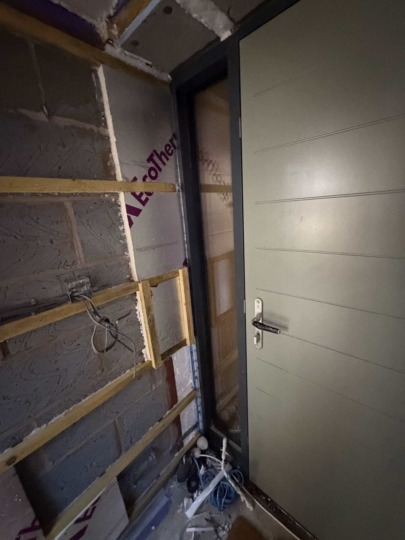

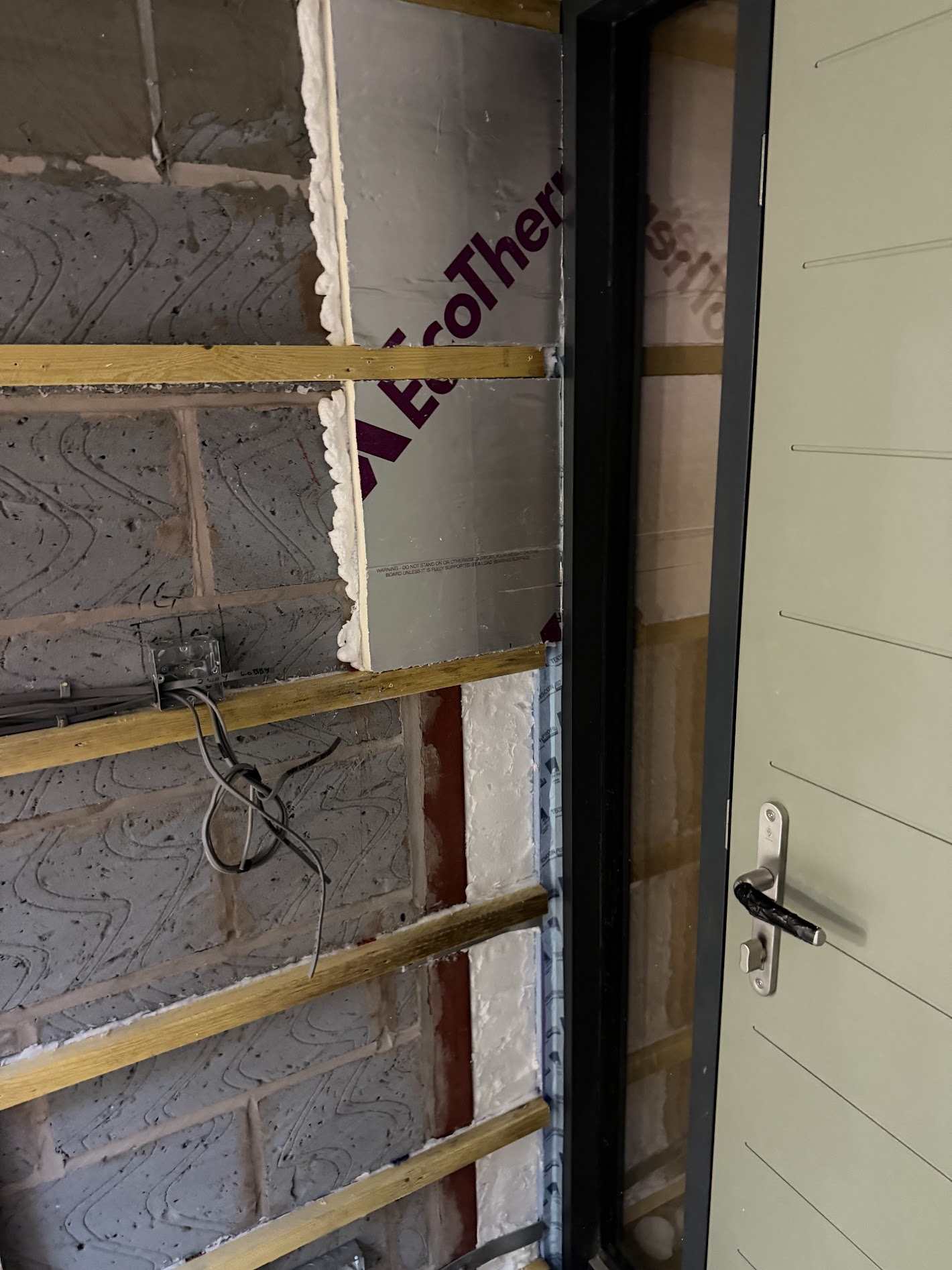

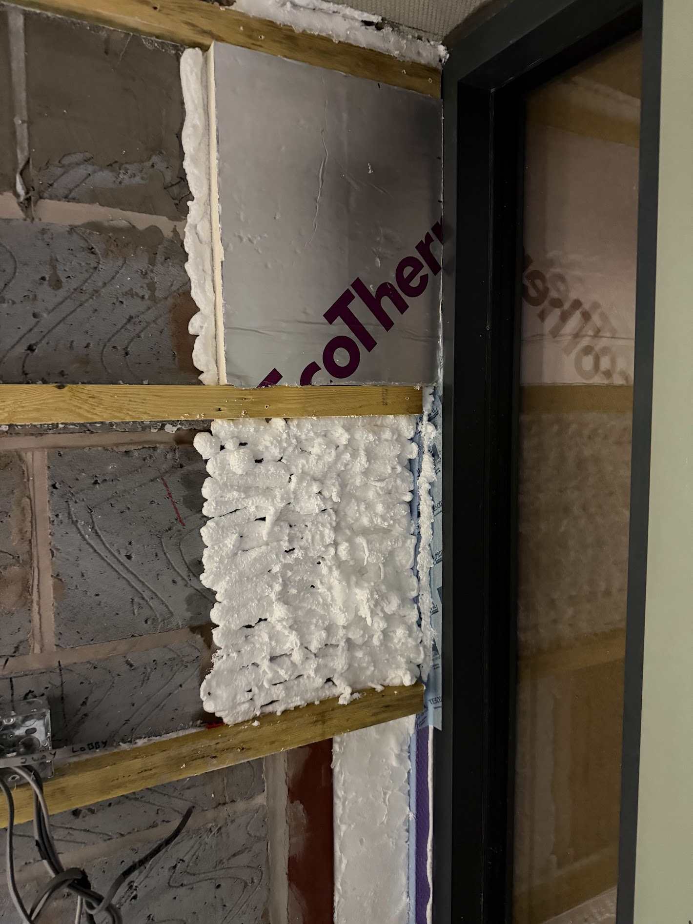

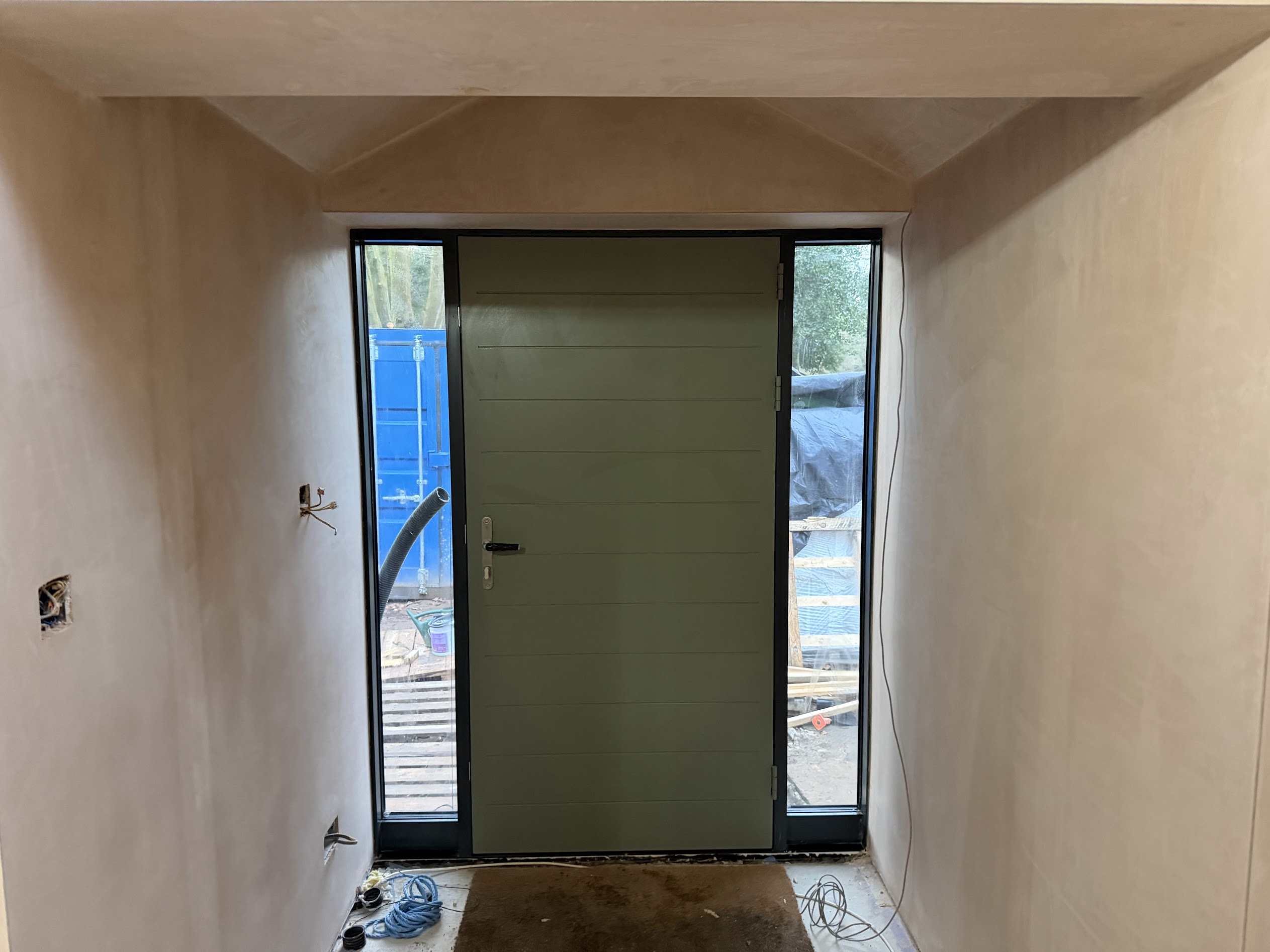

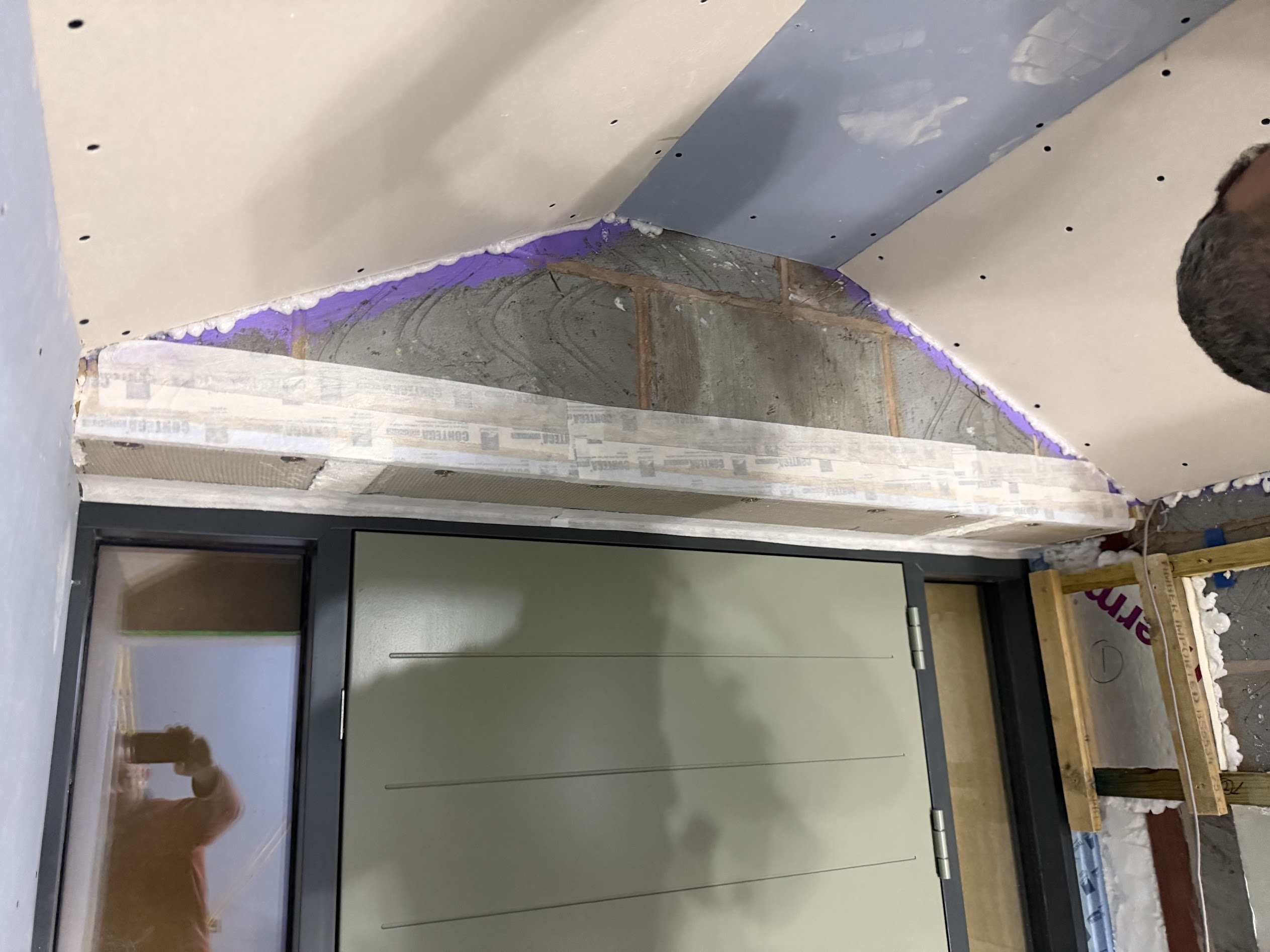

January 27Jan 27 Hello folks! I have gone to fairly extreme lengths to make sure sound doesn't come into my property which included buying Norrsken triple glazed windows / slider / front door. I have filled literally every gap you could imagine in the property. However my front door is like a massive amplifier. Its actually noiser with it closed than open. See attached video show the problems and some pictures of the detailing around the door, but I would love some advice. I believe that if I had simply gone for a glazed door as per my windows I wouldn't be hearing this sound. I have gone back to Norrsken support and waiting on a response. The sound is absolutely coming directly through the leaf of the door the surrounds and roof is silent.
January 27Jan 27 That's a weird one. I have an aluminium door and it definitely doesn't transmit sound like this. It sounds like air coming in/out of a small gap, which may explain why it goes away when the door is open. Try burning a few matches near the door and see if the smoke gets sucked/blown from anywhere. Do you have MVHR? That could cause negative pressure and a whistling sound from sucking in air through a gap.
January 27Jan 27 Author MVHR isn't running yet I've taped fully around the edges with masking tape and also ran a piece of paper all the way around with it shut. It's tight everywhere. It just sounds like it's coming right through the leaf. Also if you knock on it, it almost sounds hollow

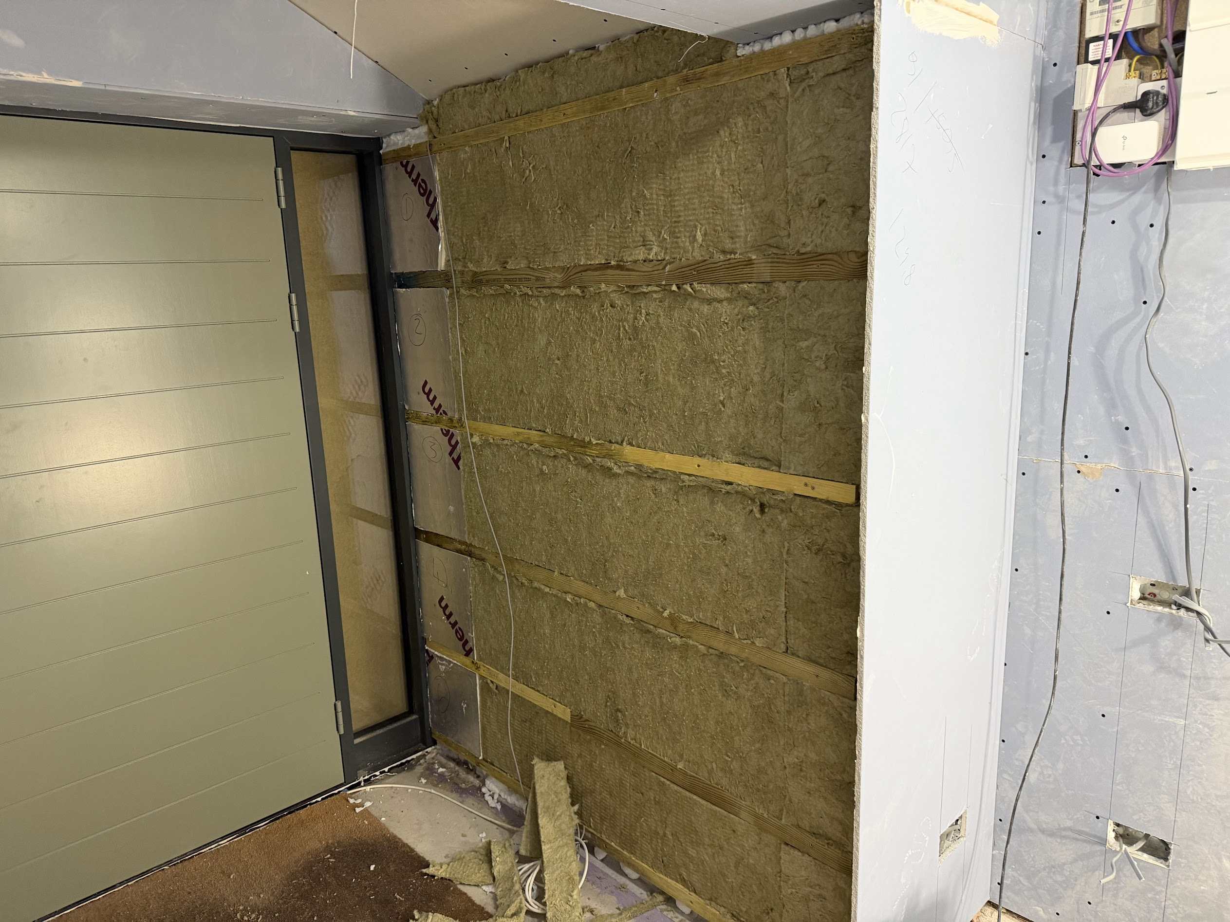

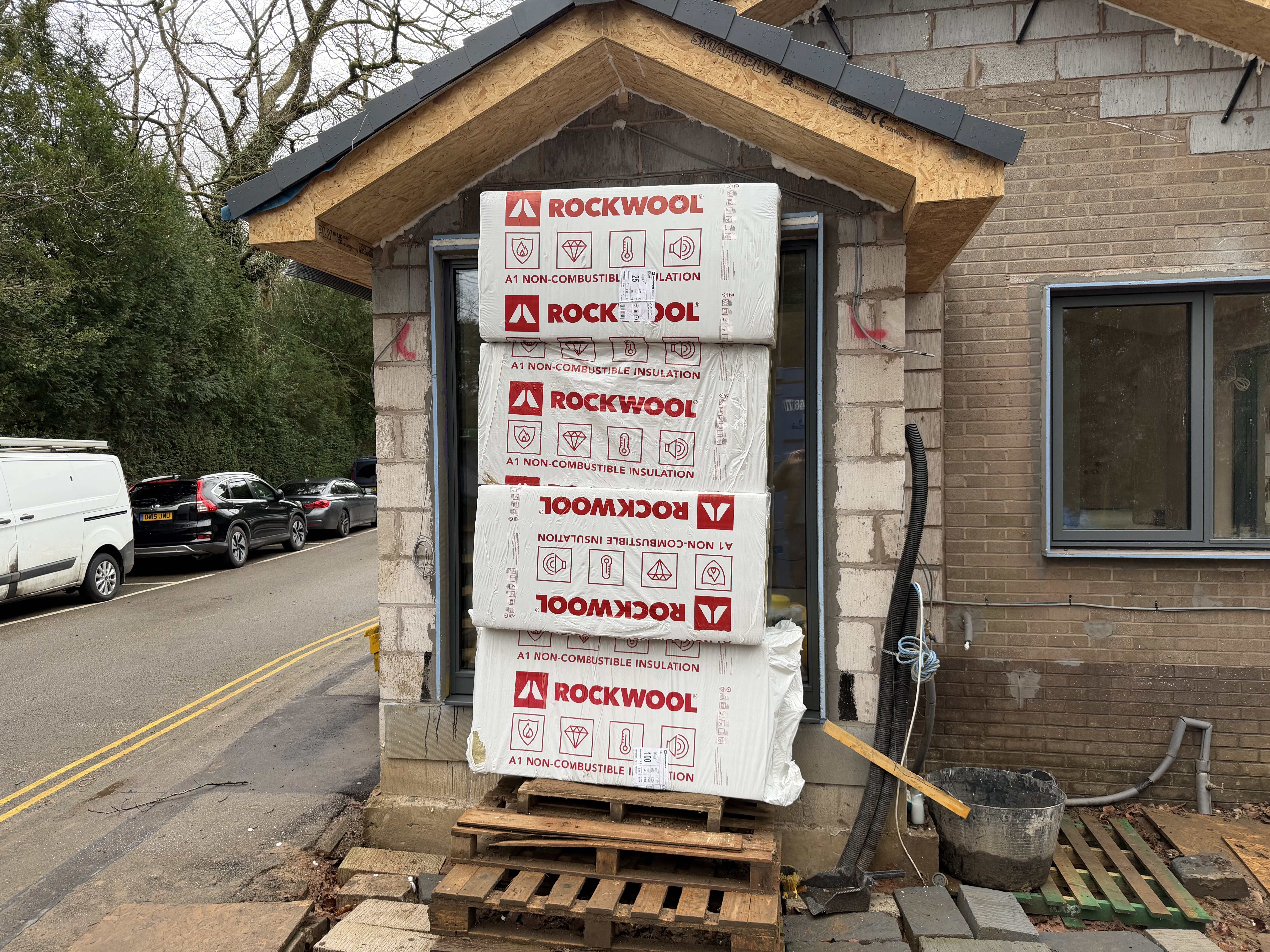

January 27Jan 27 Author With this gently in front of the door. The majorly of the whistle is gone. Even if the door is open it's miles quieter with this random stack of Rockwool
January 27Jan 27 How about taping a polythene dust sheet around the door, then blowing a fan from the other side? Does the door feel heavy or light? Can you remove the door handle, or something, to look inside the door?

January 28Jan 28 20 hours ago, boxrick said: With this gently in front of the door. The majorly of the whistle is gone. Even if the door is open it's miles quieter with this random stack of Rockwool Rockwool is very good at sound attenuation, so no surprise there. You may well find that once the EWI and cladding are completed and everything is properly sealed, the issue will be resolved.

January 30Jan 30 On 28/01/2026 at 10:35, Mr Punter said: Rockwool is very good at sound attenuation, so no surprise there. You may well find that once the EWI and cladding are completed and everything is properly sealed, the issue will be resolved. It might not be the Rockwool absorbing sound though. It could be that it's now blocking wind, or if he's lent it against the door, or could be stopping vibration. New suggestion @boxrick, try taping the grooves in the front of the door. I wonder if they're having a similar effect to when you blow on the rim of a glass and get a whistling sound.

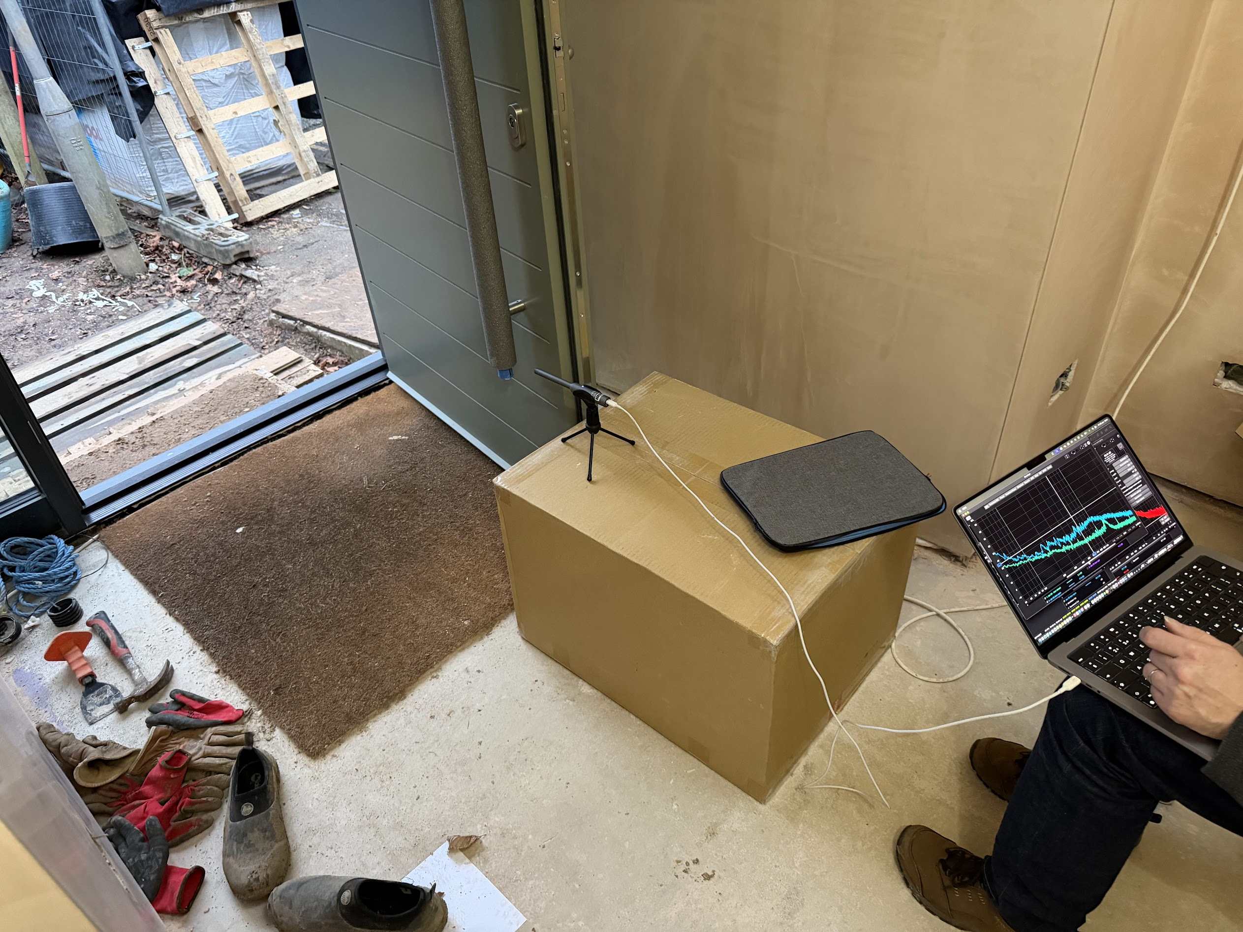

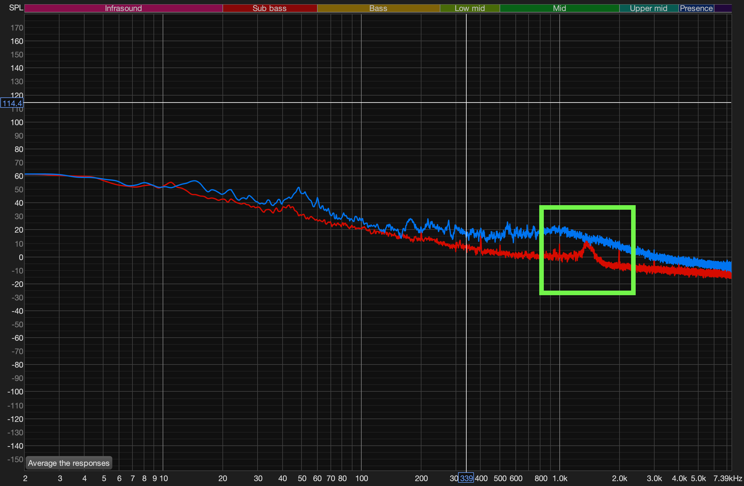

January 30Jan 30 Author My friend brought round a really decent calibration microphone and we measured different scenarios against a baseline. In the 1.5khz range there is basically 0 attenuation. The door is actually rated at 33db in sound reduction. But even the difference between the most drastic sound reduction is well below this. I'll share some graphs shortly. Also as you knock along the skin of the door, some bits are completely dead and others sound completely hollow. I'll share some more info when I'm at my laptop. Edited January 30Jan 30 by boxrick
January 31Jan 31 Author You can see the frequency here which is almost completely unblocked. This is what is leading to the 'whoosing' sound. The blue is fully open and the red is closed. You can hear how hollow the door sounds in the centre, this is where most of the sound is coming through:
January 31Jan 31 check the seals extremely carefully, that kind of peak hints at a small opening in my experience

February 1Feb 1 Thats me sat with the laptop and microphone in front of Rick's door. For anyone stumbling across this in the future please only pay attention to the difference in sound level between the peak of the red line, and the blue line, inside the green box Rick has highlighted. You can certainly say that the door as installed allows 1.3kHz from the road noise outside the house to pass through with very little reduction in sound level for whatever reason. But you can't say much about if the door does or doesn't meet the 33db sound reduction specification at other frequencies. You'd measure that differently. I do agree with Rick that the sound appears to come through the middle of the whole door leaf rather than at the seals - I heard it myself, the video in the first post shows that very clearly.
February 3Feb 3 It’s very unlikely the slab of the door is hollowed, it’s usually a solid slab of PIR with laminated timber either side. A smoke test will indicate where this is occurring. I do not suspect the slab but it can’t be ruled out. It’s usually down to adjustment being required as the door isn’t sealing correctly or it’s coming through the perimeter or through the glazing bead area, which is a possibility. .
