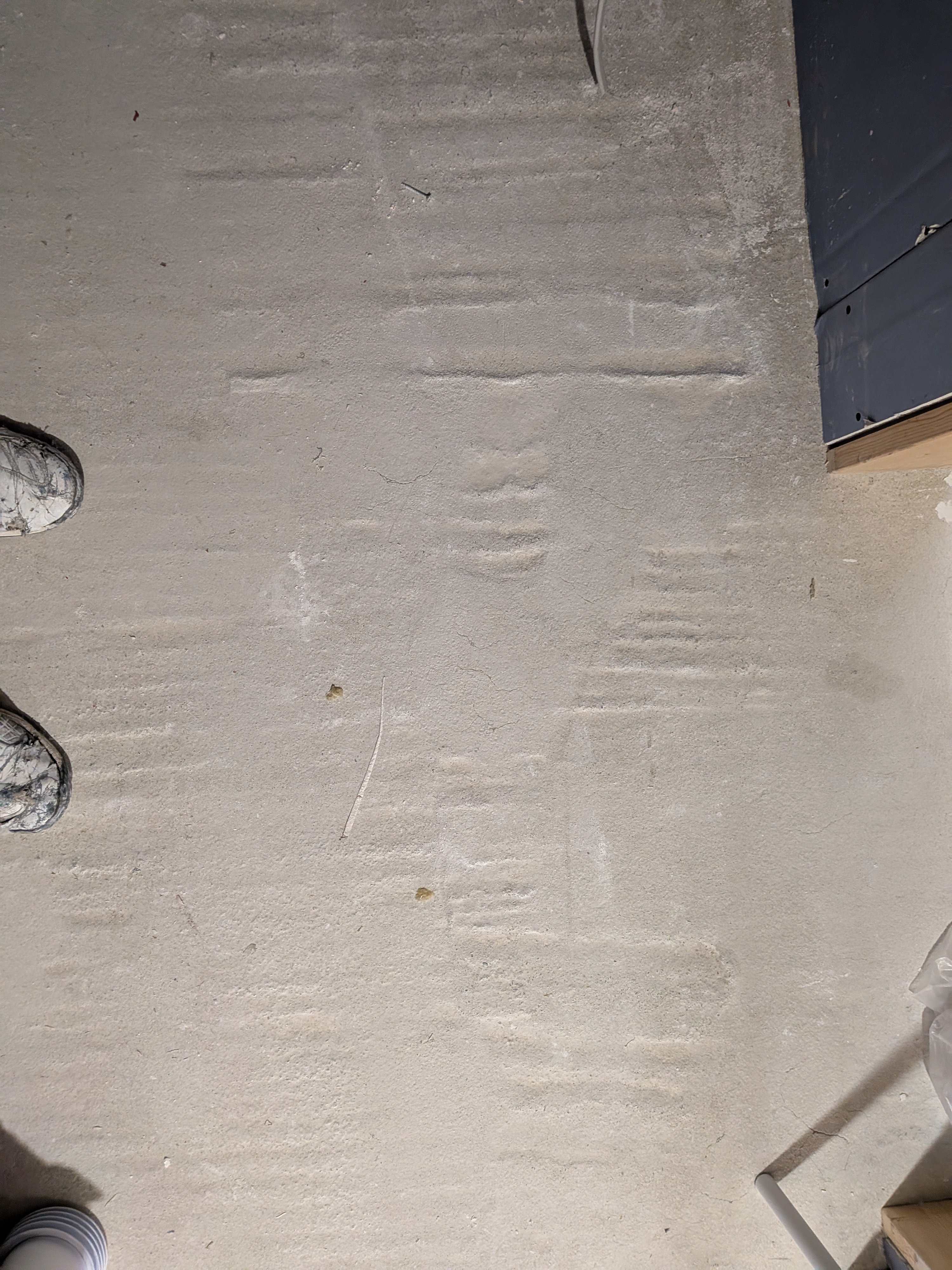

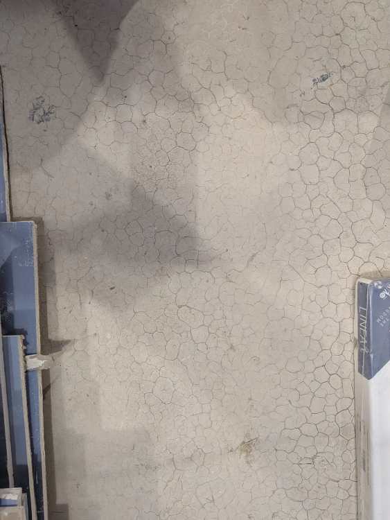

We have a 200mm slab that was poured with self levelling concrete, the result was ok, not great, pictures attached.
I would like a solution to give the appearance of a concrete slab. What would you suggest?
Approx 90sqm to cover.

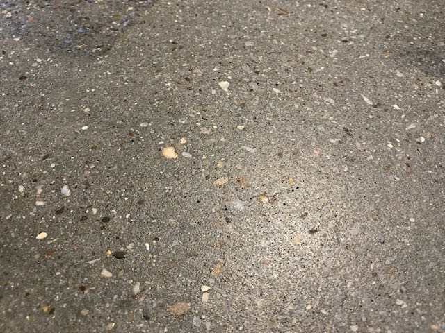

Microcement, or maybe ask a good grinding / polishing company to sample one small room and see what results that yields.
Prep for adding layers to this will need to be robust, and would probably need some amount of grinding. The hope would be, to grind and area and see if it looks ok, then if so repeat throughout.

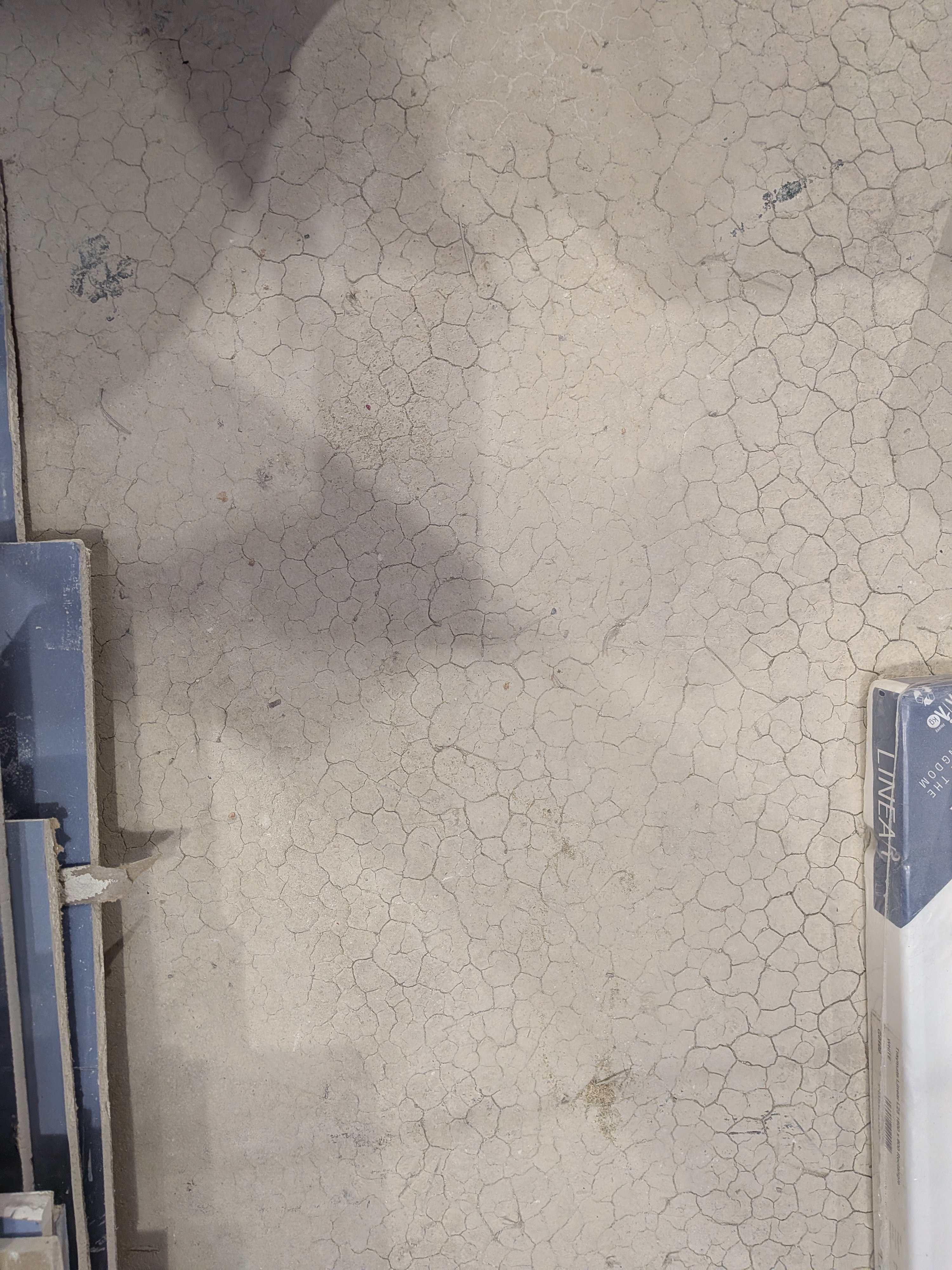

I am pretty sure they have added water to the mix, causing these very visible shrinkage cracks.
If you have the delivery ticket, they will have had to sign an instruction to add water as it absolves the supplier.
It is a common mistake but utterly misguided and you could ask for some recompense.
These cracks will be right through the depth so taking the surface off will not remove them, although the crack widths may reduce. It's possible that only the top few mm was hideously wet and overworked.
Are there contraction joints elsewhere, and what has happened there?
It's ok for any overlay as it won't move again.... unless overworked. I'd try chiselling a bit off the surface to see if it is well bonded to the mass.
Re the tamping ridges, that may not matter for tiling but has to be ground off for anything else.
It's a diy job with a grinder made for the very purpose.... but hard work.

You could also consider grinding down about 20mm into the stone, so you will se the matrix of stone and sand/cement. then you'd have to seal it as it will show stains. Again, this will cost an awful lot.

Yes it was raining when it was poured so the top got too wet.
The self levelling concrete doesn't like that, and as a result it cracked on the surface.
The tamping marks are because it started to go off because the crew doing it weren't very good.
Looks like I will be hiring a grinder and doing the dirty work.

Some of the tamping marks are 10mm high. Theses are hard. Other areas of the surface is quite soft and powdery.
Try a cold chisel or an old screwdriver. I reckon they will bash in a few mm... so it is  soft as far as grinding is concerned.

If you have the time and energy I would recommend you do a test with a grinder.   The grinding discs or pads are the costly part.
I made some concrete worktops with fibres, lots of wet grinding and very pleased with the outcome.
