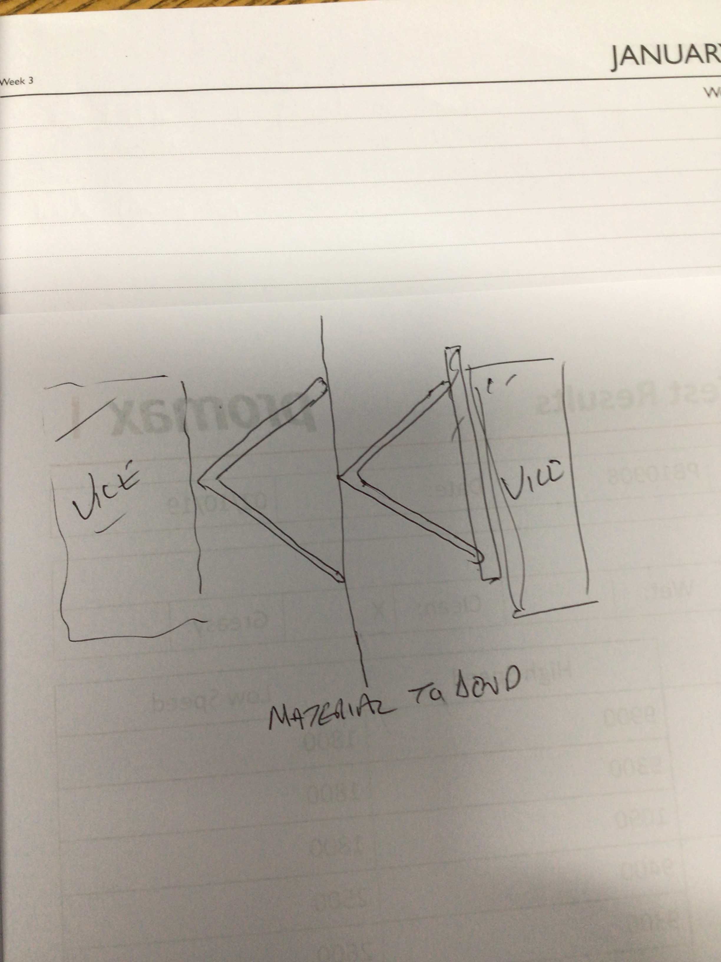

markc Posted 1 hour ago Posted 1 hour ago (edited) At 200mm long you can do it in a decent size vice with 2 pieces of angle to act like a press brake. Bit fiddly to hold until you get vice nipped but it does work. 40x40x3 angle would be upto this. Possibly 25x25 angle as your piece is only 60mm wide Edited 1 hour ago by markc 1
