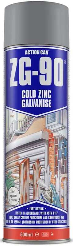

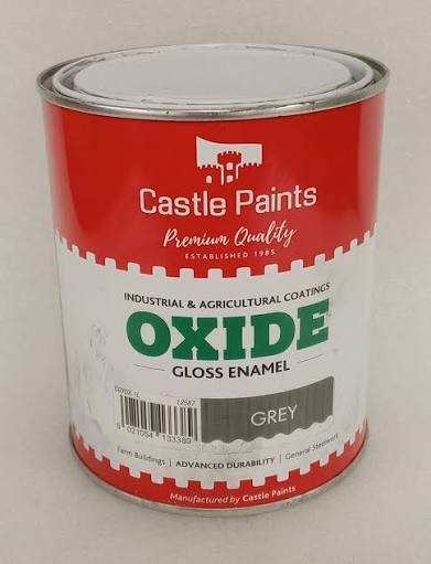

Iceverge Posted 7 hours ago Posted 7 hours ago If it's mild steel I made some brackets recently. Gave them a run of a wire brush on the angle grinder. Then some brake cleaner as a degreaser. Then put them in the oven to get them up to skin temp and dry them out properly. Then 3 coats of zinc primer. Then 3 coats of an enamel oxide brushed on. They're in a fairly corrosive environment so I hope they'll last ok.

Oz07 Posted 4 hours ago Posted 4 hours ago 2 hours ago, Iceverge said: If it's mild steel I made some brackets recently. Gave them a run of a wire brush on the angle grinder. Then some brake cleaner as a degreaser. Then put them in the oven to get them up to skin temp and dry them out properly. Then 3 coats of zinc primer. Then 3 coats of an enamel oxide brushed on. They're in a fairly corrosive environment so I hope they'll last ok. Let's hope OP has a commercial bread oven to hand 🤣

Iceverge Posted 2 hours ago Posted 2 hours ago 2 hours ago, Oz07 said: Let's hope OP has a commercial bread oven to hand 🤣 Lol. I did actually stick them in the kitchen oven pre zinc coat . Cautious of off gassing pre top coat and fearing the wrath of my family I just stuck them into a cardboard box with a small fan heater (closely supervised!!!!) for 15mins. Seemed to do the trick, they only need to be warm and dry.
