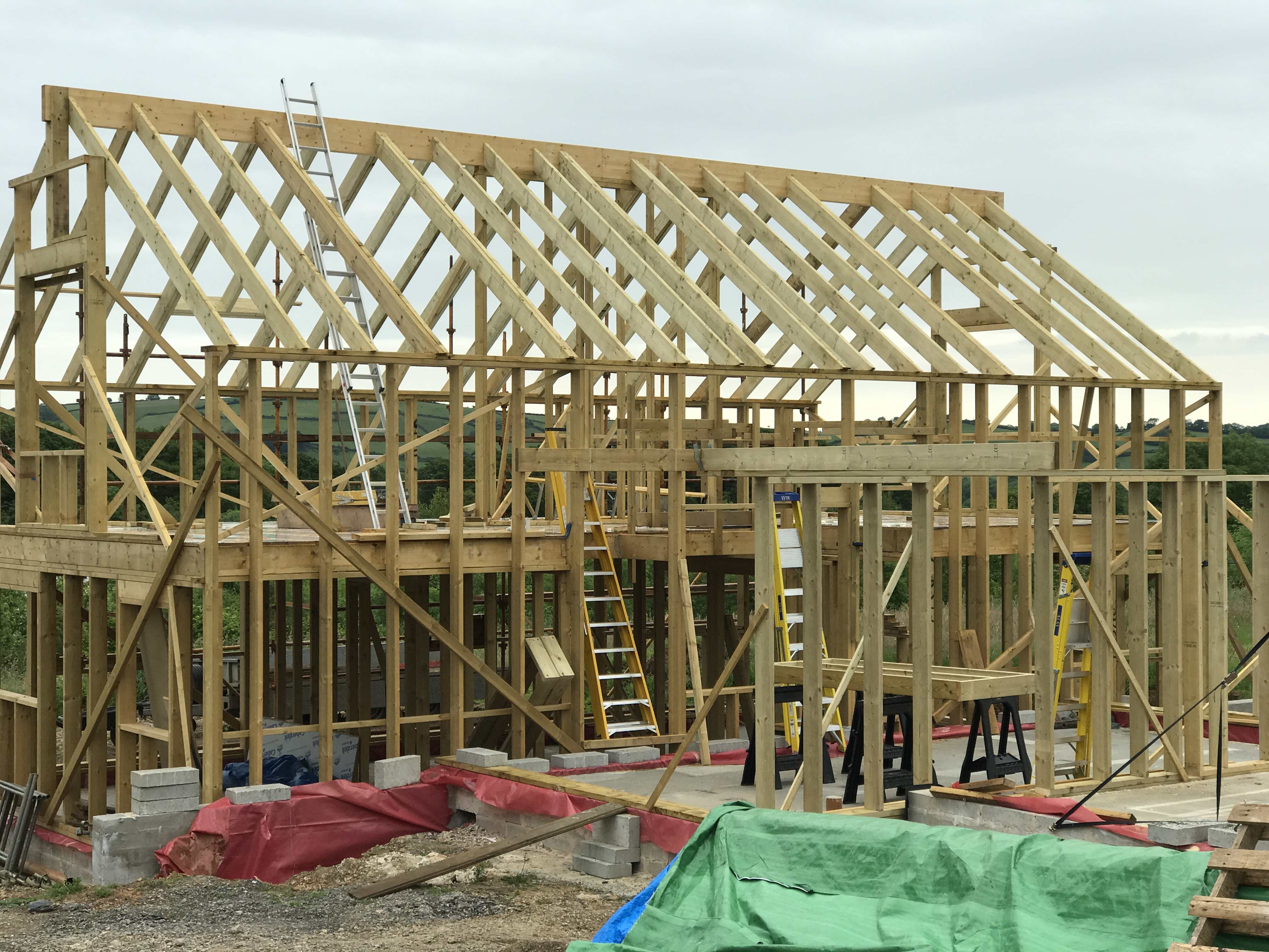

G and J Posted January 7 Posted January 7 Not me, but G, and not finished, but have a look at our blog......demolished bungalow and timber frame build 2 1

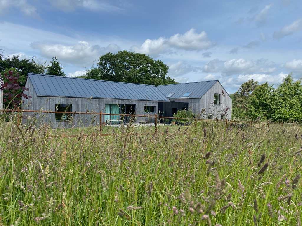

Nestor Posted January 7 Posted January 7 (edited) 39 minutes ago, dustyb said: Not scared to have a go, have always had a problem letting someone else do a job for me, cause I can't justify the cost. Had some very minor domestic renovation experience but achieved possibly 90% of our self build. Paid professionals for electrics, plaster skimming, ASHP, window installation and screed. It is doable, time, money, quality consideration. 3 years before we moved in and 6 years later fitting final architrave ready for repainting!! Has been an amazing experience, learnt so much and the amazing contributions from Buildhub. My Dad, 75 years at the time helped me with the stick build. Would look at other build methods in the future. Edited January 7 by Nestor 4 1
