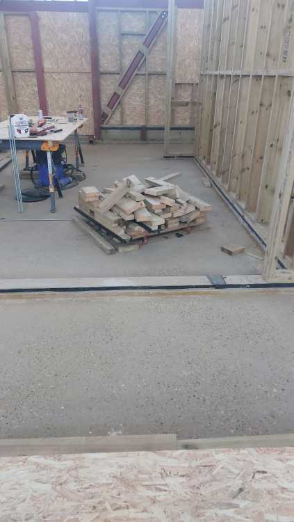

Nickfromwales Posted yesterday at 12:12 Posted yesterday at 12:12 29 minutes ago, saveasteading said: the screed looks like being between generally 55mm ish, but from 45mm to 85mm due to some extreme wobbles in the floor. That’s one heck of a wobble! These are original floors?

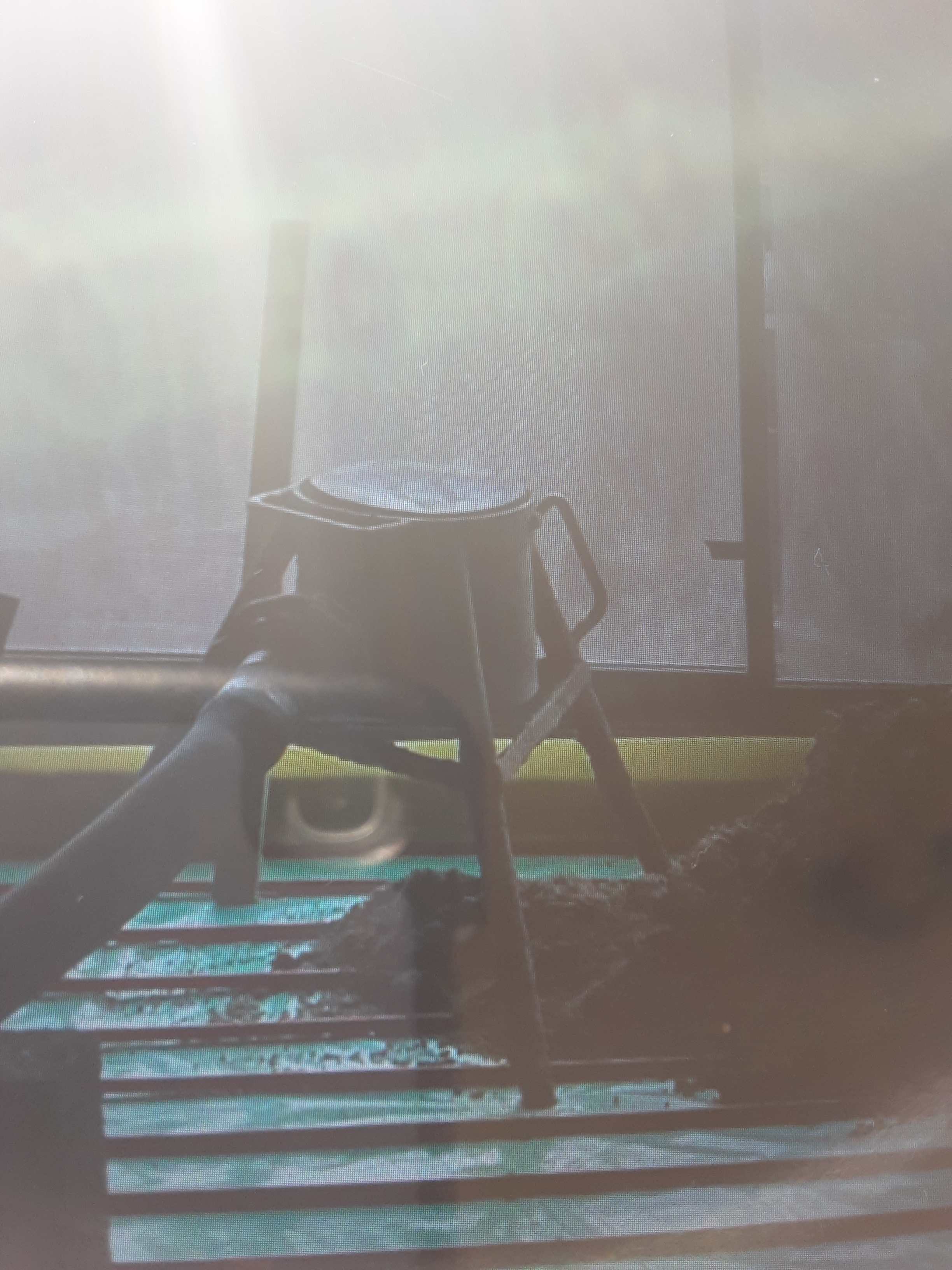

G and J Posted yesterday at 12:12 Posted yesterday at 12:12 We used the u heat version (yellow rather than blue, but looks identical) the upstand on our was stiff enough to be self supporting Apologies for poor image but there's nothing supporting it in front of the sliders and we didn't staple, but as you can see screed was traditional sand and cement 1
saveasteading Posted yesterday at 12:33 Author Posted yesterday at 12:33 10 minutes ago, Nickfromwales said: These are original floors? Yes there is 35mm variation on the slab, with dips occurring at various areas. It is an existing agricultural slab which was good enough for tractors and barn use. There are a few local lumps too where the slab was extended or adapted but I'll have them chipped off. Overall though, now that the rain doesn't get in, you wouldn't notice the variation, except that the sole pate is all level, packed up from zero to 35mm. The insulating slabs will follow the shapes smoothly enough. Now that the rooms are formed we can use different thicknesses of eps on the bottom, and optimise the use of insulation rather than thick screed. But sods law combining with likelihood has it that the biggest room also has the maximum variation within it.
Nickfromwales Posted yesterday at 12:34 Posted yesterday at 12:34 20 minutes ago, G and J said: We used the u heat version (yellow rather than blue, but looks identical) the upstand on our was stiff enough to be self supporting Apologies for poor image but there's nothing supporting it in front of the sliders and we didn't staple, but as you can see screed was traditional sand and cement My preferred choice as my mate gets these traditional screeds perfectly flat and level every single time. Plus, he can manipulate levels for sliders etc which is a lot harder to do with wet concrete or liquid screeds.

G and J Posted yesterday at 12:55 Posted yesterday at 12:55 37 minutes ago, saveasteading said: Ok I'll maybe buy one and fix it and give it a prod test. You appear to have a pump mix concrete that is 200mm thick or so. We will have 45mm to whatever self-levelling screed. Is the yellow stuff stapled on? The screed was 100mm thick, they used a pump, but it was a dryish mix, Josh shovelled sand (16ton) and cement to match like a trojan....and Jason achieved a really flat result, very happy with the job they did. No we didn't staple the upstand at all.
Nickfromwales Posted yesterday at 12:55 Posted yesterday at 12:55 Remember to get these tight into every corner as the curves and divots all need filling / foaming / cutting back etc afterwards; if you’ve not managed this by prevention, then it’s a LOT of time and effort to get these filled and made airtight with foam / passive purple / AT tapes et-al. Put lots of time and effort into getting these filled foam strips put in as tight as you can. I cut and stop / start where it’s easier than forming a turn with continuous strip. Zero detriment when you stop / start, just tape over the joint.
Nickfromwales Posted yesterday at 12:57 Posted yesterday at 12:57 18 minutes ago, G and J said: The screed was 100mm thick, they used a pump, but it was a dryish mix, Josh shovelled sand (16ton) and cement to match like a trojan....and Jason achieved a really flat result, very happy with the job they did. No we didn't staple the upstand at all. You don’t have to fix the upstand with a dry S&C screed, as the installers just flick a few shoots of mix against it and it pins it perfectly in place. The issue of it lifting slightly, and the screed going under it, is very real, so to remove unnecessary risk it’s always good practice to fix it so it stays down and in full contact with the insulation or sub-floor.
