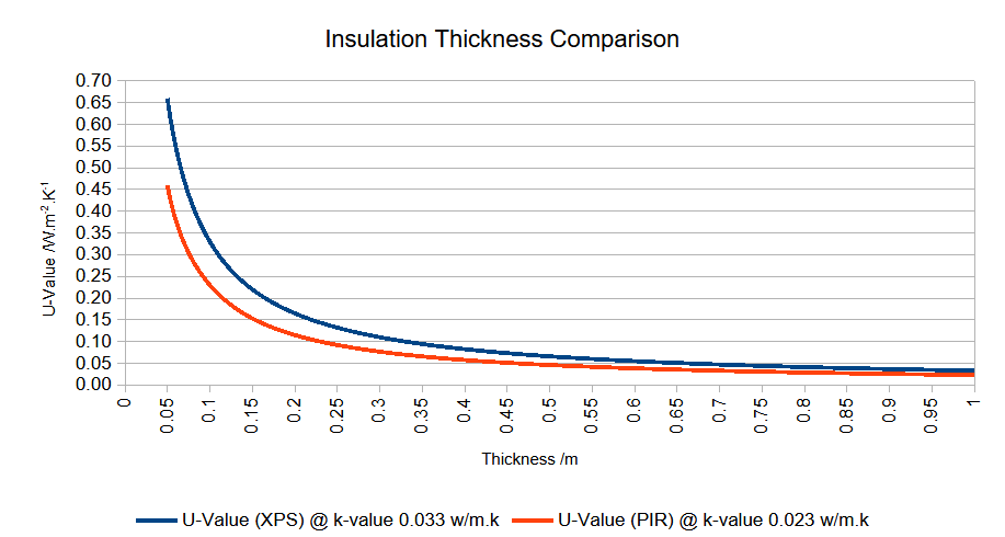

SteamyTea Posted December 31, 2025 Posted December 31, 2025 5 hours ago, G and J said: PIR instead of 120mm each of polystyrene and PIR You are still comparing overall thickness though (I know you had a (expletive deleted) up are limited on thickness). What you need to do is pick a U-Value (i.e. 1.2 W/m².K) and compare the prices to achieve that, not compare prices to fill the gap up. 4 hours ago, saveasteading said: 10 year return would be my judgement Not if you had made that decision in 2015, 6 years before our energy prices doubled.

SteamyTea Posted December 31, 2025 Posted December 31, 2025 Use this simple cut out guide to work out your ideal insulation thickness for your desired U-Value.
