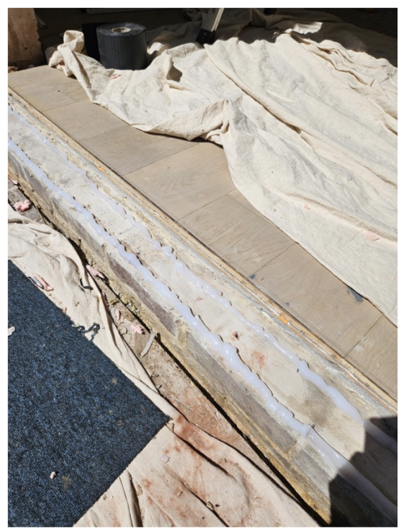

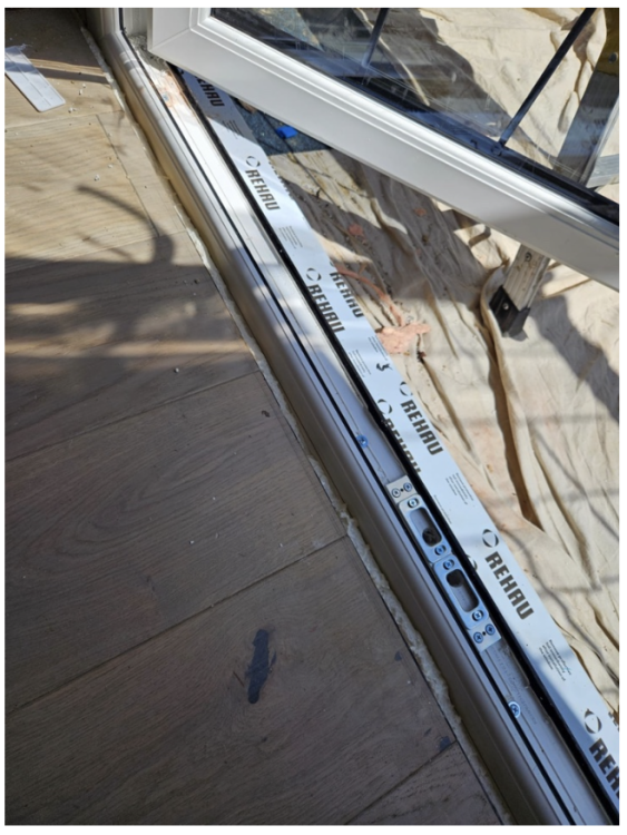

December 29, 2025Dec 29 There is a clear point you’re missing here. You employed the supplier to supply the door at the surveyed size, the installers installed said door into the existing opening. UPVC by design is “thermally” broken by the chamber design. This isn’t product related by the sounds of things but the lack of insulation under the threshold is. This needs done. Installing onto the outer brickwork in typical English builds is standard practice, it’s not the most thermally efficient position but they really haven’t done anything wrong here. I appreciate you have an issue needing resolved and didn’t exist before. Insulate under threshold and monitor. Discuss solutions before going down routes that sours the taste for everyone.
December 29, 2025Dec 29 My advice is to take on board whatever @craig suggests. Unless your agreement with the installer included improving building fabric to mitigate existing cold-bridging, then you only have some minor snagging issues that you could probably have resolved yourself with some expanding foam and sealant in the time taken to craft your comprehensive and eloquent posts!
December 29, 2025Dec 29 Author 18 minutes ago, craig said: There is a clear point you’re missing here. You employed the supplier to supply the door at the surveyed size, the installers installed said door into the existing opening. UPVC by design is “thermally” broken by the chamber design. This isn’t product related by the sounds of things but the lack of insulation under the threshold is. This needs done. Installing onto the outer brickwork in typical English builds is standard practice, it’s not the most thermally efficient position but they really haven’t done anything wrong here. I appreciate you have an issue needing resolved and didn’t exist before. Insulate under threshold and monitor. Discuss solutions before going down routes that sours the taste for everyone. I don’t think I’m missing that point - I agree that uPVC frames are inherently more insulating due to their chambered design, and I’m not alleging a defective product. My concern has always been about the installation outcome, specifically at the threshold detail. Where I differ is that I’ve already tried to resolve this reasonably and practically with the installer. The installing team have attended multiple times, and the company owner himself has visited. On those visits, the issue was repeatedly dismissed as “normal” on the basis that heat rises, that the bottom of doors is always colder, and that condensation is caused by breathing or clothes drying indoors - which I made clear we do not do. Beyond additional sealant, no attempt was made to investigate or improve the threshold detail. I’m not disputing that installing onto outer brickwork is common practice in typical UK builds. I am questioning whether, in this specific case, the resulting internal surface temperature at the sill/frame junction - which is cold enough to repeatedly condense and grow mould under normal occupied conditions - is an acceptable outcome of reasonable care and skill. If insulating under the threshold is the appropriate mitigation, that’s exactly the sort of conclusion I was hoping to reach collaboratively. Unfortunately, that option was explicitly ruled out by the installer, who stated insulation under the sill is not required and that nothing further could be done. Given that, it seems reasonable to seek independent or regulatory review rather than continue a circular discussion where the issue is acknowledged in practice but dismissed in principle.
December 29, 2025Dec 29 Then he’s talking nonsense. You always insulate all around the frame and that includes the threshold when necessary. It doesn’t need to be foam, Compriband would be good enough. Edited December 29, 2025Dec 29 by craig

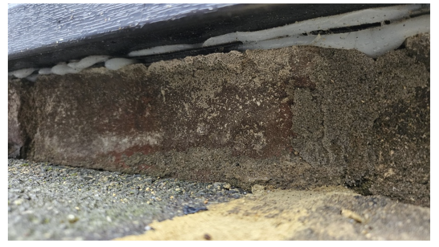

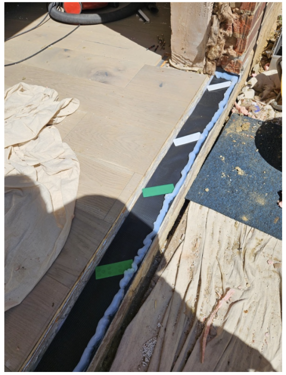

December 30, 2025Dec 30 11 hours ago, fandyman said: whether the way the sill is supported and detailed has unnecessarily amplified that effect, given the resulting persistent condensation and mould. I think from this you’re hoping that because they’ve bedded it on silicone and packers that this is exacerbating the thermal bridging. It’s not. And I think it’s standard installation. What should have happened is your lower course of bricks should have been taken off and replaced with marmox, compacfoam etc. as others have said this isn’t the installer responsibility and they’ve installed as any installer would.

December 30, 2025Dec 30 Author 39 minutes ago, SBMS said: I think from this you’re hoping that because they’ve bedded it on silicone and packers that this is exacerbating the thermal bridging. It’s not. And I think it’s standard installation. What should have happened is your lower course of bricks should have been taken off and replaced with marmox, compacfoam etc. as others have said this isn’t the installer responsibility and they’ve installed as any installer would. I don’t think that follows, and it’s not what I’m asserting. I’m not saying silicone or packers create a thermal bridge in isolation. I’m saying the resulting installation detail has coupled the internal frame directly to cold, ground-connected masonry, producing an internal surface temperature low enough to repeatedly condense and grow mould. That outcome is observable and isn’t in dispute. Replacing the lower course of bricks with Marmox / Compacfoam would certainly be one way of mitigating that - but that doesn’t automatically mean the only way, nor does it mean the installer bears no responsibility for the detail they chose and executed. They surveyed the opening, specified the product, and installed the threshold. I didn’t instruct a brick-to-brick sill or prevent any form of thermal mitigation. Saying “this is how any installer would do it” describes industry normality, not whether the outcome is acceptable when it results in persistent condensation under normal internal conditions. Those two things aren’t the same. I’m not arguing that the installer should redesign the house or retrofit insulation into the floor. I’m questioning whether the threshold detail they implemented has unnecessarily amplified heat loss at that junction, and whether the resulting internal surface conditions are a reasonable outcome of the service provided. That’s why I’ve been careful to frame this as an outcome-based question, not a blanket criticism of standard practice.

December 30, 2025Dec 30 27 minutes ago, fandyman said: That’s a fair hypothesis to explore, but there’s an important factual point to clarify. Before the doors were installed, there was a continuous screed and floor build-up running from the living space into the conservatory area. The ground-level brickwork at the opening was not exposed internally, and there was no visible condensation or mould at that junction. As part of the works, the conservatory base was removed and the screed was cut back to just behind the brick line. The installer then positioned the sill/frame forward and created a new internal junction, including a small expanding-foam upstand between the sill/frame stack and the remaining screed/finished floor. That foam is incomplete in places and has visible gaps. So while I don’t rule out the ground-contact masonry contributing to cooling, the key change is that the installation has introduced a new cold internal surface and junction detail that did not previously exist, and that surface is now where condensation and mould are forming. That’s why I’ve been focusing on the threshold detail itself - not because I think the building fabric was perfect before, but because the installation altered how that fabric is thermally coupled to the internal environment. I’m not asserting a single cause; I’m trying to understand whether the way the sill and frame were positioned and detailed has unnecessarily amplified what was previously a non-manifesting condition. I might be misunderstanding so just want to clarify… previously where this junction existed both sides were effectively warm? Ie one side was your internal house and the other side was a conservatory (heated?)
