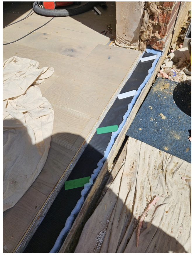

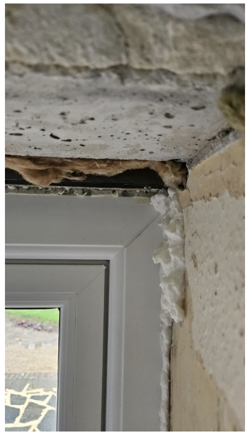

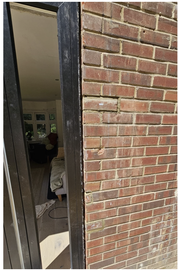

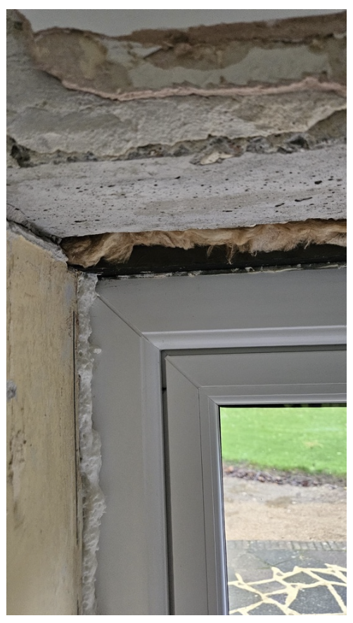

Hi all,
I’d appreciate some advice from people who know more about window/door installation than I do.
We had new REHAU Rio patio doors with sidelights fitted earlier this year by a small FENSA-registered company. We are getting very noticeable cold and draughts around the bottom of the frame/sill junction, especially now that the weather has turned colder.

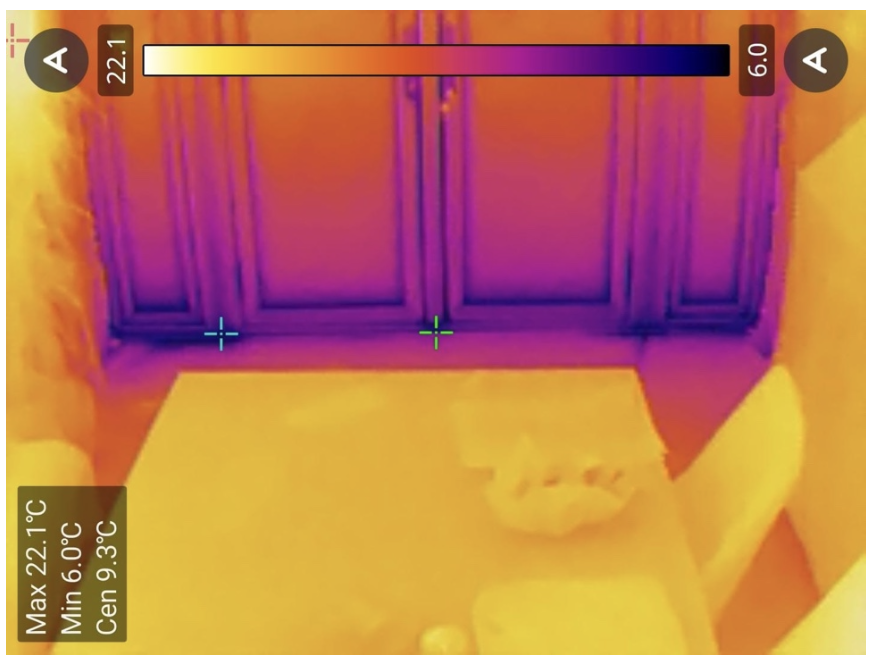

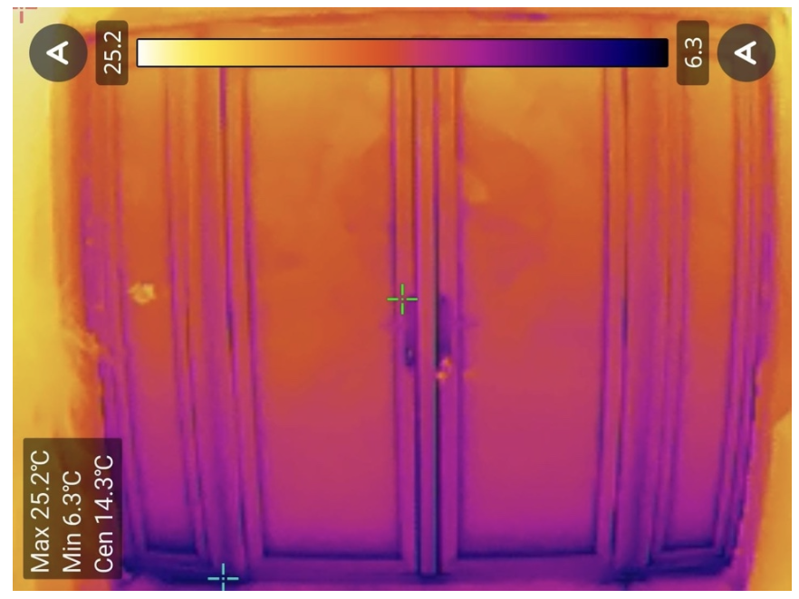

After taking some thermal images, there is a very clear cold line exactly where the sill meets the frame. It’s a consistent pattern across the whole width. I’ve attached the thermal photos below.

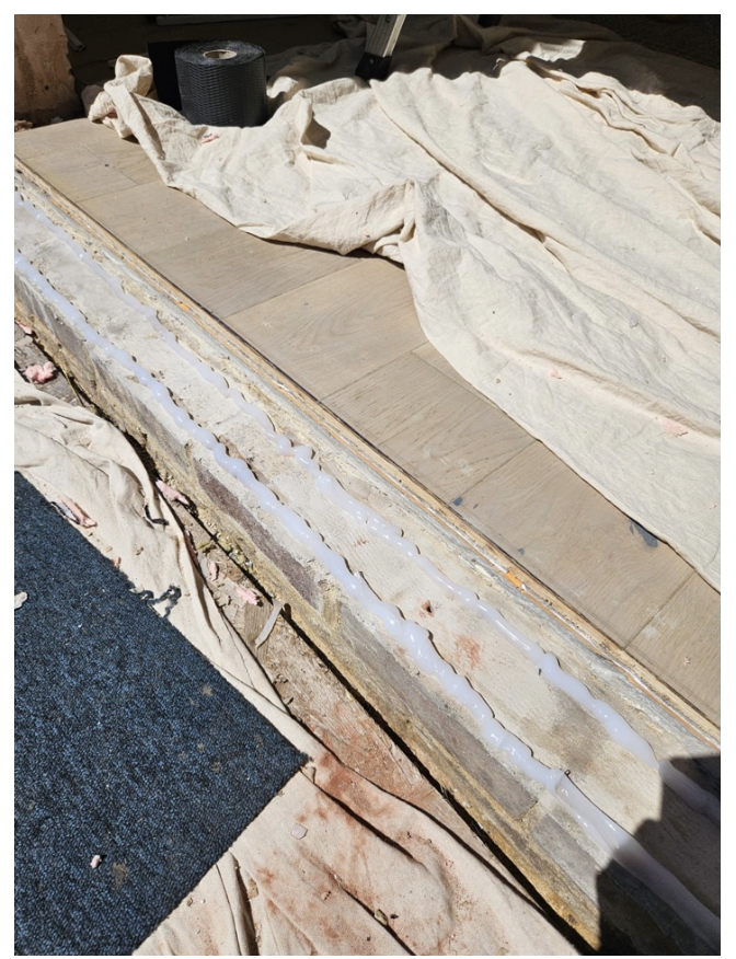

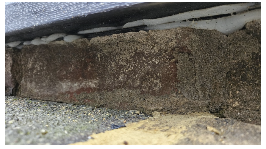

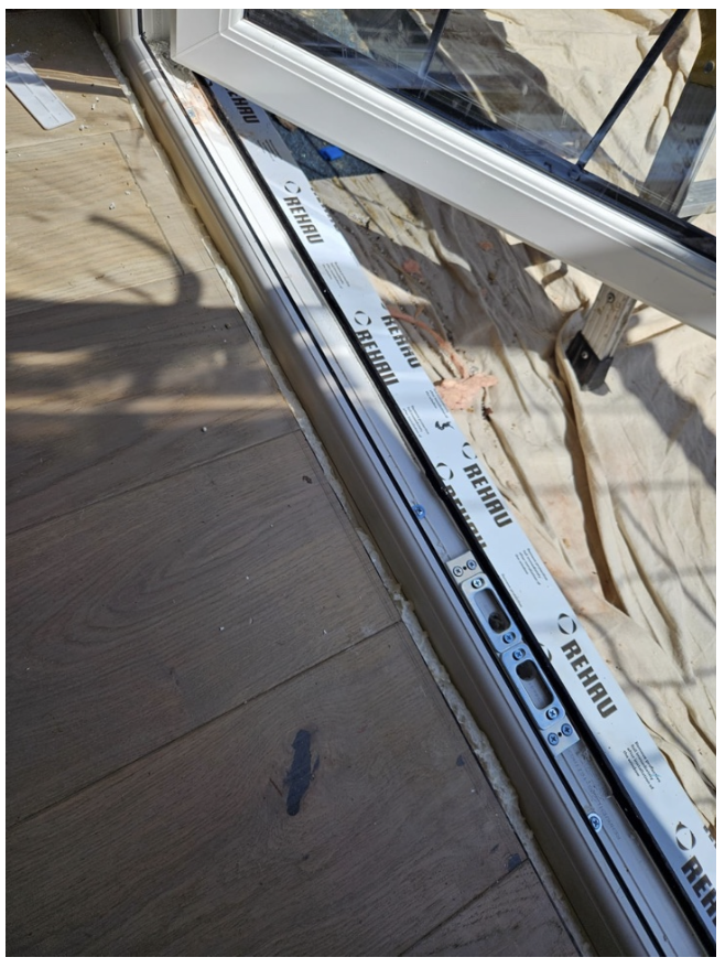

I also looked underneath the exterior cill and it seems like the sill is resting directly on the brickwork with no insulation or thermal break. The installer told me:
“There’s only a 3–5 mm gap, we can’t insulate that, proper insulation isn’t required for small gaps.”
and also:
“It’s your floor that’s cold, not the door.”
The floor is finished up to the frame, and the thermal camera shows the cold coming specifically through the frame/sill junction, not from below.
The coldest areas appear most pronounced at frame junctions and corners rather than uniformly across the opening.
My questions for the forum:
  1. Is a sill resting directly on cold brickwork with only tiny packers (1-4mm) and without insulation acceptable practice?
  2. Should a proper installation normally allow some allowance for insulation or a thermal break beneath the sill, rather than bearing directly on masonry?
  3. Would resealing or adding more foam internally achieve anything, or is this fundamentally a threshold installation problem?
  4. Is this something that FENSA would normally get involved with?
  5. Has anyone here had to escalate a similar issue under the Consumer Rights Act?
I’m trying to resolve this with the installer first, but they say the installation is correct and that nothing more can be done.
Any professional opinions or similar experiences would be really helpful before I decide how to proceed.
Thanks in advance.

    Quick update following the FENSA inspection. An independent inspection has now been carried out, and the installation has been formally assessed as non-compliant with Building Regulations (Part L
  • fandyman
    fandyman
    Just to update you installer offered a full refund after the issue got escalated via the bank through Section 75 so looks like he now fully agrees to his installation failures after months of denials.

1. I doubt if any of us here would say it was acceptable but I suspect it is common.
2. Yes for me, and I guess for all of us here.
3. Not much, and yes.
4. I don't know. I fear that there's no obligation to insulate below a cill. I'd do it anyway, but whether Bldg Regs would *make* me do it, I think perhaps not, but not certain. The last patio doors I was involved with were sat on Compacfoam.
5. No, sorry.
I think if I had been presented with what you have there I would be cutting out a brick at a time and replacing with something like Compacfoam - expensive but effective load-bearing polystyrene.
I am sure there are lots of really good uPVC window and door installations. Unfortunately I have seen a large number of average-to-awful ones, so this detail upsets me but does not surprise me.
Was the uPVC door a replacement of an existing door, or is that a 'dropped' window opening? The latter, I think, given the odd cuts on the bottom half, RHS.
Edit: Thinking about it, the patio doors we did were in a wall with EWI, so the compacfoam was 'buried'. In your case you'd have a 'raw edge'. It's late, so I'll think in the morning how one might deal with that. How far above ground level is the external cill? If it is close you'll get a lot of splash-up. OK, it's not a timber door, but neither is it ideal. (And whatever the Building Regs say, rain splashed up more than 150mm in many areas!

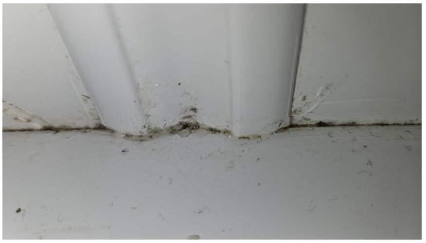

Your very last picture, I would masking tape it off and then apply a very thick black bead along the bottom.

Thank you — that’s really helpful and aligns closely with what I’ve been suspecting.
Just to clarify one important point about the opening:
  • When I purchased the house over three years ago, the opening already existed at full height exactly as it is now. There were no windows, doors, or dwarf walls present, and no structural changes have been made since (there was a conservatory that has been demolished since then and new patio paving laid in its place). The installer therefore worked with a pre-existing opening and was responsible for detailing the door installation within that condition.
The sill appears to be bearing directly on brickwork, with no packers or thermal break beneath. Internally, the cold line corresponds very precisely with the sill/frame junction and the side-panel-to-door frame junction, which is where condensation and mould are occurring.
Thermal images show localised internal surface temperatures at those junctions significantly lower than adjacent areas, suggesting a concentrated cold bridge rather than general floor temperature influence. The floor itself does not show the same thermal signature away from the frame.
Your comment about Compacfoam is interesting — that’s broadly what I would have expected in terms of maintaining thermal continuity at a load-bearing threshold, even if not explicitly mandated by Building Regulations. As you say, “I’d do it anyway.”
What I’m still trying to understand is whether, in a retrofit scenario with a pre-existing opening, best practice would normally allow a sill detail that results in the internal frame/sill junction dropping below dew point under normal winter conditions — even if the regulations themselves are not explicit.
For clarity, the patio paving was installed after the door, and the final external level is approximately one brick (~75 mm) below the sill.
Thanks again for taking the time to respond — this has been extremely useful.

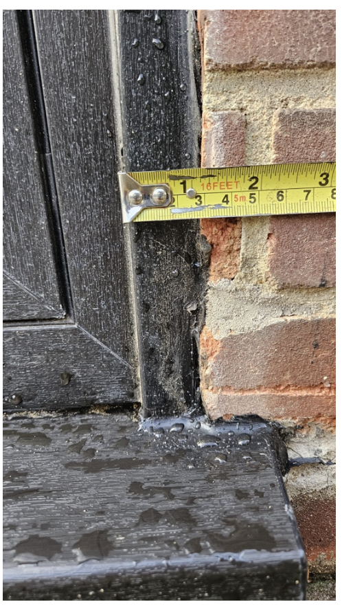

Thanks — I understand why that might help with draughts or water ingress.
My concern here isn’t primarily air leakage, but internal surface temperature. The condensation and mould are forming because the sill/frame junction is becoming cold enough to drop below dew point under normal conditions.
Adding a thick internal bead may improve airtightness, but it wouldn’t change the underlying thermal path through the sill into the masonry, and therefore wouldn’t raise the surface temperature that’s causing the condensation. There’s also a risk of sealing moisture into the junction rather than resolving it.
That’s why I’m trying to understand whether the installation detail itself reasonably anticipated and mitigated this thermal bridge, rather than looking for post-hoc cosmetic fixes.
I appreciate the suggestion though.

Think the trouble with a lot of these questions and issues, they are raised after the event, when it's basically too late. People expect wonders to occurs without pre planning and deep discussion on expected outcomes. Thermal bridging isn't great, but we have a work force of poorly trained labourers, not skilled crafts people.
Only things open to you without taking everything out and starting again, fill all gaps with expanding foam, seal the outside with mastic to form a waterproof seal.
But looking at the thermal images, I would comment
Door cill area doesn't look that bad, worst bridge appears to be at the side lights, most likely caused by air movement.
Your doors most likely need adjustments as you appear to have drafts at the door seals.
So as mentioned fill any remaining gaps with expanding foam, seal with mastic and move on with your life.

The draughts are to do with airtightness, not insulation.  Externally you need to run sealant between the frame and the brickwork and under the cill.  Get a nice tooled finish on the sealant.  Add extra sealant between the cill and the base of the frame.
If the floor adjacent to the doors is cold it may be because of air leakage, insufficient insulation or no thermal break, such as a perimeter upstand of PIR.

1: Is it a bad install?
A: No, not the best, I’d expect them to clean up the expanding foam and trim/silicone internally (if within remit).
2: Threshold, gaps and no insulation.
A: I would have expected this to be foamed and mastic applied, they’ve forgot.
3: Have they breached consumer rights under care & skill?
A: No.
4: Draughts/leaking etc.
A: Around the frame and on occasion via the door / window is the installers responsibility. They’ve not foamed under the door and I’d ask them to come back and do it plus mastic.
Other than that, they cannot do anything about the existing cold bridges present. It’s not up to them.
What I see and read a minor snags on the finishing internally and whether that was within the remit and the underside of threshold (foam/mastic). If that was reported to me as a supplier. I’d apologise and have the team attend to sort out at least one of the two issues that I see.

Those plastic sills are never brilliant as thermal breaks but I suspect the issue may be that the floor adjacent to the doors is not sufficiently thermally isolated from the wall.  Do you have a thermal image of this area?  Also, do you know what insulation is under the floor?
Door thresholds are often a real thermal weak point.

Draughts are worse than cold bridges and that thermal pic may make it look worse than it is. draughts can be sorted with standard brush strips. so what do you do if you get awarded £30 towards fitting these?
Not an expert but have similar thoughts about where the internal floor build up meets the external walls, no sufficient  thermal break visible to me.
I fitted 20mm Pavatherm reveal boards in the window apertures, timber frame build. Not suitable under large doors due to compression so used 25mm plywood. Walls are 390mm deep.
