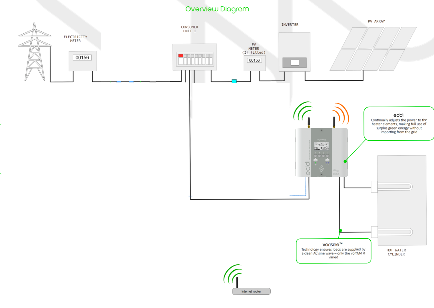

Crofter Posted December 18, 2025 Author Posted December 18, 2025 16 minutes ago, Beelbeebub said: https://www.doncastercables.com/cables/20/89/PV-Ultra--/PV-Ultra-----Double-Insulated-Multicore-DC-Cable/ The do 4 core so you can have 2 strings if required. Regarding upgrades it depends a bit on which panels you're putting in. Current "mid range" panels are in the 450w range with some premium panels going over 500w, a few years go the 450w panels were premium and most were 400w or lower In 10 years time the cheapest panels might be 550w and the premium ones 650w So if you reolwce/upgrade your current will go up even if your array stays nominally the same. Also we don't know what planning will do in the future, it may be they change the permitted development allowance and you could add more panels. Be nice if the cables were already sized for that, especially if relaying them would be a faff - if the route would be a doddle to add an extra cable don't worry too much. But if it"s a sod, just do it once It's not a hard run- just across some rough ground at the back of the garden. I'm not digging up a driveway, or even a lawn. So I don't think I'll regret it too much if I do end up having to re-do it. Anyway... cabling aside, with the rest of the installation, what would be best practise: - breaker and/or isolator up at the panels? - breaker between the Eddi and the immersion? - anything else that might not be obvious to me?
SteamyTea Posted December 18, 2025 Posted December 18, 2025 12 minutes ago, Crofter said: breaker and/or isolator up at the panels Definitely, you don't want a live conductor, AC or DC, what you cannot isolate at the source end. Make sure that isolator can handle the DC current. 14 minutes ago, Crofter said: breaker between the Eddi and the immersion Yes. I am not sure if there should be one before it. Probably does need something to safely isolate it, but the MCB/RCD/RCBO may well do that. What do the regulations say?
cjsparkey Posted December 18, 2025 Posted December 18, 2025 MCB/RCD/RCBO To DP isolator for Eddi, load side of the Eddi to immersion via a local isolator. Technically the local isolator for the immersion might not be needed if the Eddi is local to the immersion but it’s handy if you ever need to isolate the immersion without needing to shut down the Eddi.
