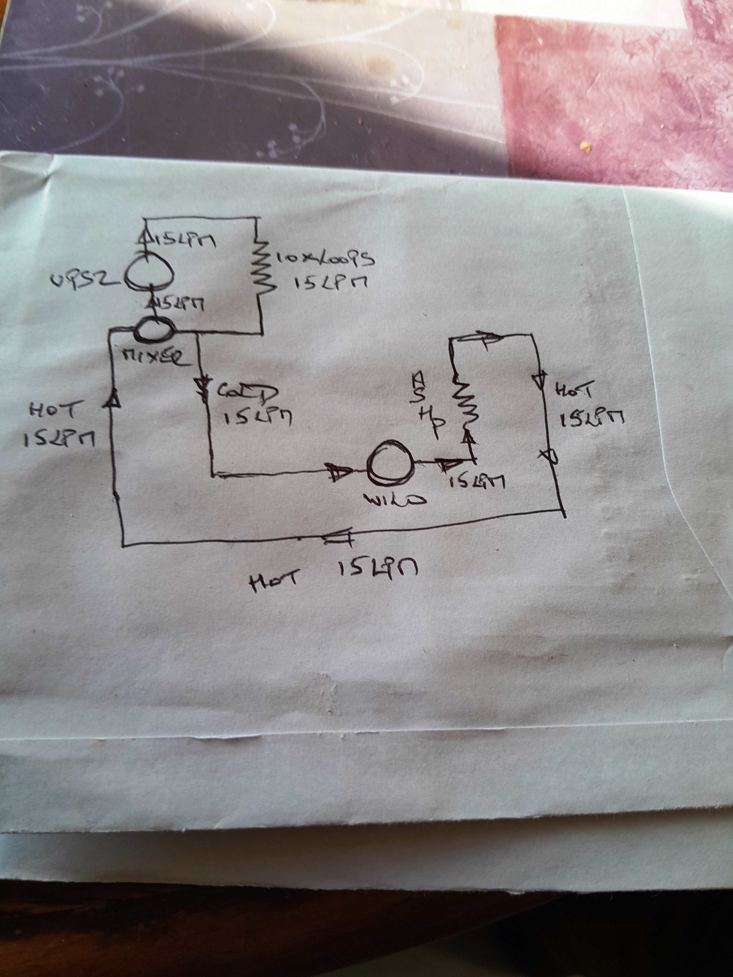

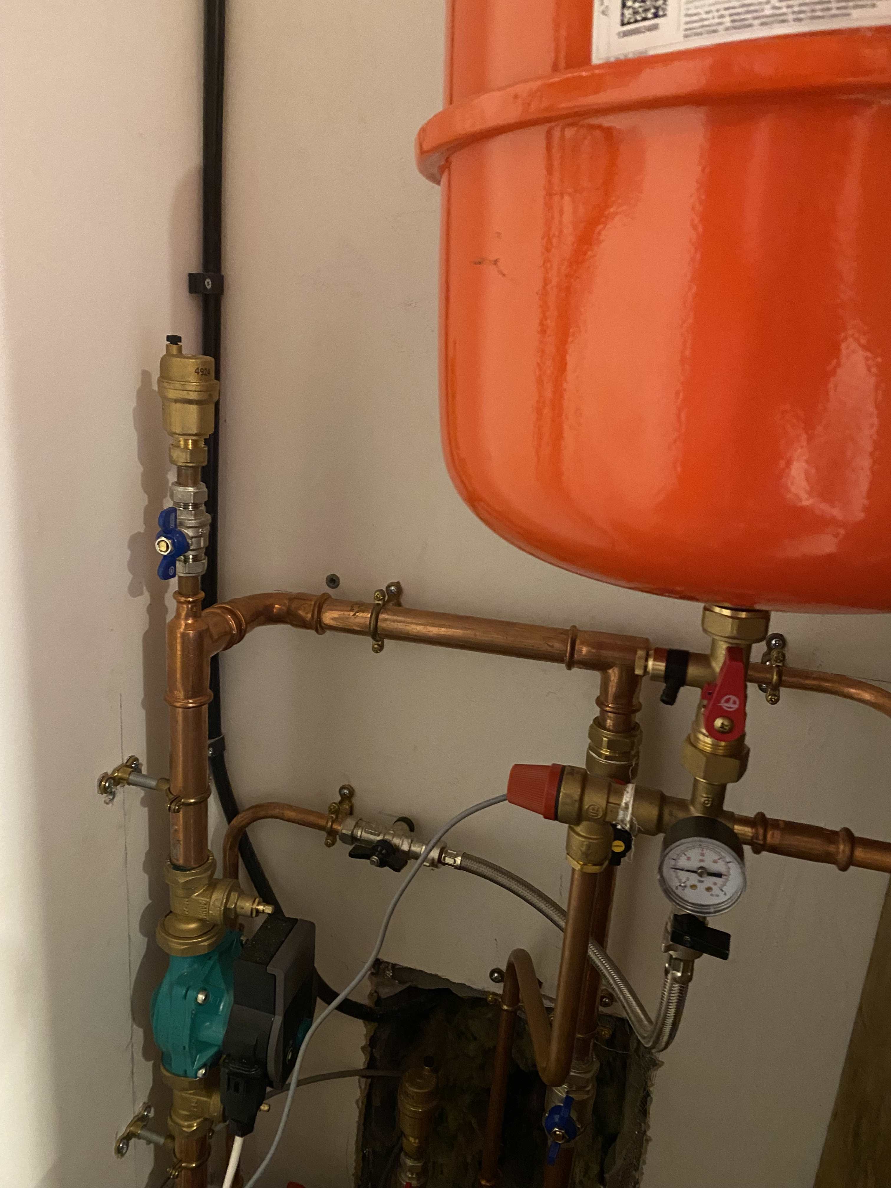

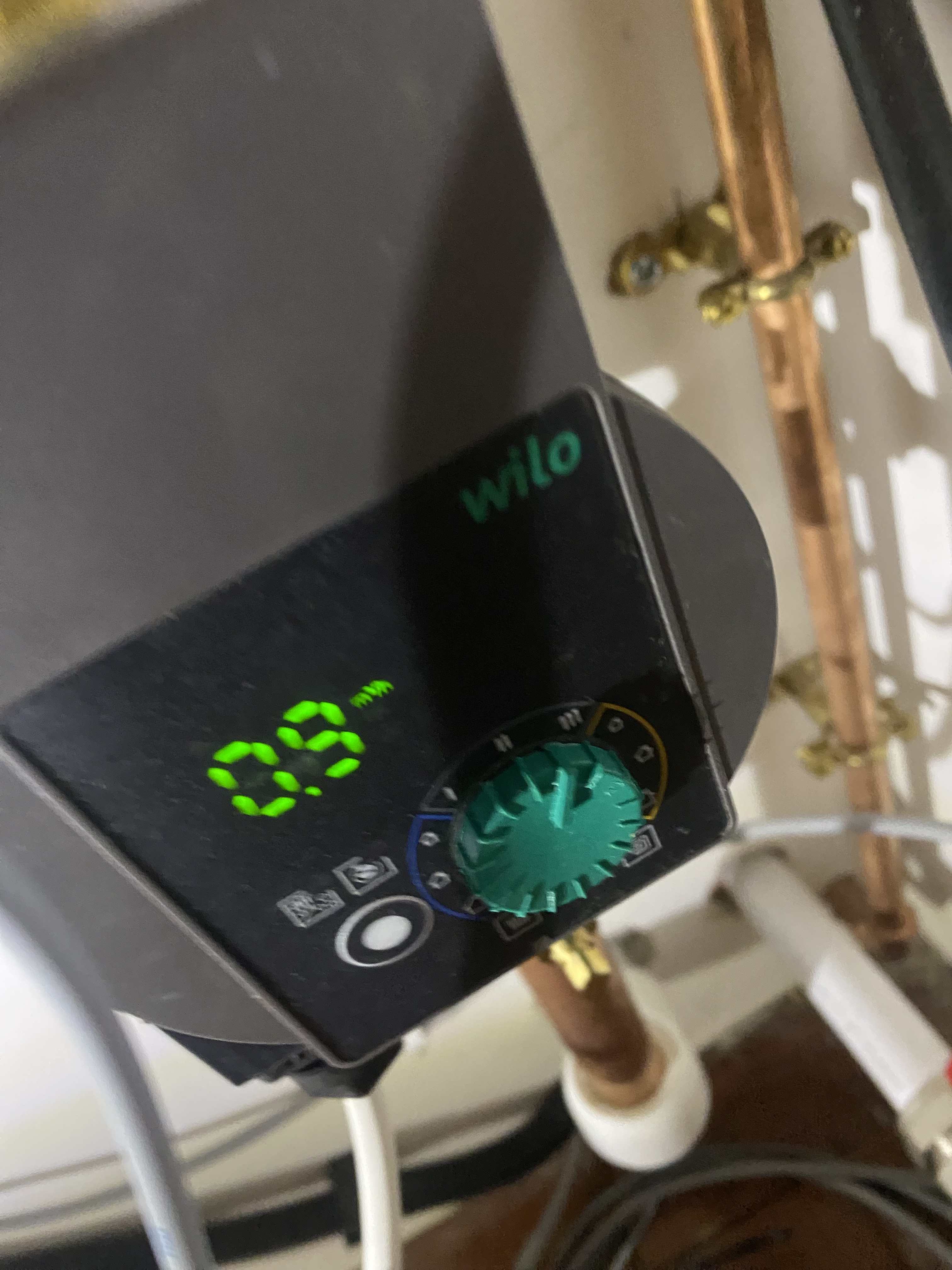

Simon Brooke Posted yesterday at 10:01 Posted yesterday at 10:01 Finally got a plumber to connect up my Samsung ashp. This is to take the place of a heat battery. The system is as simple as possible with no zoning. A second pump has been added (a Wilo Pico), in addition to the original Grundfos supplied with the u/f kit. I would have liked to have had the blending valve removed but this was too much for the plumber! The maximum flow rate per the Pico read out is 0.9m3 which I am assuming equals 15 lpm. The manual indicates that I need 17lpm so not fast enough and I get a low flow error code each time I try to run it. Research on the net seems to give me two options. The first is to install a new pump with a greater speed capacity and the second is to somehow run the two pumps in parallel which seems to increase the flow speed. A final option is to move the second pump from its current position of being on the return to the heat pump to being on the flow side. If it is not already clear I am not a plumber but should be capable of simple pump replacement etc. Any thoughts welcome.

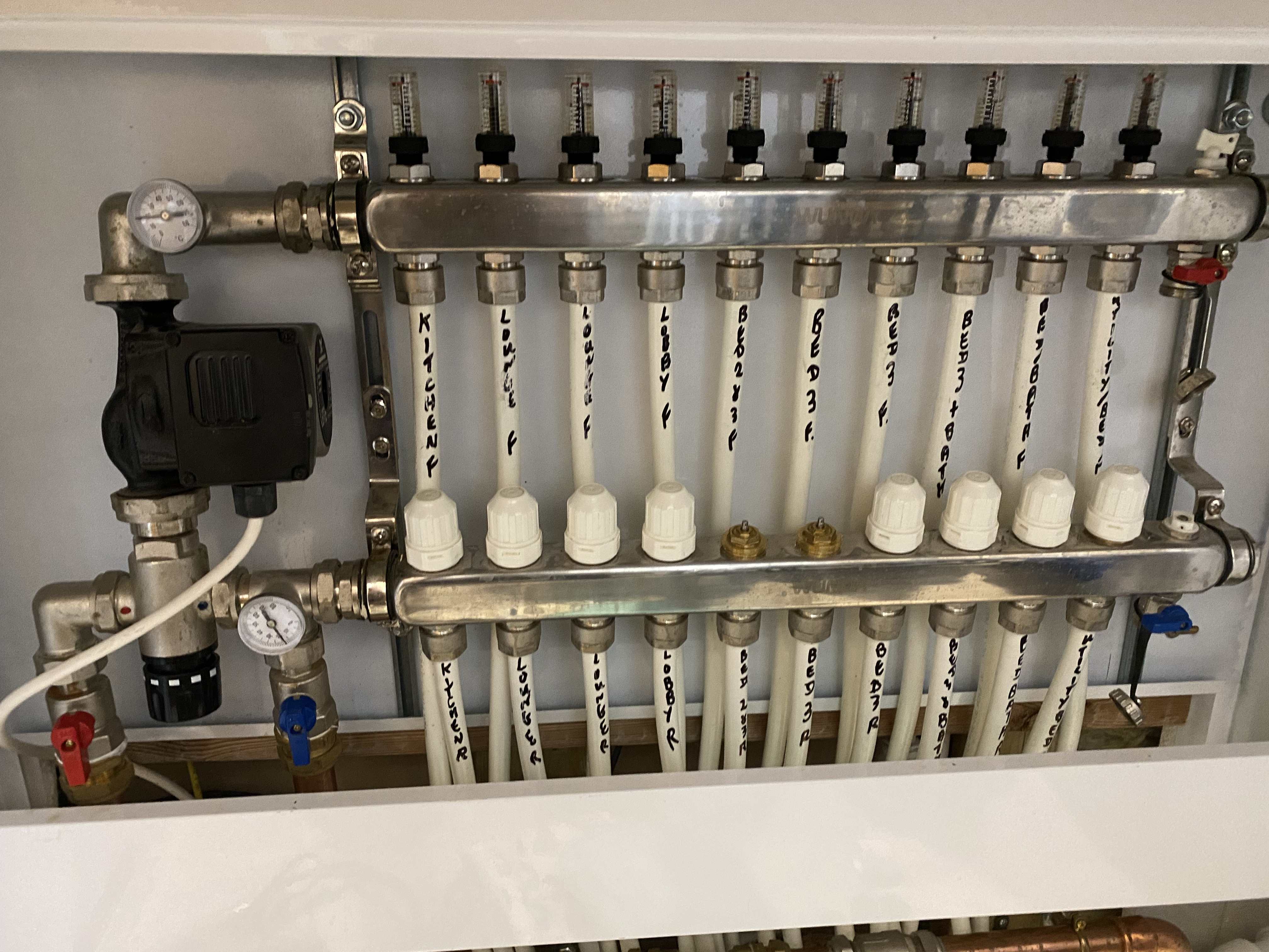

JohnMo Posted yesterday at 10:42 Posted yesterday at 10:42 (edited) Flow is king with heat pumps. Excluding the mixer for now. Your flow limit comes from the flow meters on the UFH manifold. The flow added together of each loop is basically the max flow rate you can get through the system. Open each loop another 0.5 l/min, that will add 5l/min flow. To increase flow turn the black part of the flow meter on top manifold anti clockwise. If flow doesn't increase look at the mixer pump speed settings and increase the speed. Next - a later job. Your mixer isn't needed, it's just causing a bottle necks and unnecessary mixing. Plus it doesn't allow you to run weather compensation very well. You also need to run a higher flow temperature to compensate for the mixer valve. So get a worse cop. Two pump running cost you more money. I would be installing a single 5 or 6m head pump that does UFH and your DHW heating. Delete the mixer and pump. Edited yesterday at 10:43 by JohnMo

SimonD Posted yesterday at 14:08 Posted yesterday at 14:08 (edited) 4 hours ago, Simon Brooke said: The maximum flow rate per the Pico read out is 0.9m3 What is the exact model? Ideally we need to know if you need to increase flow rate or if it's a pressure drop issue. Edited yesterday at 14:10 by SimonD
Simon Brooke Posted yesterday at 14:29 Author Posted yesterday at 14:29 Many thanks for all the comments. The model is AE090JXYD EU. It does not have it’s own pump. The loops are pretty much fully open, in fact one completely undid to much merriment!. Pumps on max. Any thoughts on the idea that the two pumps may somehow be conflicting with each other?
SimonD Posted yesterday at 14:43 Posted yesterday at 14:43 13 minutes ago, Simon Brooke said: Many thanks for all the comments. The model is AE090JXYD EU. It does not have it’s own pump. The loops are pretty much fully open, in fact one completely undid to much merriment!. Pumps on max. Any thoughts on the idea that the two pumps may somehow be conflicting with each other? What is the model of the Wilo Pico?
Simon Brooke Posted yesterday at 15:03 Author Posted yesterday at 15:03 Good question! The information plate is impossible to photo clearly. I would have to loosen the pump to see.
SimonD Posted yesterday at 16:15 Posted yesterday at 16:15 1 hour ago, Simon Brooke said: Good question! The information plate is impossible to photo clearly. I would have to loosen the pump to see. This is quite important. At 15l/m or 0.9m3/h the smallest Pico can only deal with just below 3m head on pump setting 3. Your heat pump at the required 17l/min has a pressure drop of 0.5m head leaving you with a residual of less than 2.5m head on the pump. 1

John Carroll Posted 23 hours ago Posted 23 hours ago (edited) Your Wilo pump should also display the power W (watts), not sure if it alternately switches from flow, m3/hr to power, W but there is certainly some method of having a look quite easily, I have a 6M Wilo (Yonos) Pico that only displays the power W but quite easy to read off the flowrate from the pump curves. If its the 4M model then the power at 0.9ms/hr is only ~ 17W, if its the 6M model, then the power at 0.9m3/hr will be around 40W + a quite hefty pump head of ~ 5M. (speed 3, C3) What is the UFH manifold pump model and setting? What are the flow indicators showing in LPM?. What dia are the Loop pipes and roughy the loop lengths? Edited 23 hours ago by John Carroll
Simon Brooke Posted 10 hours ago Author Posted 10 hours ago It is a Grundfos UPS2 25-40/60. Search indicates 6m head and max flow of 3m3. The only indicators are green bars which show a max of 3. Flow gauges reading approx 1.5 and there are 10 loops averaging 90m using 16mm Wunda pipe. It is ages since I ran the heating using the Sun amp but I am pretty sure that the required flow rates of an average of 2.25 were achieved with the single grundfos pump. Again , thanks for everyone’s input.

John Carroll Posted 9 hours ago Posted 9 hours ago (edited) 14 minutes ago, JohnMo said: Funny old thing. Exactly what I said up thread. Doesn't matter what you pumps are at the moment you have gagged flow through system with your flow meters on the UFH loops. Flow simply has no where to go. Open them all up to 2.0 on all loops, that will give you 20L min flow potential. Until you have done these simple steps, everything else is a waste of time. Simon said "The loops are pretty much fully open, in fact one completely undid to much merriment!. Pumps on max." so not much more scope there for improvement?. 90M of 16mm/12mm ID pipe has only a loss of 0.61M and the UPS 2 when using sun amp was circulating a total of 22.5LPM, at this flowrate a UPS 2 will run with a 4.3M head, At the present set up it will be running at 5.3M at a total flowrate of 15LPM (1.5LPM/loop), similar to the Wilo if (a 6M), I would check that the Wilo is orientated correctly, ie pumping in the "right" direction, by looking at the arrow on the pump body, also as requested earlier, check the power in watts which will identify whether a 4M or 6M pump. Edited 9 hours ago by John Carroll

Simon Brooke Posted 4 hours ago Author Posted 4 hours ago The Grundfos has a max power of 48 w. The Pico shows a power consumption of 4 to 40 w. Pump body arrow is correct.

JohnMo Posted 3 hours ago Posted 3 hours ago 18 minutes ago, Simon Brooke said: Thanks John. I will contact Samsung tomorrow. What does your piping look like from ASHP to UFH manifold? Length and pipe dia. How long is the plastic pipe leading to the Wilo pump? The isolation valve on your Wilo pump looks to be a reduced bore, which will not help things.

Simon Brooke Posted 3 hours ago Author Posted 3 hours ago Approximately 3.5 metre run of 28mm plastic.
JohnMo Posted 3 hours ago Posted 3 hours ago Just now, Simon Brooke said: Approximately 3.5 metre run of 28mm plastic. That shouldn't be the issue
