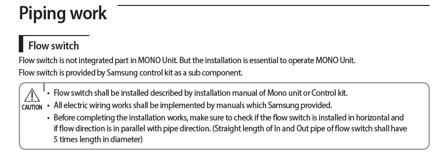

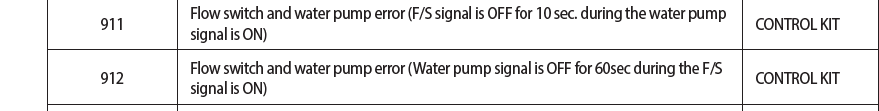

December 15, 2025Dec 15 Just wonder if there is a actual interlock via a flowswitch, etc, it just says the unit can stop, page 23, I think they can trip if the flow/return dT is too low, some alarm is surely flagged if the unit refuses to start. Could be something else stopping this unit from starting. There should really be a ABV between the flow&return anyway. Edited December 15, 2025Dec 15 by John Carroll
December 15, 2025Dec 15 Found this in the attachment but seems strange that this subject unit does not have its own pump?
December 16, 2025Dec 16 13 hours ago, John Carroll said: Just wonder if there is a actual interlock via a flowswitch, etc, it just says the unit can stop, page 23, I think they can trip if the flow/return dT is too low, some alarm is surely flagged if the unit refuses to start. Could be something else stopping this unit from starting. There should really be a ABV between the flow&return anyway. Ah well, done. You read the manual properly to find the info not in the tech specs but in the "Before installing/commissioning the unit, make sure to check the following points :" section! Who would have known...😉 It would be interesting to know more about the flow switch installation and requirements. On the ABV side, I've just started a discussion elsewhere about the suitability of ABVs on modulating systems or where variable speed pumps are being used. There seems to be some contradiction around this. What's your view?
