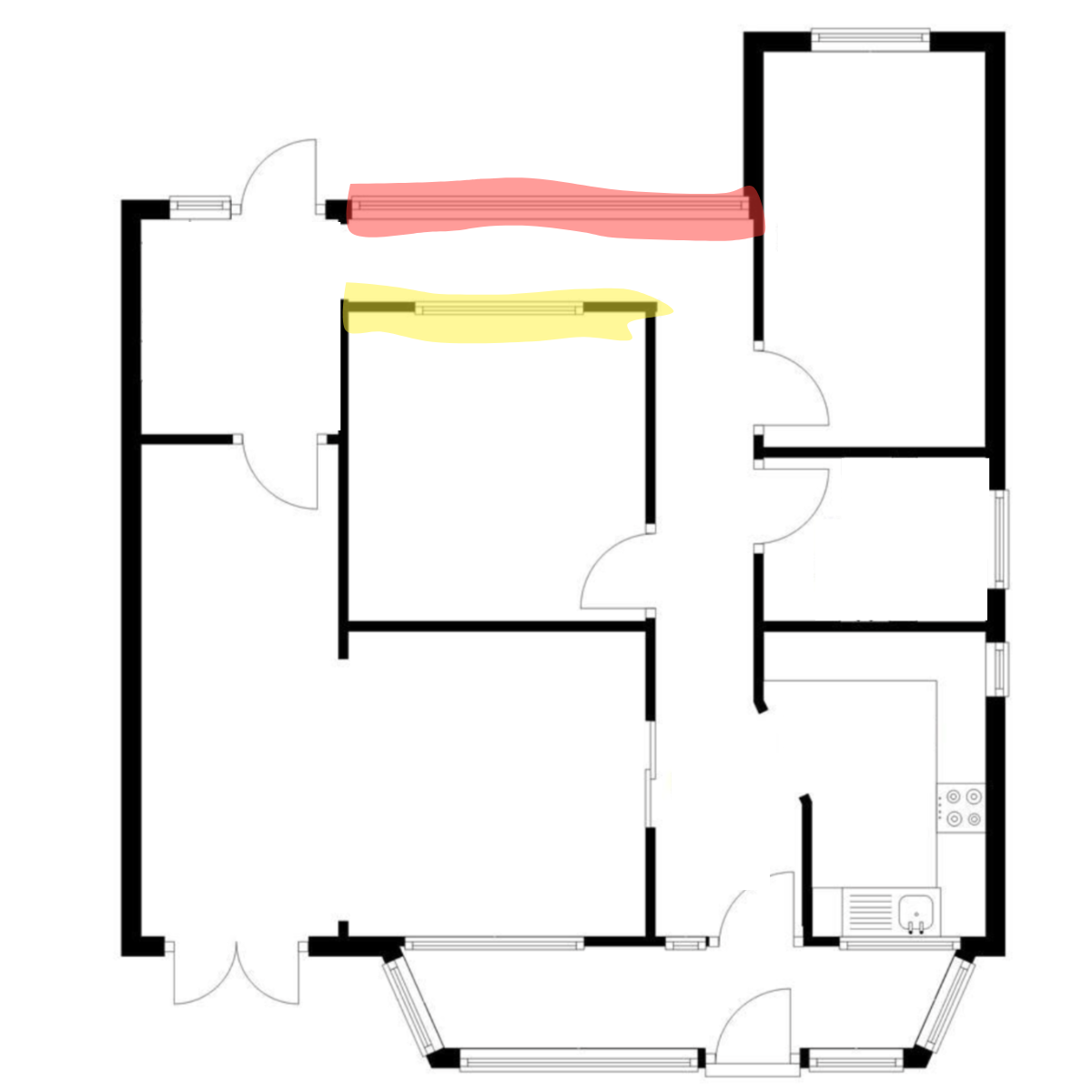

I’m wondering if someone can help clear up a bit of confusion. We're considering buying this 1960s bungalow, but it's got a strange quirk going on with internal windows caused by a corridor running along the back of the house (see diagram).
I'm trying to work out whether the red or yellow highlighted wall is holding the roof up (or a combination of both?). Our initial intention was to take down the internal wall/windows and extend the walls on either side to meet the outer (red highlighted) wall. That would make a little more bedroom space and lose the strange corridor feature.
However, we've got the title plan, and it's got a dotted line where the red highlighted wall on the diagram is now, indicating that this might have only been an overhang/lean-to structure, which calls into question its strength to support the roof - I think? But, I see there's a large wooden fascia above the windows on the rear wall, so could that be covering an RSJ that's providing enough support to hold the roof up without the internal wall doing anything?
I think it's worth noting that without the rear corridor, the roof would either end strangely high or be pitched irregularly and very steep at the rear of the house, so surely the outer wall is taking the weight?
Can anyone advise based on what I've provided whether or not the outer or internal wall is likely to be load bearing?
Grateful for any advice!!! You might be able to tell that I know very little! Thanks in advance!
That has had a wrap around single storey extension.  So the Yellow wall is the original back wall and is holding up the original pitched tiled roof and the red wall is holding up the flat roof to the extension.
You could take out the yellow wall, but not before organising some form of lintel to bridge the gap where you are removing the wall to keep the original roof up.

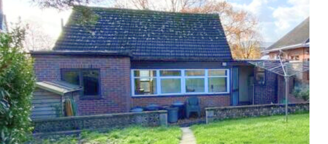

Thanks for the reply. I’d completely agree except for the fact the red wall is where the pitched roof comes down, not the yellow. It’s not a flat roof out to the edge of the red roof (unlike the extension to the left and right which clearly have a flat roof). This is why it’s so confusing. There’s also a slight discolouration of the pitched roof when it reaches the yellow wall and stretches down to the red, so I’m not too sure what’s going on there.

More pictures needed of that rear elevation from a side view or partial side view.

To my untrained eye I would say it has front and rear add on extensions with the existing sloped roof added on and continued down.  So I still think the yellow wall in your sketch is the original wall where the roof finished before it was extended.
You should be able to sell by the thickness of that wall inside the house.  I bet it is a thick double skin wall showing it was once the outside wall.
That was my initial thought, but for that to be true, I think it would mean the entire roof must have been replaced at some point since the pitch is regular on both front and back. Which I guess means its truly impossible to say without looking in the loft where the weight is likely to be borne?

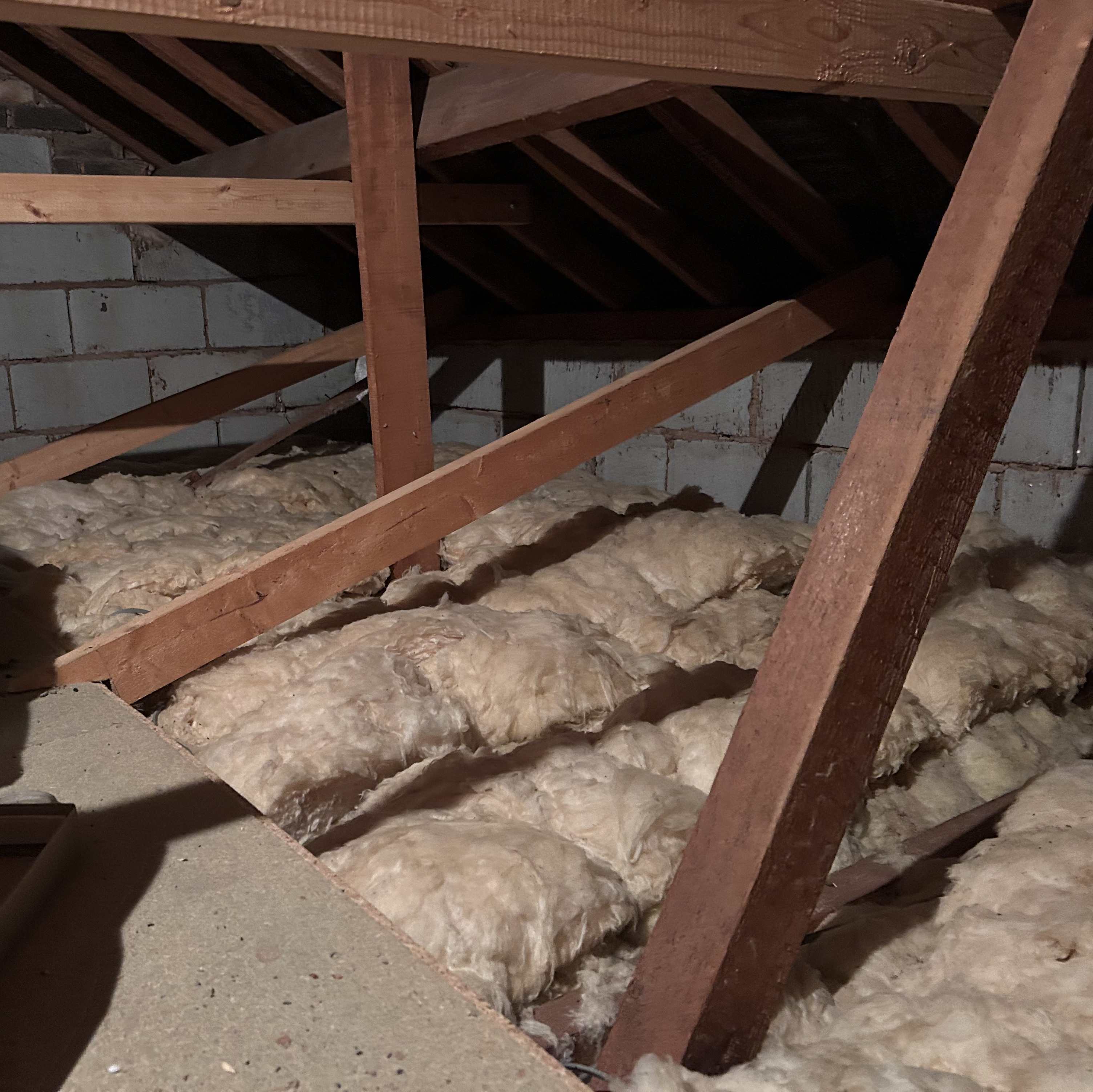

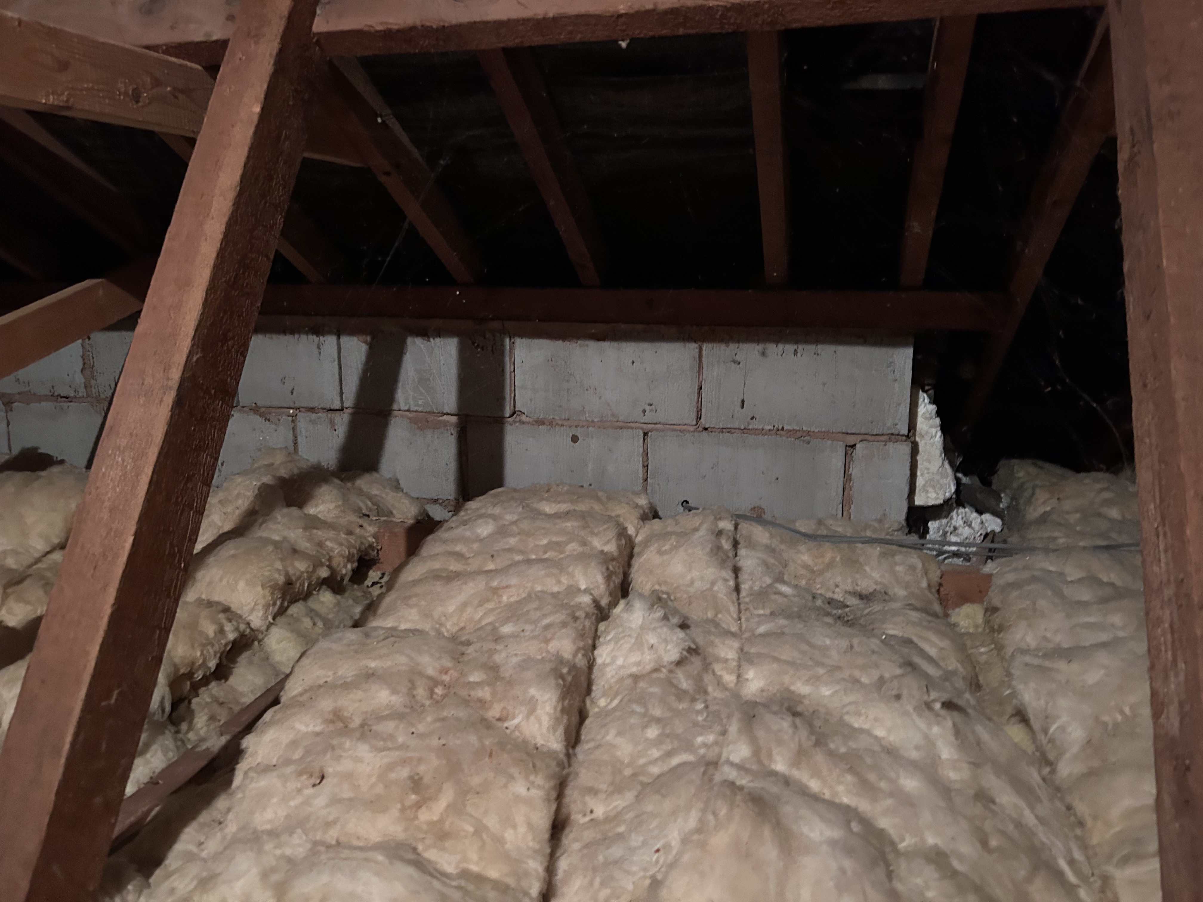

Things have moved VERY slowly, but these are a couple of pictures I managed to take yesterday in the loft during a visit. It definitely appears to be supporting the roof structure. I guess, the approach would be to get an RSJ along that length provided we can get padstones on some piers to support it? Anything else I'm missing?

But it's not supporting all of it, there is a gap not supported by this wall yet managing to stay up.  What was further to the right in that shot?

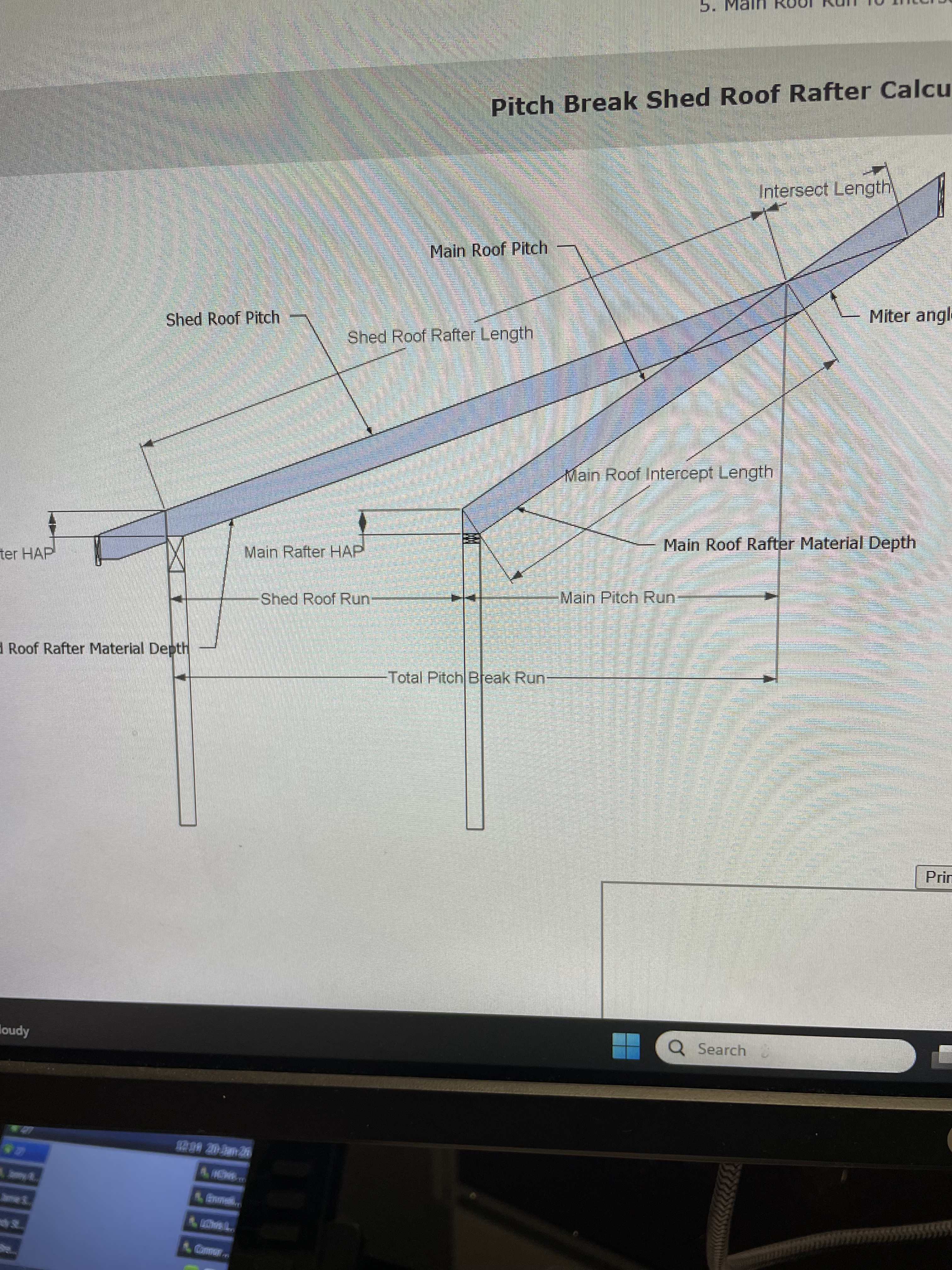

Looks to me like you’re looking at the bottom of the original roof, and there’s a roof pitch change for the extra corridor part.
Could this be the answer?
Correct! To the right of this is another bedroom, which is part original and part extension (it's the most north easterly room on the diagram in my original post). From being in that room, I suspect it's being supported just slightly north of the door by an RSJ or other beam. I basically want to achieve that for the entire wall.
I know that a second roof - or roof extension - was added like your diagram suggests, but they've maintained the pitch exactly it seems. This covers the corridor to the north of the building in the first diagram.
Thanks to you both for coming back to me on this. I guess my question now is about the feasibility of getting that roof supported by an RSJ and getting the rest of the wall out.
