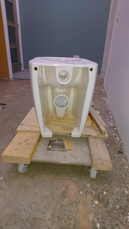

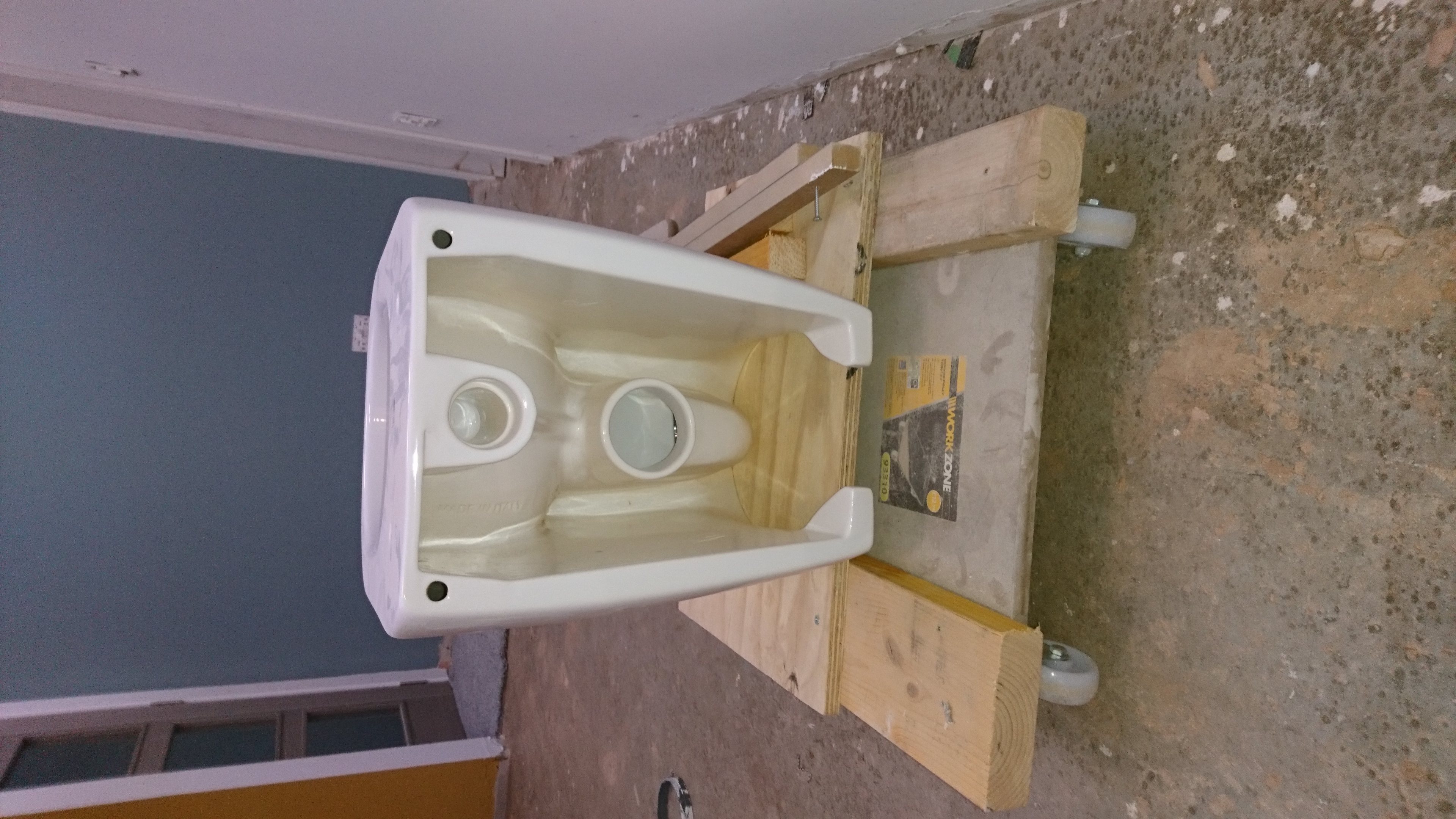

jamiehamy Posted January 18, 2018 Posted January 18, 2018 I bought two trolleys from Aldi and just screw on osb to suit what I'm carrying. Although that's only for inside. They have carried our 200kg bath without a grumble and probably more in tiles. My friends kids loved racing them when their dad borrowed it...! Used them for Windows too, a godsend!
