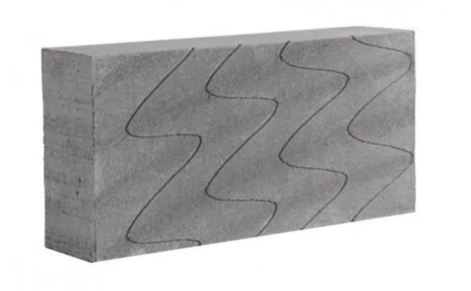

ADLIan Posted 3 hours ago Posted 3 hours ago Aircrete blocks in external walls to help achieve Uvalue. Check construction, insulation and required Uvalue. Cheap & cheerful standard concrete block for inner walls, density helps with acoustics.
Super_Paulie Posted 1 hour ago Posted 1 hour ago I use air blocks or thermalites when I build most internal walls. Easier to manage, weigh next to nothing, can be cut with a saw. Added bonus of increased insulation values, what's not to like.
