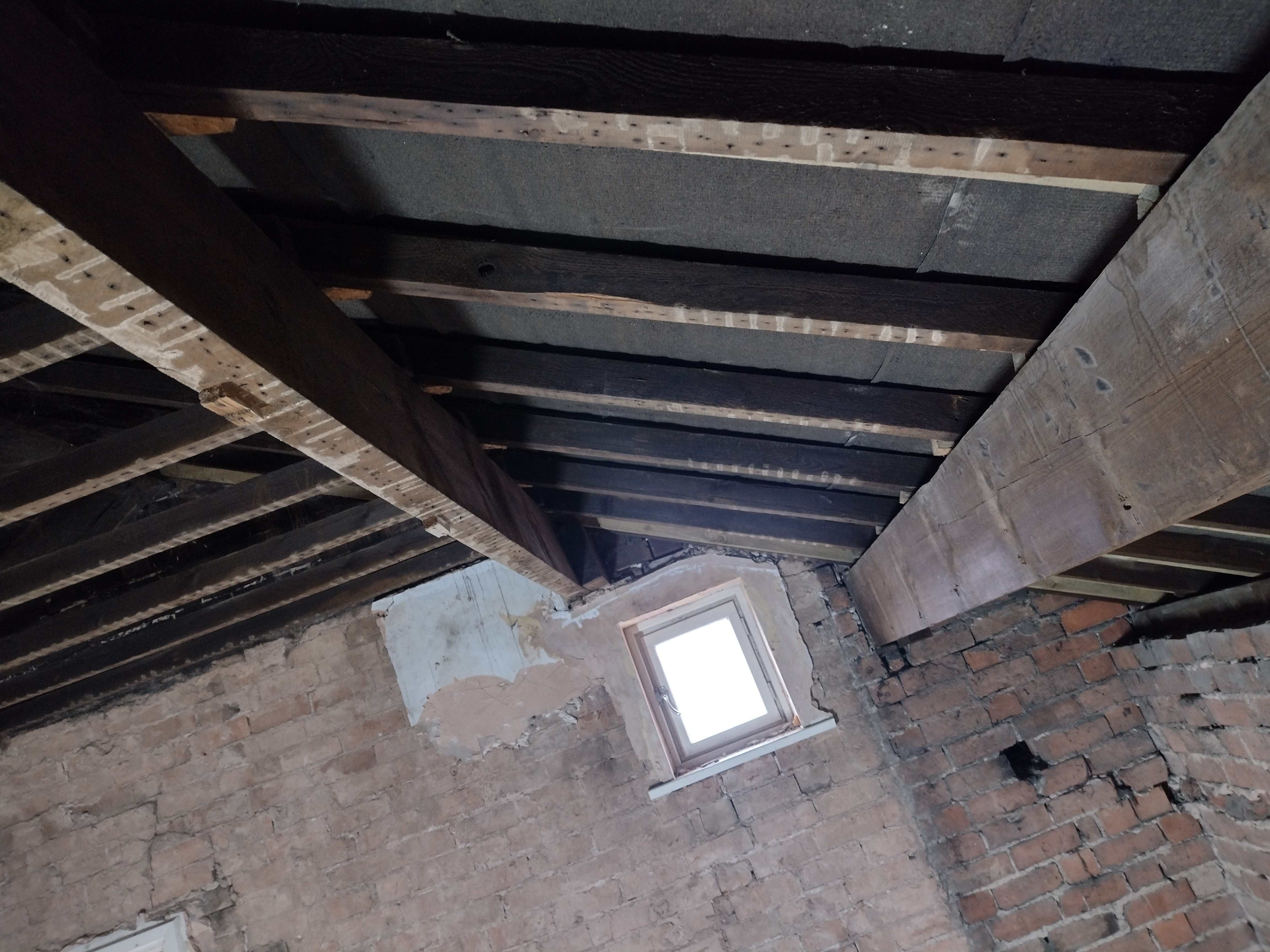

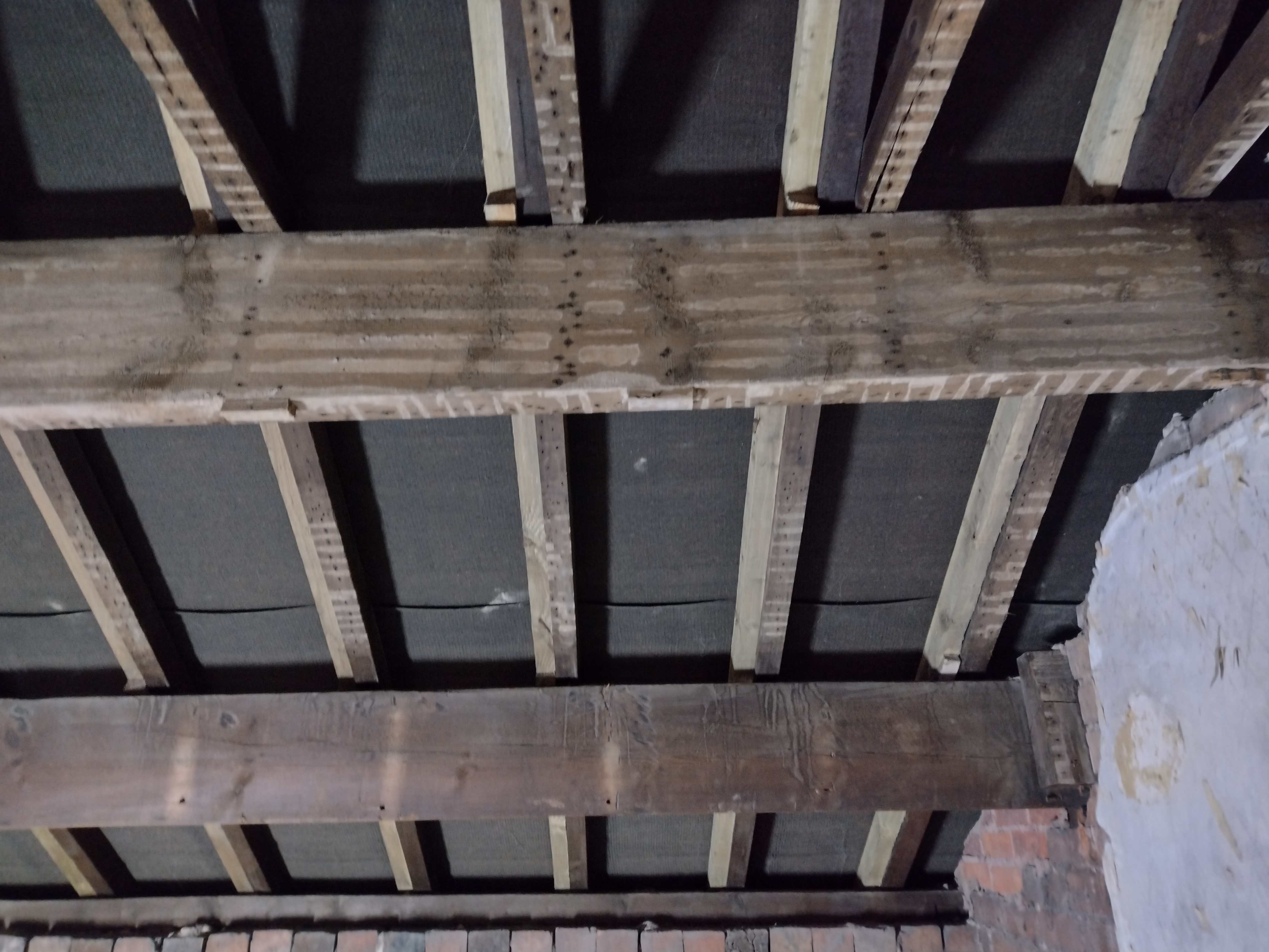

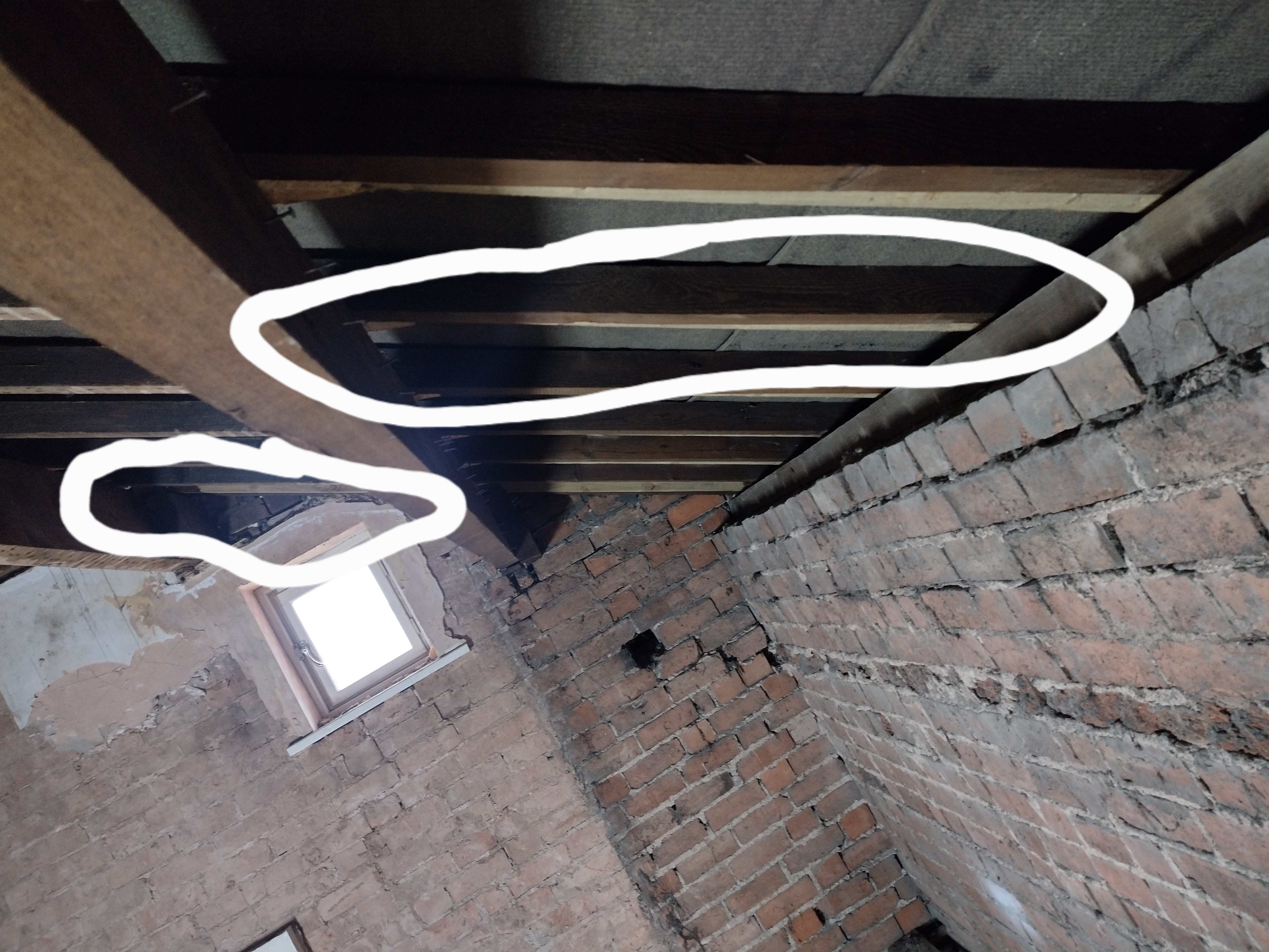

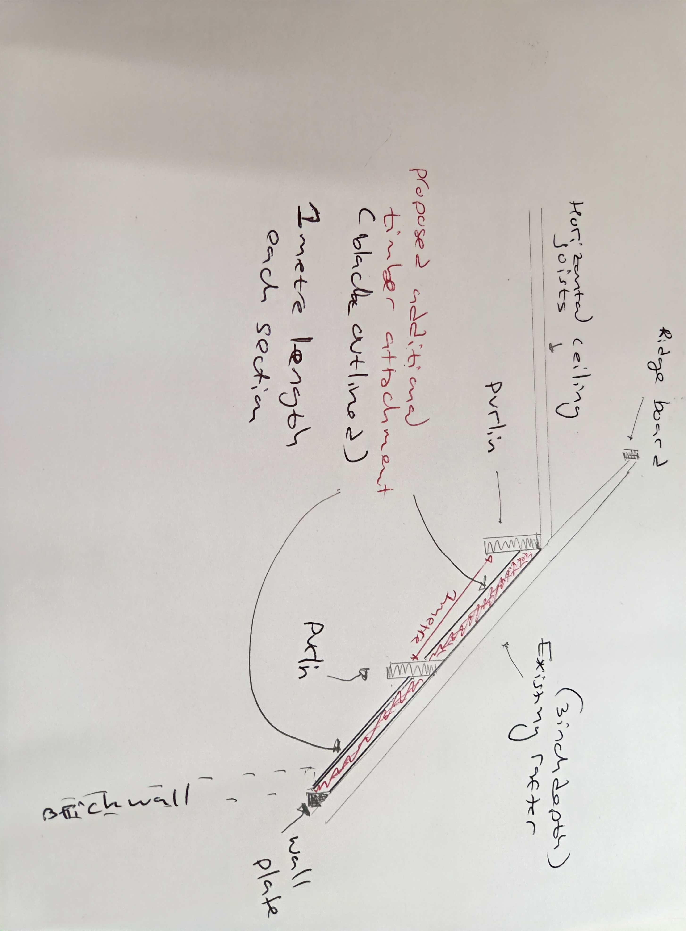

Thank you all for the replies
I've attached pictures of the proposed rafter depth for extension.
Essentially extension will comprise two lengths of 1 metre timber attachments to the rafters and will be separated by purlin (photo shows proposed location for the timber attachments as white ellipses)
a) 1st segment will run from the brick wall/wall plate to the 1st purlin
b) 2nd segment will run from 1st purlin to 2nd purlin
Old rafters have been sistererd/doubled with adjacently placed  new rafters as shown in the photo (old dark brown, new light brown). Now I'm unsure where to attach the extra timber for  depth extensions to the old rafters or the the new sister rafters.
I want to extend the timber depth as much as practicably possibly but would be happy with even say an extra 10cm depth,  current old rafters are about 7 cm in depth giving me space of 17 cm which will be insulated minus 2.5 cm allowance of gap between the insulation and breathable membrane.
Currently there are about 10 sistered rafters and the widht of cavity space for insulation is going to be about 45cm and there will be about 9 cavity spaces to fill up
Rest of room has essentialy horizontal ceiling and this section of the room will be insulated between and above joists quite easily.

I'm looking at this and thinking if it would it be too simple to just forget the rafter extensions, insulate with PIR Board under the rafters then screw 3*1 or 4*1 timber through to the rafters above to accept plasterboard?

That's basically what I was suggesting, and how I built my own house. Except I used 2x1 battens on top of the PIR. Make sure you mark the line of the rafters before you cover them up.
