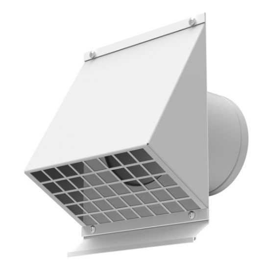

Tom Posted November 17, 2025 Posted November 17, 2025 The C02 levels seemed to be creeping up in the bedroom for the last week, so I checked the filters on the MVHR and the inlet one was absolutely caked in crap, including lots of quite large insects. This prompted me to take a closer look at the external inlet and it seems it has a 10mm mesh covering it. Is this a bit coarse? I don't want to have to be clearing the mesh every two minutes, but then again it seems like at 10mm it lets pretty much everything through...
Russdl Posted November 17, 2025 Posted November 17, 2025 If you make the external mesh size much smaller it’ll be that which is bunged up in no time. You have to decide which filter you want to give the most regular attention to. Personally I knocked up a pre filter to sit between the two, and now, on the Mk2, it’s all going very well - but it does need frequent cleaning, pretty much every 3 months.
JohnMo Posted November 18, 2025 Posted November 18, 2025 10 hours ago, Tom said: inlet one was absolutely caked in crap, including lots of quite large insects How often do you inspect - if it's that bad, maybe up the inspection and replace frequency? Small mesh can equal frozen inlet in winter or an issue you need a ladder or scaffolding to fix
mike2016 Posted November 18, 2025 Posted November 18, 2025 My intake is metal but has big enough holes My supplier recommended against any insect screen to prioritize air flow. Stops the fan demanding more power and providing less air to the house due to the blockage that can build up. Will need to clean the intake duct every few years. The insect screen will not filter dust, just insects. Depends where you live I guess, risk of bee hives? Not heard of any.....
Mike Posted November 18, 2025 Posted November 18, 2025 My Zehnder intake is around 10mm too - enough to stop leaves, bats & birds. I then have a filter box before the MVHR unit, with a large filter that can easily be changed, before the MVHR filter takes out anything that remains.

Tom Posted November 18, 2025 Author Posted November 18, 2025 Thanks all. Seems like 10mm pretty standard for the external intake. I'll just have to change the MVHR filter more often, to that end have bought a 5m roll of filter wool
Nick Laslett Posted November 18, 2025 Posted November 18, 2025 Earlier thread on same topic, which didn’t really reach any conclusions. 5mm mesh seems like a better size, but if Zehnder and Lindab both use 10mm, there must be a good reason. Some expensive options from this company. https://www.expandedmetalcompany.com/applications/filtration/air-filtration
