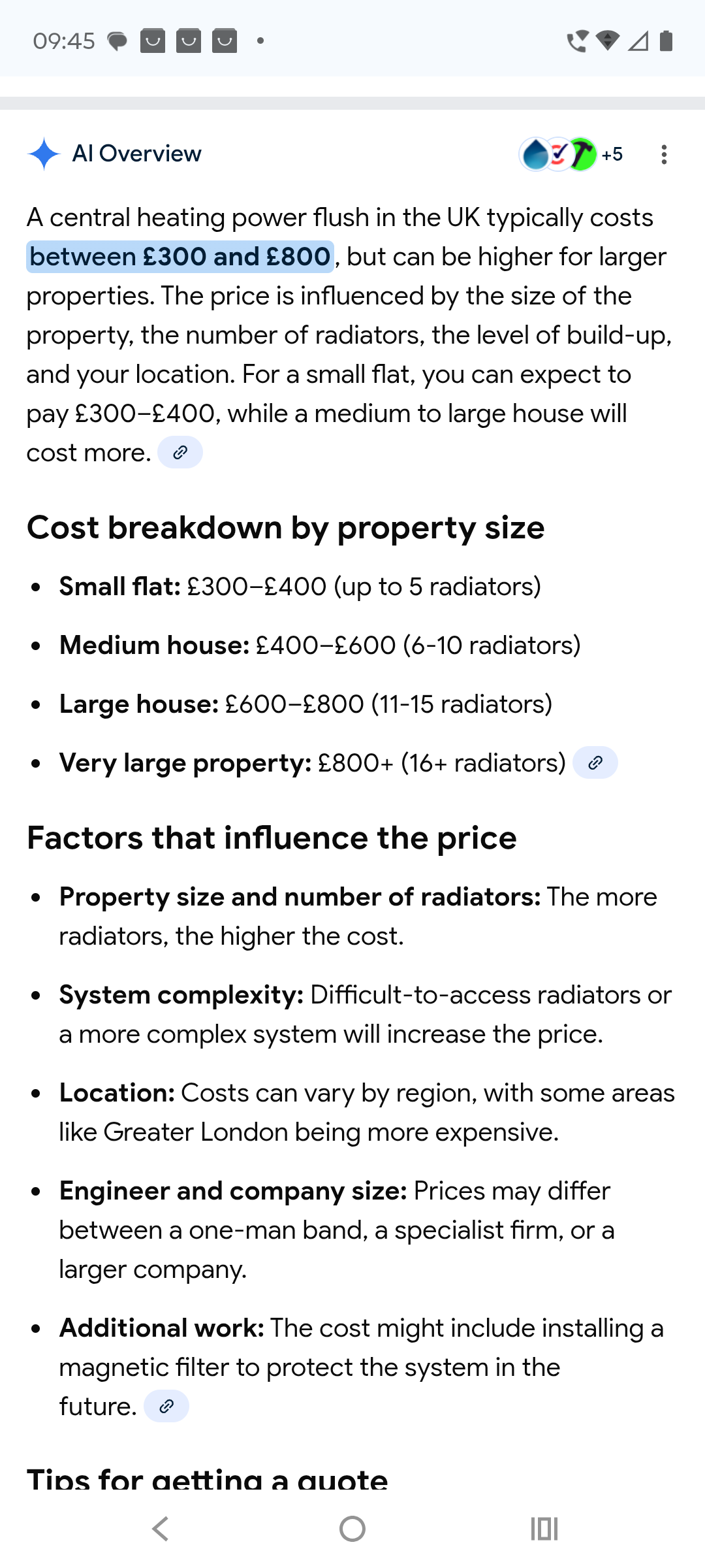

Dee Posted November 17, 2025 Posted November 17, 2025 (edited) Estimated cost to power flush of 19 rads? In Suffolk? Edited November 17, 2025 by Dee

marshian Posted November 18, 2025 Posted November 18, 2025 17 minutes ago, Dee said: The boiler is 2 yrs old. Only drained fown once in 20yrs. The last rad I took of was very black so just assumed a good flush would eliminate one less question mark...? One rad is very temperamental. I'm genuinely too scared to run the heating too long to rebalance due to cost.! cost of a power flush buys a lot of gas at 6p per kWh - if a power flush us lets say £500 you’d be better of using it to purchase 8500 kWh of gas - that’ll more than cover most of the winter needs.   1

Andeh Posted December 13, 2025 Posted December 13, 2025 MIL had a boiler pack up on her, 10 year old boiler. Blocked heat exchanger, likely caused by British gas not doing a power flush when they replaced it  She paid £3000 for a new boiler and full power flush, from a local chap, last week... Must be an easy 25+ rads in her house.  Prob £500-800 I'd guess for the flush?  Made a massive difference to the heating of the property.Â
