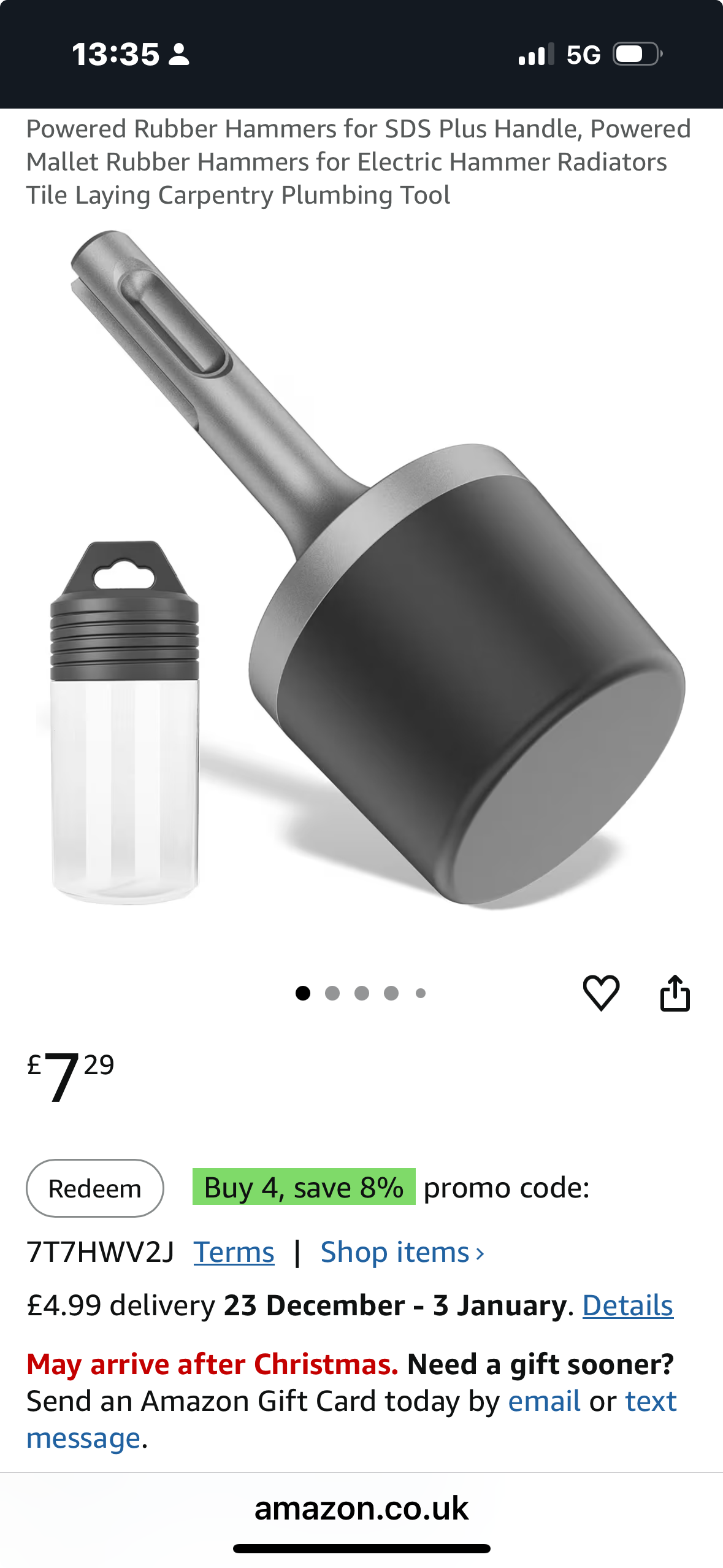

There is an interesting gadget available….
which you use to rattle the shit out of the rads during the flushing process, particularly where the valves connect.
I’ve decided to dodge this method as tbh most of the much older rads would probably piss themselves on the spot if you actually decided to go with this “initiative”.
