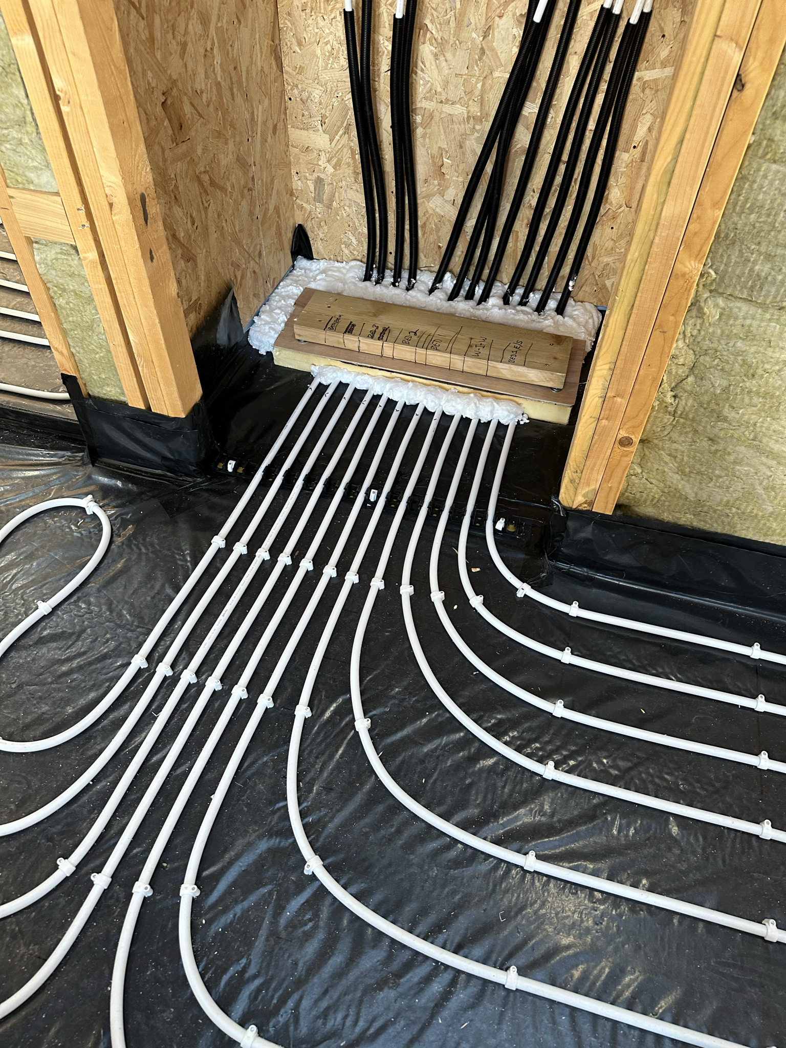

Egg shells plus screed works. Do 16mm Pert-al-Pert tube.  Insulated below at a higher thermal resistance to what ever is above the floor to ensure heat moves upwards not downwards.

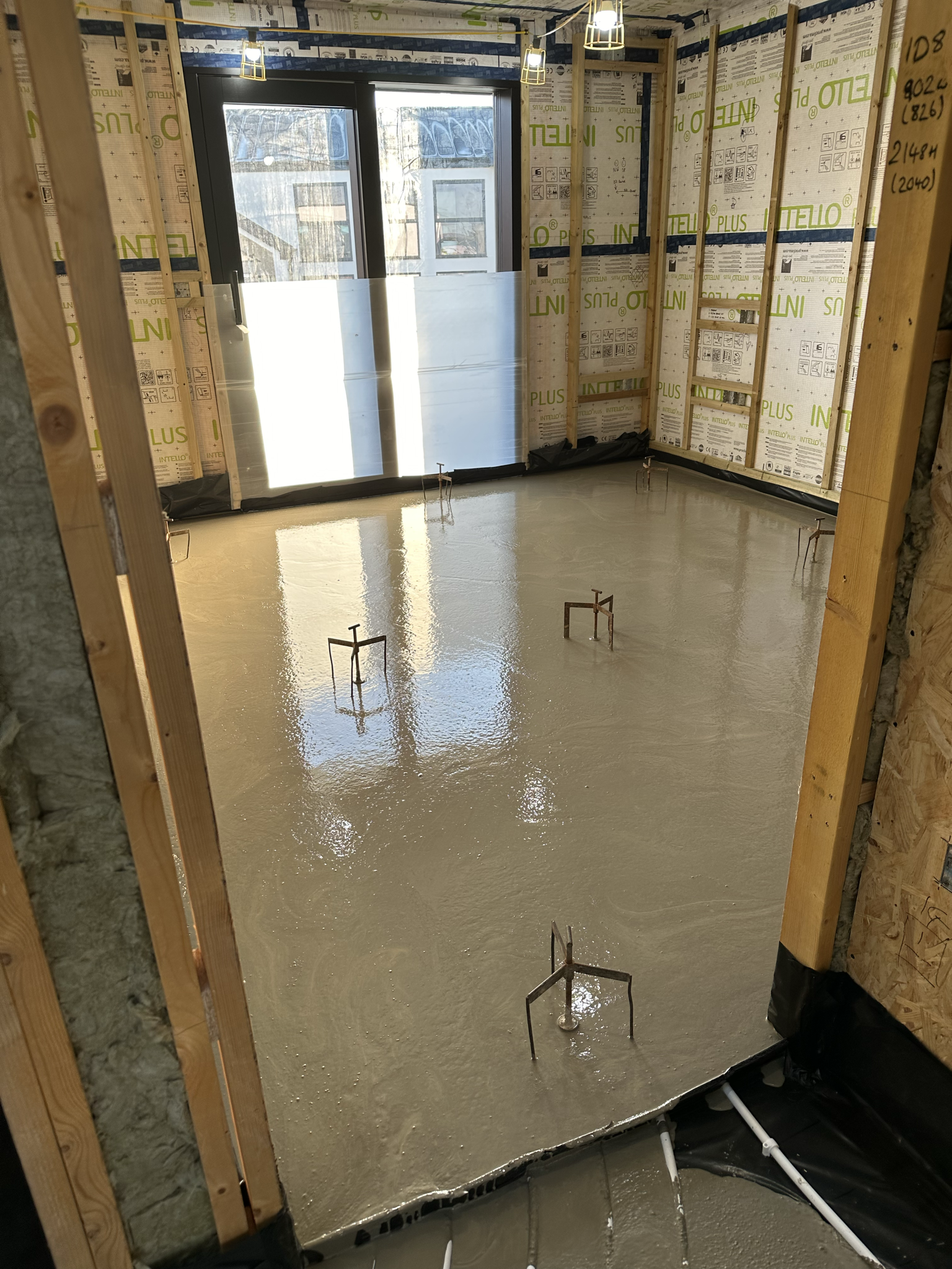

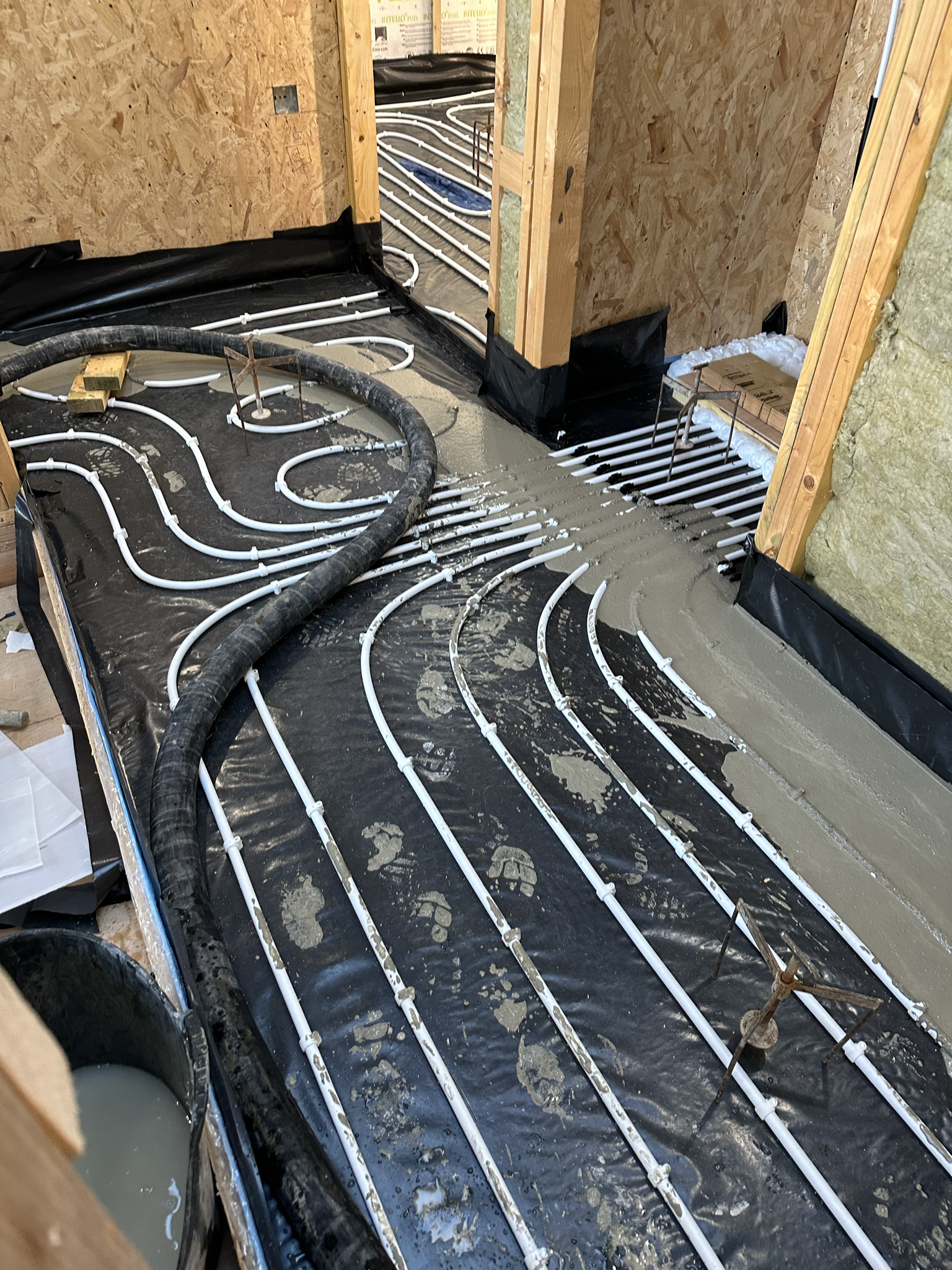

I’m going round in circles also 🤣if we did ufh on first floor what would be the minimum screed depth on top of 15mm castle matts . Think it might be easier with rads (more controllable
Why are you wasting room with mats when you can just clip directly to the P5 deck (floorboards)?
Not sure, why do people use mats ?
Mats look good for upstairs, pinned onto board decking and providing sound insulation.
But at £10/m2 it's pointless on the ground floor .. except for discipline on the layout. I've forgotten who posted the other day, the very rough layout.
