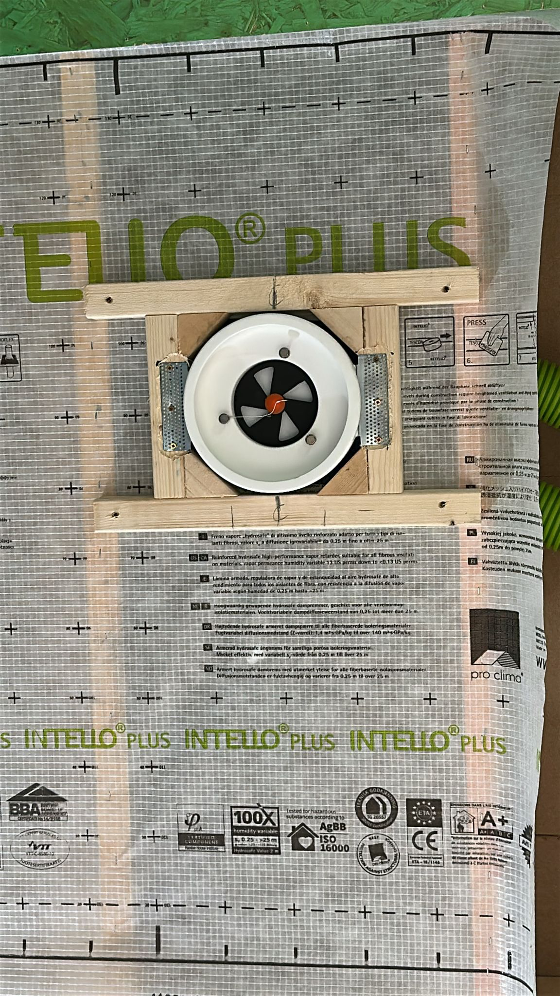

I’ve fitted 4 Ergovent units for my current client, and I think they look the dachshunds danglers. We’ve looked at some slightly nicer ones (than the petrol station toilet ones that come as a knee jerk 🤢🤮👎) for the less frequented rooms.
For bed 1, and the 3 in the open plan liv / dine / kitchen area, with nice new vaulted ceilings, I suggested we go for less conspicuous plaster-in units so the ceilings could lend themselves to lighting and have fewer wall (ceiling) warts to detract from that.
Pradovent trimless, slightly more expensive, but look a bit more forgiving for installation.  My plenums we installed a bit tight to joists so the ergovent became too much of a challenge, so I’m going to give the Pradovent a shot.

Gee £75 each - my coanda nozzles, got 6 off them, they are Zehnder Circular Coanda Dia 90 mm, White, £8 each, the adjusters are another £18 each if you need them, I needed 2x. Plus I didn't need 6x 125mm nozzle adapters and they reduced duct lengths by over 20m.

Plenty of options out there, these are what I suggested to the client for this particular project as they are far less conspicuous and the lighting plan doesn’t need anything competing with it for ceiling space / flow.
£75 isn’t much money, and I only suggested these where they’re in the ‘eye line’.
