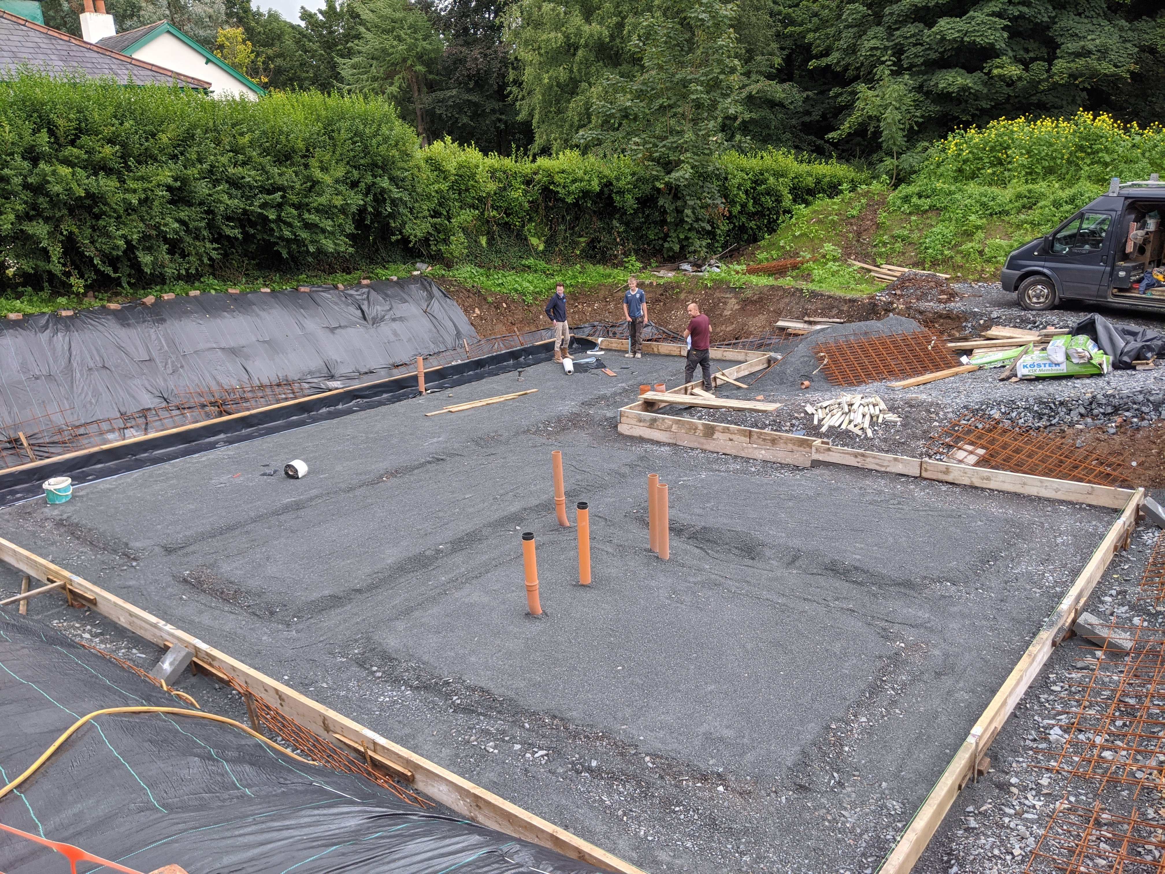

Conor Posted October 31, 2025 Posted October 31, 2025 That's what we did. Ground bearing raft. Where there were internal walls, the concrete was thicker with an extra layer of mesh. Walls were built off the slab. We also and compacted the Type 3, then the digger driver scraped out the areas for the walls, compacted, then blinding layer. Essentially extending the ringbeam internally. 1
Conor Posted October 31, 2025 Posted October 31, 2025 (edited) Before it was finished, but you get the idea. Our reason for doing this was because it's a basement, we'd already dug out 400tonnes of earth and didn't want more coming from trenches. Edited October 31, 2025 by Conor 1

Conor Posted October 31, 2025 Posted October 31, 2025 (edited) 2 minutes ago, -rick- said: How did you handle floor insulation? 200mm insulation then liquid screed. So fairly typical except for ring beams instead of trenches, as we were already down into firm ground. External walls were ICF with tanking. We originally had it designed as an insulated raft, but SE couldn't get it to work. Edited October 31, 2025 by Conor 1
