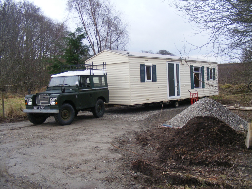

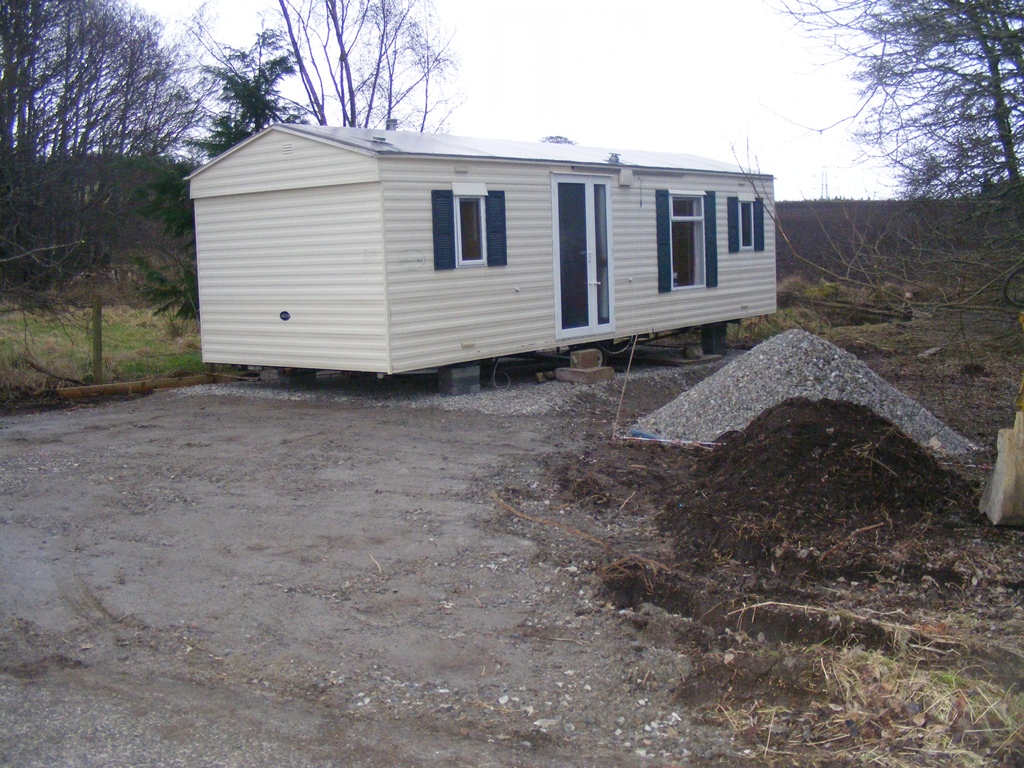

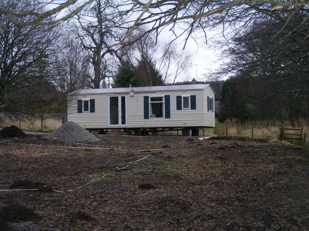

Here is what I did:
some basic points.  It will weigh something like 3 tons.  So you need a good stable jack, I used a 2 ton trolley jack, much more stable than a bottle jack.
They don't have brakes on the wheels, so nothing to stop them moving. To prevent mine having any notions of going anywhere while I was under it jacking, I kept the tow hitch attached to my Landrover.
For support I used ordinary 100mm concrete blocks on their sides.  You will also need plenty of small pieces of assorted thickness bits of wood for the final packing to get the heights right.
Start by levelling the axle.  Jack up one side and pack it with blocks then the other side.  You need to get the axle level side to side as your starting point.  I just used an ordinary spirit level on the floor of the 'van. These first supports only need to be high enough to just get both wheels off the ground.
Once the axle is level and the wheels are off the ground it won't go anywhere so uncouple from your car that was acting as an anchor.  Now use the jockey wheel to get the 'van level front to back.
Then it is a case of blocking and levelling each jacking point.  Starting with the ones at the extreme ends and then all the ones in between.  I think I ended up with 12 piles of blocks and timber supporting mine.
caravan_6.thumb.jpg.9cf3b1481048bffd93a5384f6b76c186.jpgcaravan_8.thumb.jpg.99118a71dc9c6e7feedf580ca9040a0f.jpgcaravan_7.thumb.jpg.c02b298f432b0f25da07f6955c914a5f.jpg

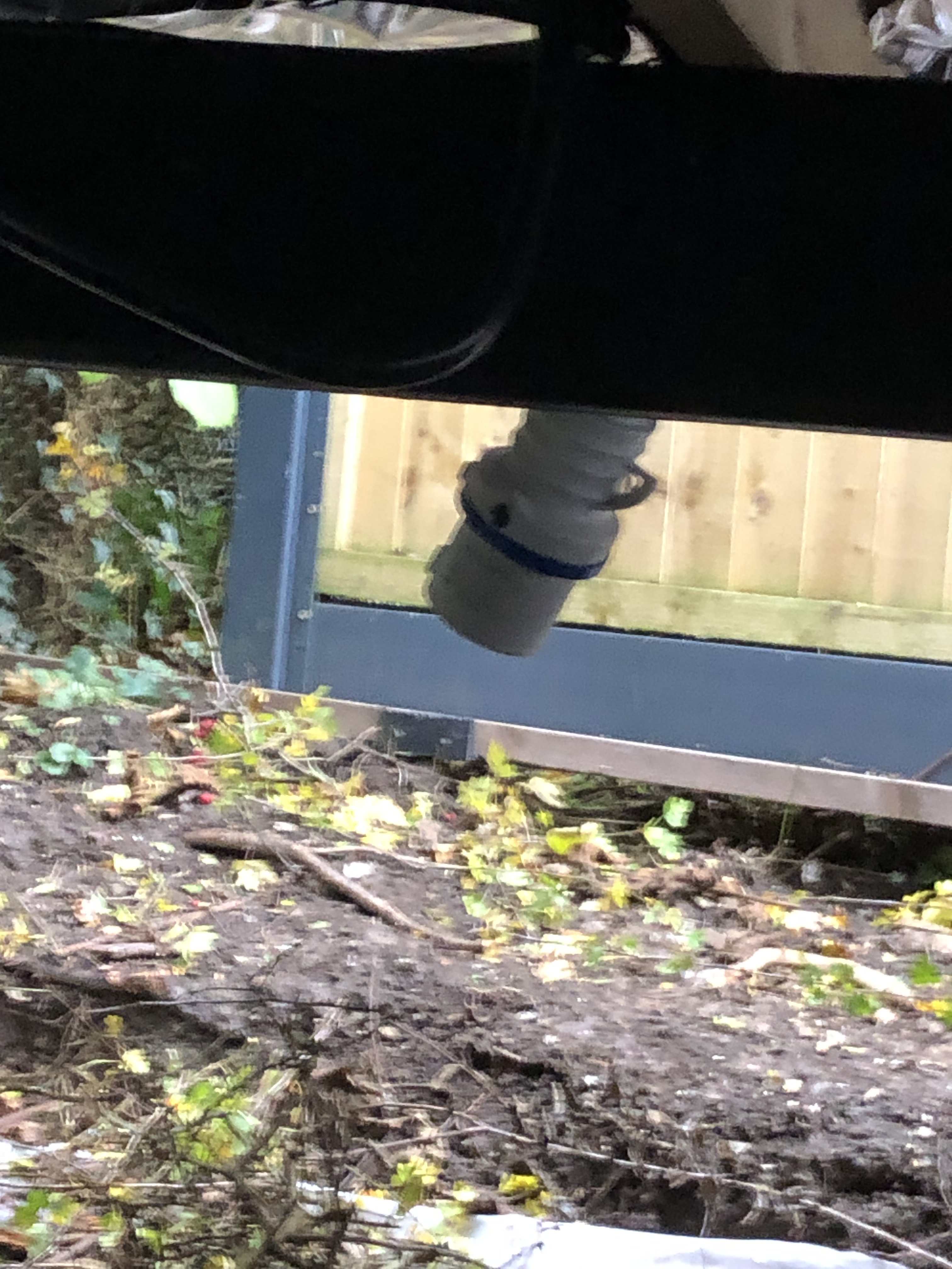

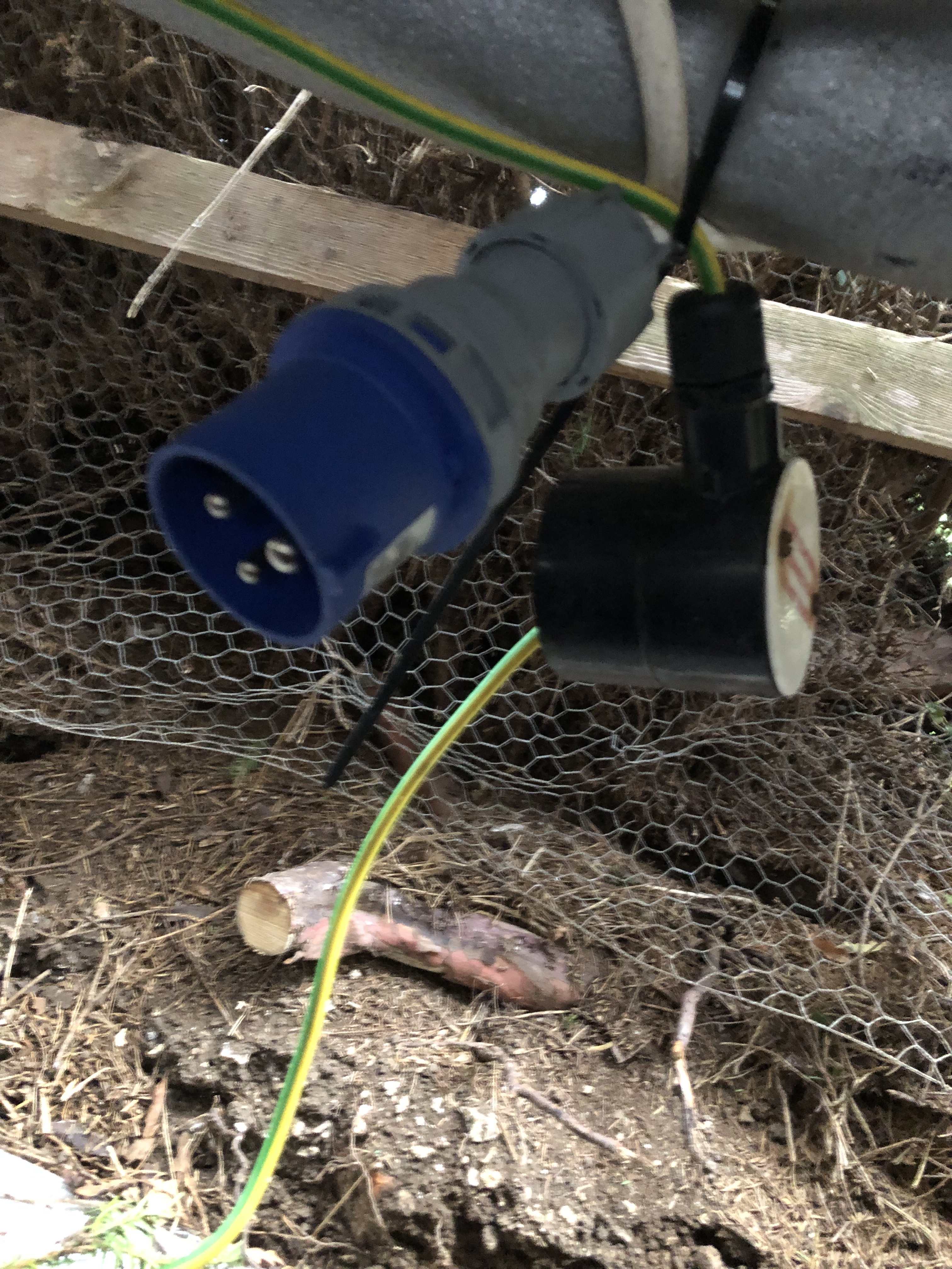

Whilst on the subject, I am trying to understand why there are two electric connections under the unit.  The big one in the first image is definitely for the incoming feed as it goes to the consumer unit.
I’ve no idea about the other one though?

Yes wiring regs dictate you should not connect a caravan to a TNCS / PME earth system, they should be connected to a TT earth which in simple language means it's own earth rod.
The black thing on the wire is a cover to protect the electrical connection clamp at the top of the earth rod.
Posted
14 hours ago, flanagaj said:
I get the black plastic thing is for the earth rod, but what about the plug next to it?
It probably came from a holiday site where they expect a relatively regular turnover of 'vans and they plug the mains into a socket like touring caravans do.
Just ignore it for now.  Most likely your electrician will connect the cable direct to the consumer unit in the 'van but he could also just fit a matching socket and just plug that plug into it.
