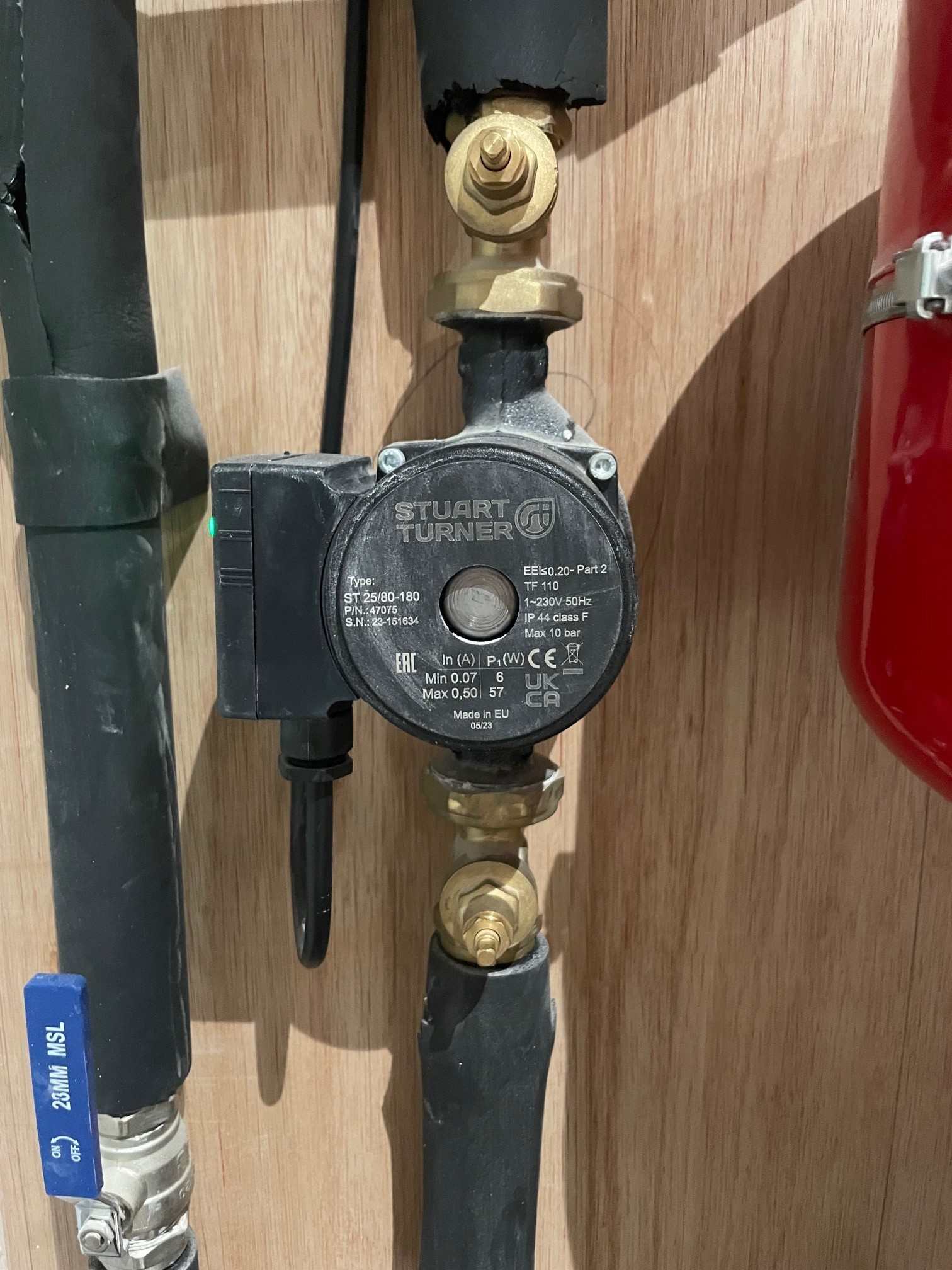

Do you have multiple pumps in the system or just one?

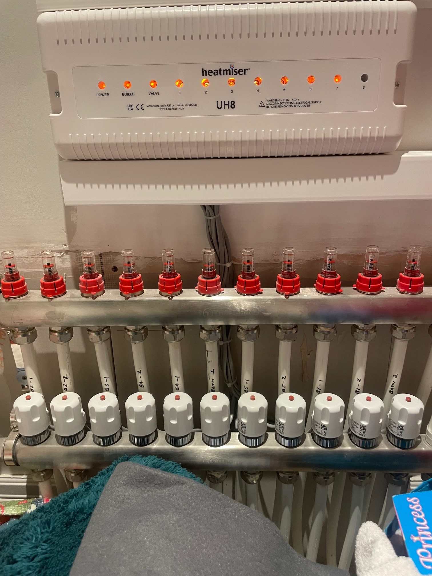

There is 2 manifolds, one upstairs and one downstairs.
There is just 1 pump that is common to both (see attached)
Yes all loops have individual loop actuators

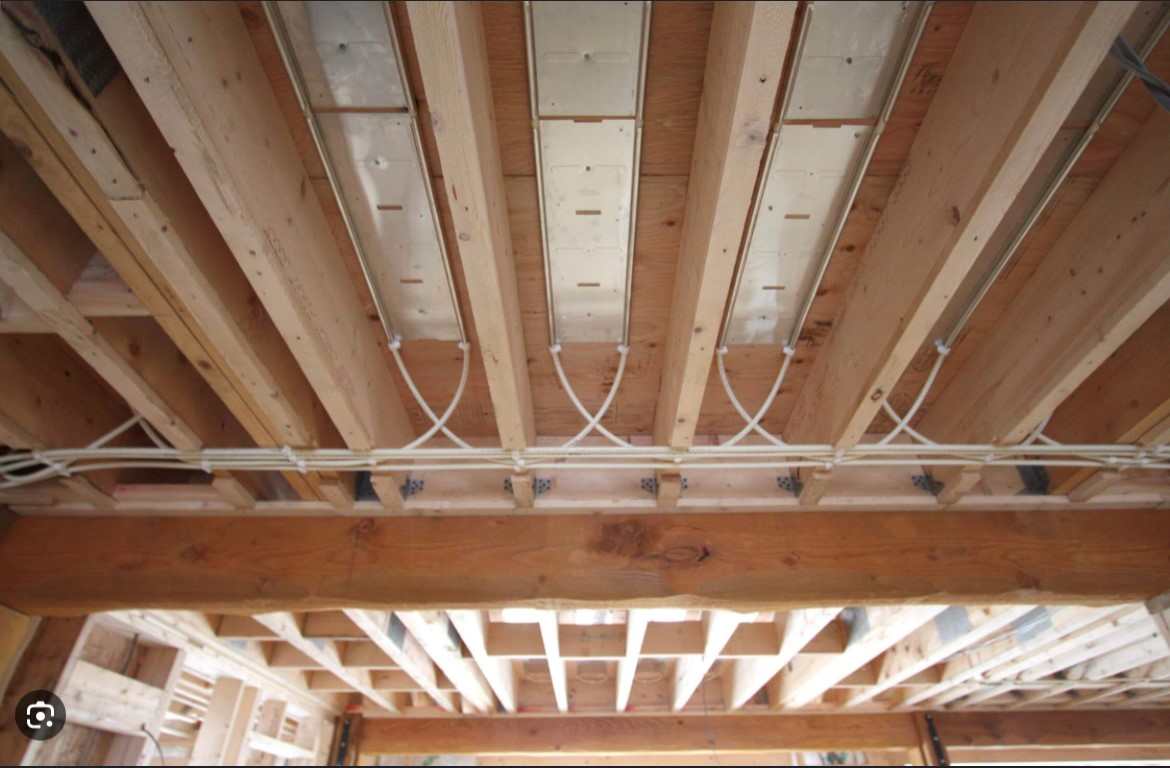

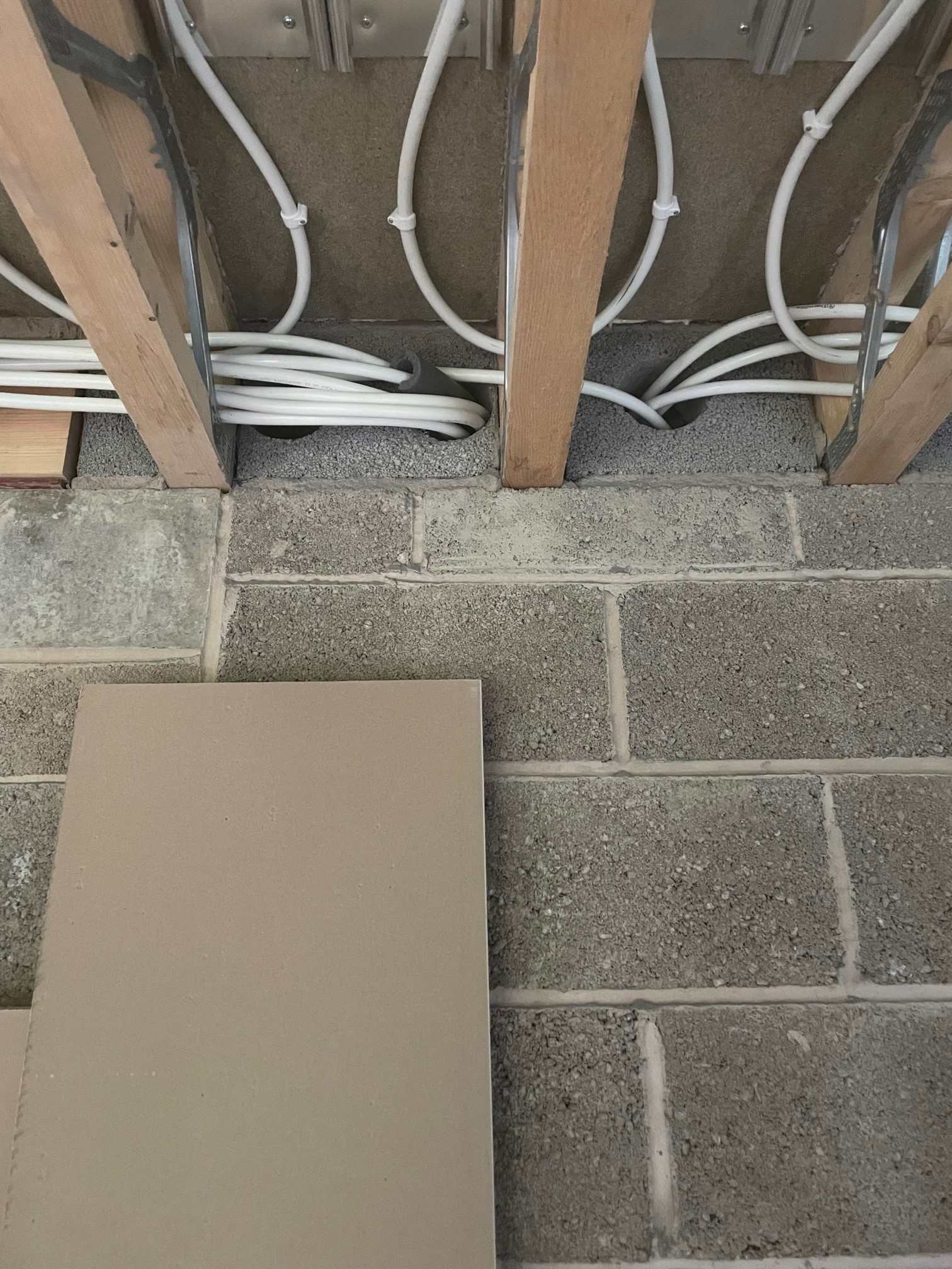

Your pic shows a rather poor connection between the pipes and the floor above, at least in the bits we can see - air is a reasonable insulator so as things stand you are not getting the heat from the pipe into the floor very well, can you still access it or are you beyond that stage already?
Going forward there are perhaps two approaches.
  1. Try to stop all flow in the downstairs and then experiment with the upstairs manifold flow rates and the water temperature  (+delta T) to see if the upstairs system can be adjusted to cope without the downstairs in circuit. (Keep notes of the present settings so you can return to them at any point.) If it can't then you may need to fall back on making the downstairs do all the work.
  2. Do the heat calcs - how much heat you need out of each zone for the length & diameter of pipe, coupling losses, area of the zone etc. Then adjust the flow rate settings in the controller for each zone and see what happens.
I get the sense from your original post that the bathroom is your principle concern so maybe just run / play with that loop. Get a gun type thermometer to measure the temperatures everywhere (pipes, floors etc).
That was the only picture i had of the pipes i could find, the pipes are securely fixed in metal spreader like the pic attached (just an example of how mine is) and yes way passed the stage of accessing them unfortunately
I have tired to unscrew the flow controllers on the manifold and it didnt seem to make much difference ( i even unscrewed it too far and it came off...much to the amusement of the wife while water was spurting out!) I have attached the picture of the manifold with the current flow rates

If you have a mismatch in floor output the simple first step is to reduce output from downstairs and/or increase upstairs.
If downstairs gets too hot decrease output, by knocking off 0.5L/min off each room loop that gets too hot. Get downstairs to have a stable temperature before messing with upstairs. You may need to revisit this a few times over a few days.
Then increase output from upstairs, go to manifold increase each loop flow by 0.5L/min.
Leave for 24 to 48hrs between adjustments to see what happens. You need to ensure any thermostats are set to not influence anything while you set things up.

Oh lord.
This is NOT a great way to install UFH….
They should have notched the tops of the joists, not dropped down and under! These are now all significant air traps, and as the water flows so very slowly any trapped air cannot escape by being pushed through by the pump.
Did you witness the installer purging every single run one by one, with cold mains pressure to evacuate the air and ensure each loop was completely populated with water?
This needs to have been done religiously.

Hi John
These seems interesting i will try this, by decreasing the flow downstairs will that automatically send more heat upstairs (apologies for the very daft question)
I wanted to run it constantly off the weather compensation curve but the GF was getting too hot so put a limiting temp in the thermostats (23.5). I didn't want to knock the weather comp temp down as in my head it would only decrease the temp upstairs further

5 minutes ago, Nickfromwales said:
Oh lord.
This is not my install BTW, i have posi joists. Which were lots of fun threading all the pipe through!
Installed the pipes but the guy setting it up filled them with water...he did say they filled up nice and easily with water
Is this something i can do now just to ensure its ok?

What this will do, is give 100% pump potential to the FF manifold, which is what we need for a practical test run.

Sorry, that doesn’t answer my question. The loops need to be purged one by one with cold mains. If this didn’t happen then it needs to, if you’re looking to eliminate every possible reason why this isn’t working properly.
My immediate gut feeling is that you should defo have had 2x manifolds, each with their own pumps, and each with a TMV; this would allow a higher flow temp to the FF UFH and for the GF to be dialled back accordingly.
You have 2 very different emitters here, BUT, if well insulated/airtight/MVHR then the requisite heat for the FF should be minimal.
I’m glad, as the install in the pic is 🐕 💩.
